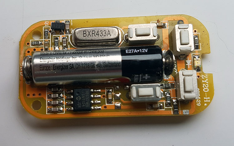

    The originals are probably with variable code. Then they cannot be copied.

    If the problem is a variable code, then yes, a newly "taught" pilot should once work, although a few conditions must be met:
    1) the learning process must be carried out outside the range of the receiver
    2) The "taught" remote control must be tested before using the "teacher" remote control again.
    Check it, if it works exactly once, then you are clear - a remote control with a variable code, no universal one will replace it.

    Today, I had some time to take apart the old remote control and take a photo. I see that it has the HCS301 chip...
    Troubleshooting Self-Copying Gate Remote Controls That Won't Sync
    From what I checked on the Internet, I have no chance of copying this remote control.
