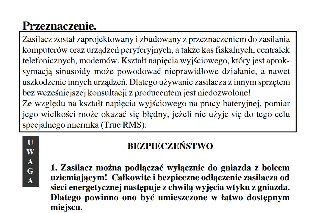

    And does your UPS have a pure sine wave ?
  • #4 15907107
    leonov
    Posts: 8917
    Help: 1039
    Rate: 2251
    Right at the beginning of the instructions, you have this information. UPS Furnace - Fideltronic ARES 1000 via Gas Boiler via no power.
  • UPS inverters fail when the furnace heating cycle starts
