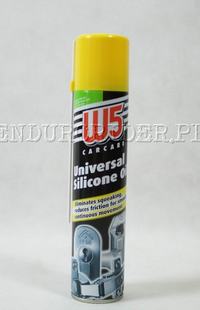

    As a year ago, I treated the lock with silicone oil W5 for about PLN 5 from Lidl. So far it works flawlessly.

    arekb81 wrote:
    Spoiler:
    Best Spray for Unjamming Apartment Door Lock: Graphite Powder vs. Teflon Spray vs. Silicone WD-40
    Everything is good, but these are temporary measures, all lubricants cause the deposition of dust - dirt and this kills the insert
