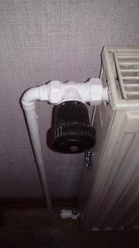

    WiTAM I have such a problem. I have to replace the valve like this, the old radiator is just a knob o and Z. and I want to replace it with a thermostatic valve to regulate this heat and please tell me what to do, step by step, it's best to take Step-by-Step Guide: How to Replace Old Radiator Valve with a Thermostatic One

    Block or single-family house?
    In general, cleaning the flare fittings from paint, but as I can see, the copper pipes can twist when unscrewing.
    Besides, draining the water from the installation.

    This is obvious, and due to the possibility of twisting these pipes (or weakening the solders), you have to re-solder the copper fittings. To reduce the likelihood of their twisting (unsealing of the solder), it is necessary to hold the valve body with a second key (you need a key 27 and 30 or 2 adjustable wrenches) when unscrewing the screwdriver, and when you unscrew the valve body from the pipe, hold the soldered copper fitting with a second key. so as not to tear it out of the solder when unscrewing it.

    and when unscrewing the valve body from the tube
    Which could be difficult because of the paint.

    And it is necessary. Drain the water? Single-family house. Thanks a lot for any
    Answers and to buy how. It doesn't matter what thermostatic valve?
    First of all, the size of the valve must be correct, otherwise there may be big problems with assembly (both the thread diameter and - if possible - adjusting the length to avoid complications). If it's Danfoss, you will probably need the longer nipple version. The (old) valve size will be stamped on the (brass) valve body - generally 1/2 '' and the new one will be the same diameter.

    It is imperative to drain the water. Otherwise, your water will run out of the system when you loosen the valve.

    Ok today I started the exchange. And everything kind of. Approx. Kind of warm. All. But I guess how I do, for example, the power of the head. For example, from 5 to 3, it probably does not get a cooler radiator: - /

    Because it will do when the room heats up. This is how the thermostat works.

    I know I understand. But I mean it. She's hot at 5. For example, I would like it to be a little. I set it cooler. On a 4th or 3rd. And there completely. Closing. I have this valve that they are getting cold. Completely. Exactly.

    Open the valve to 5. Listen to the noise of the water in the radiator. This can be heard near the valve. When it gets warm enough, gently turn the valve on until the noise stops. And you have the valve preset. Then only slight tweaks. But really light.
