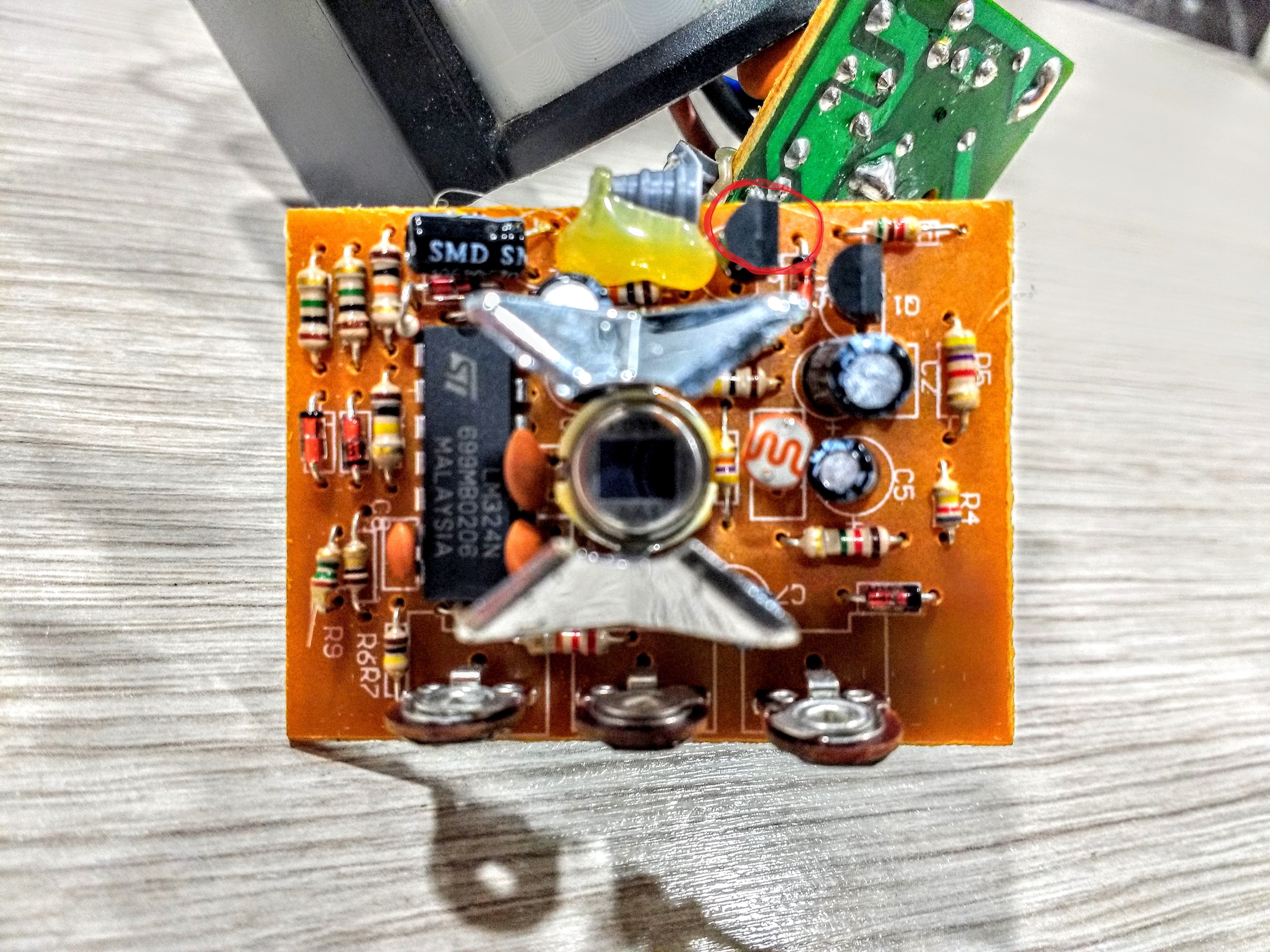

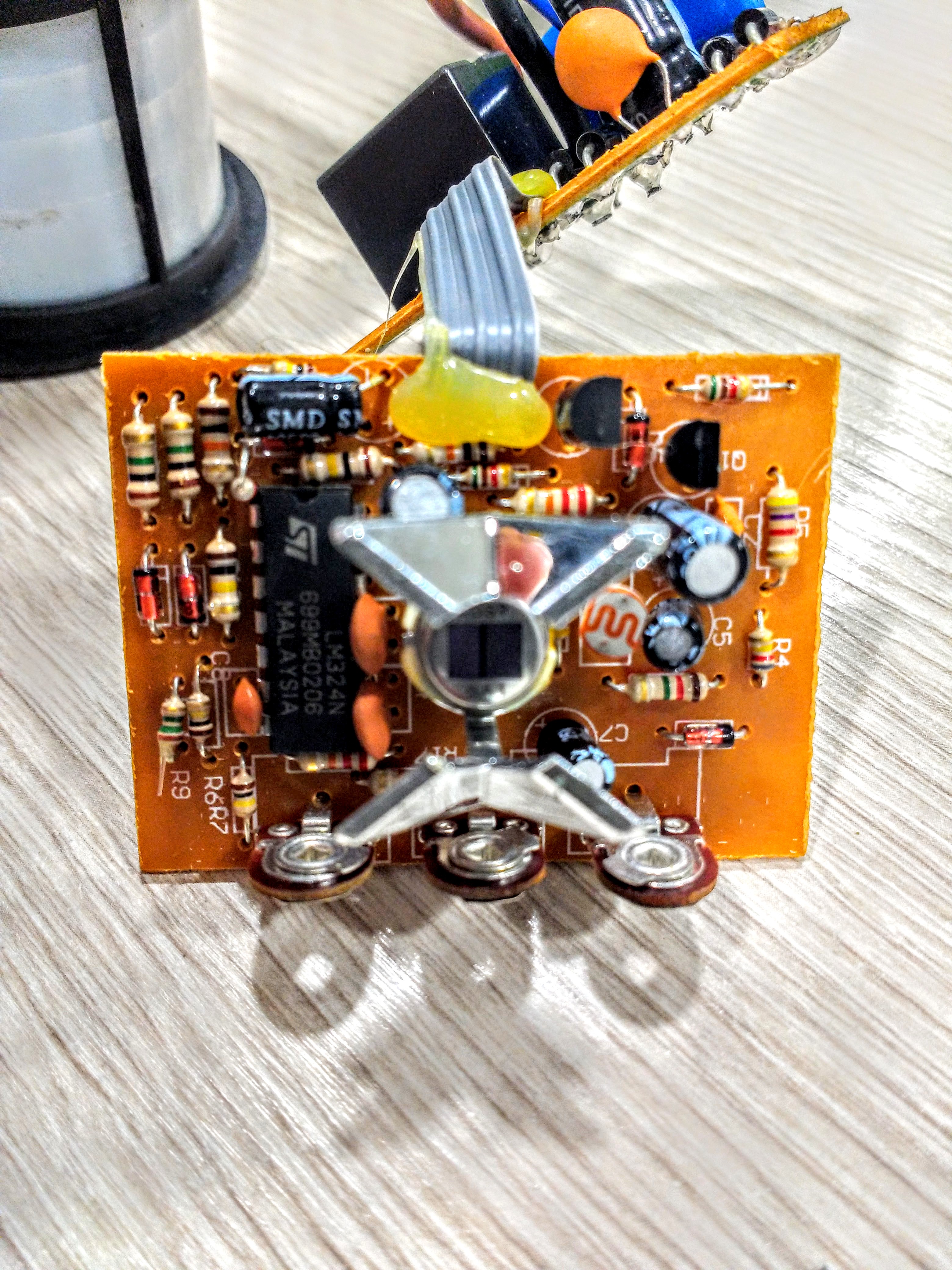

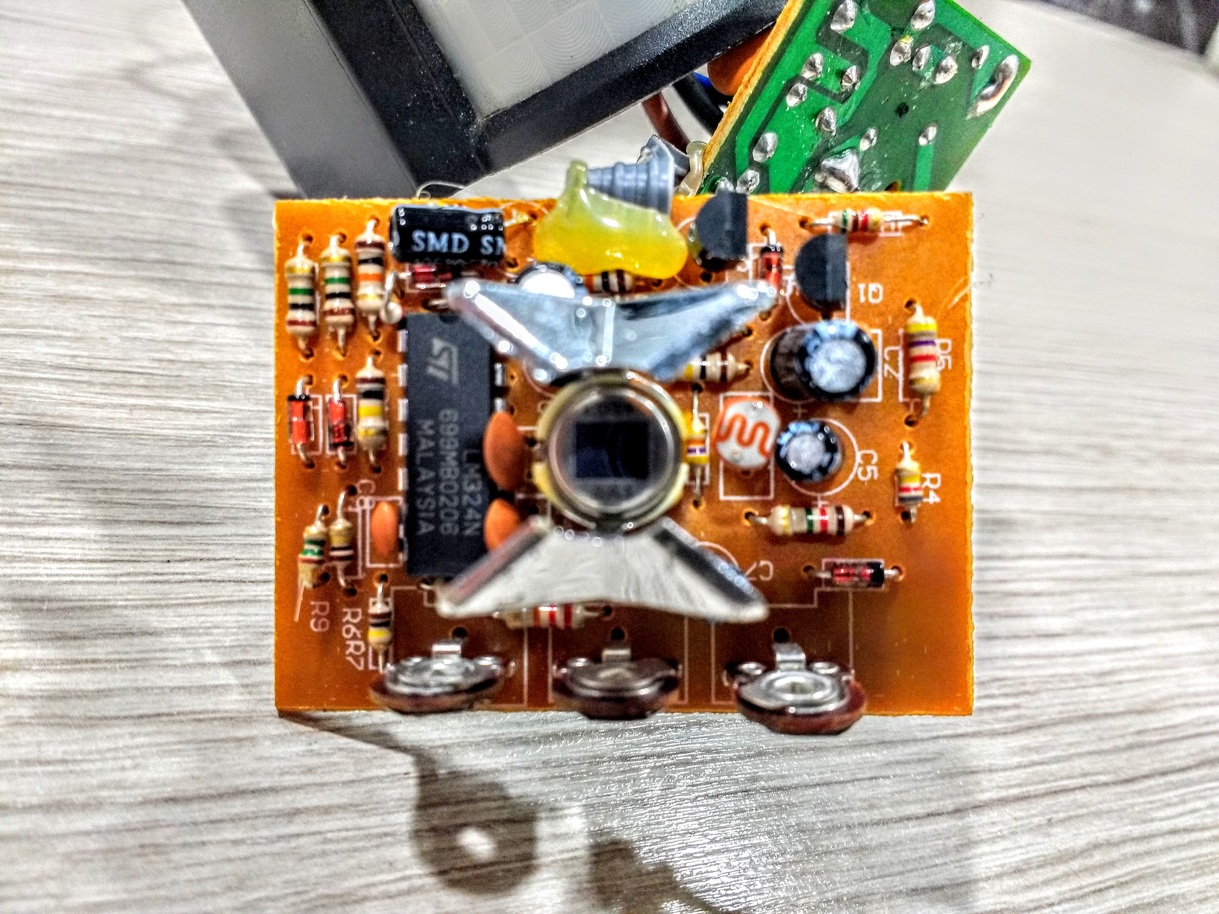

    The sensor does not switch on the lamp.
    What is the easiest way to find the fault in this motion sensor?
    Which component could have been damaged?
    Is it viable?
    Please do not hesitate to ask for help.
    Thank you.
    Regards.

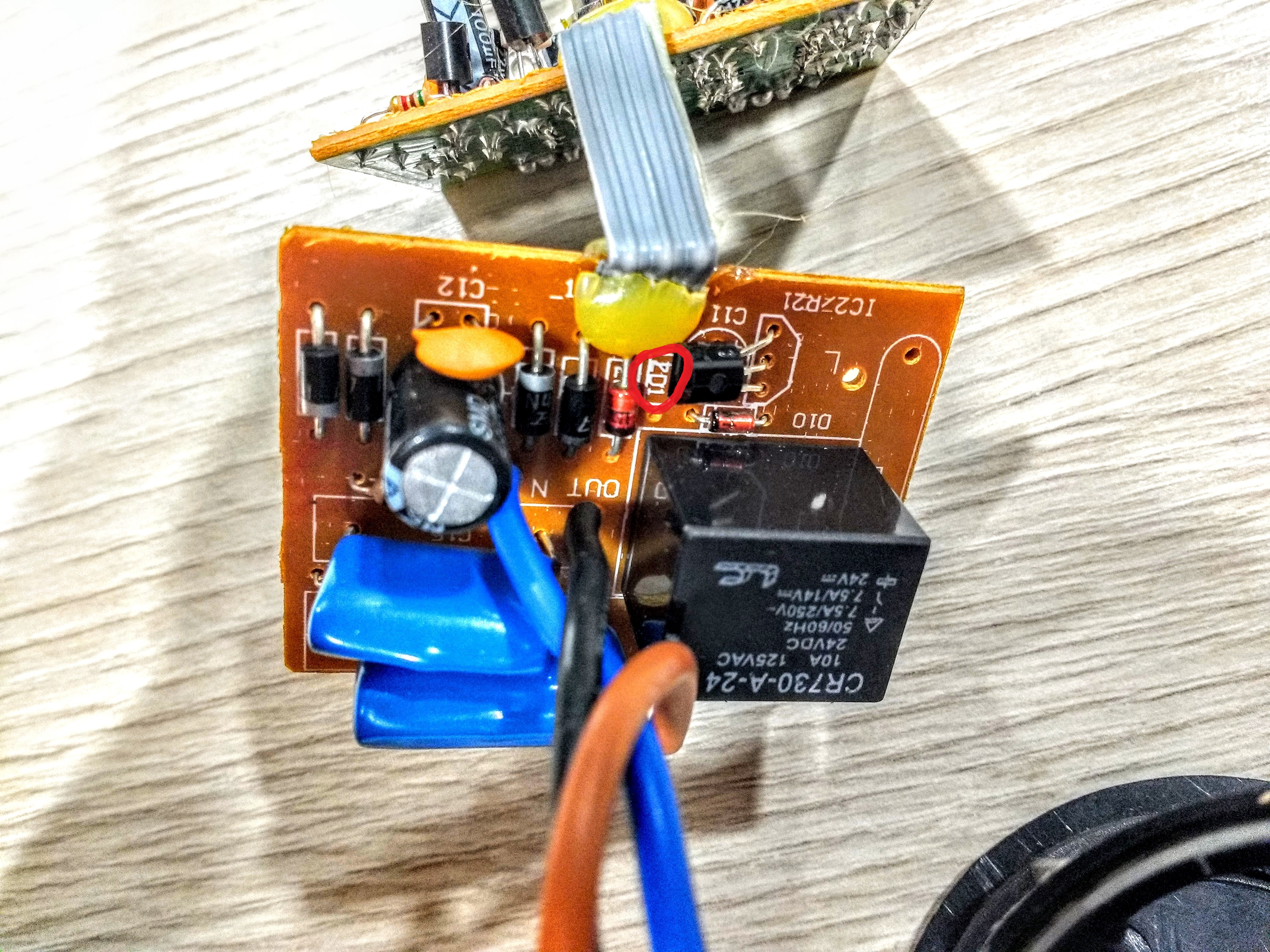

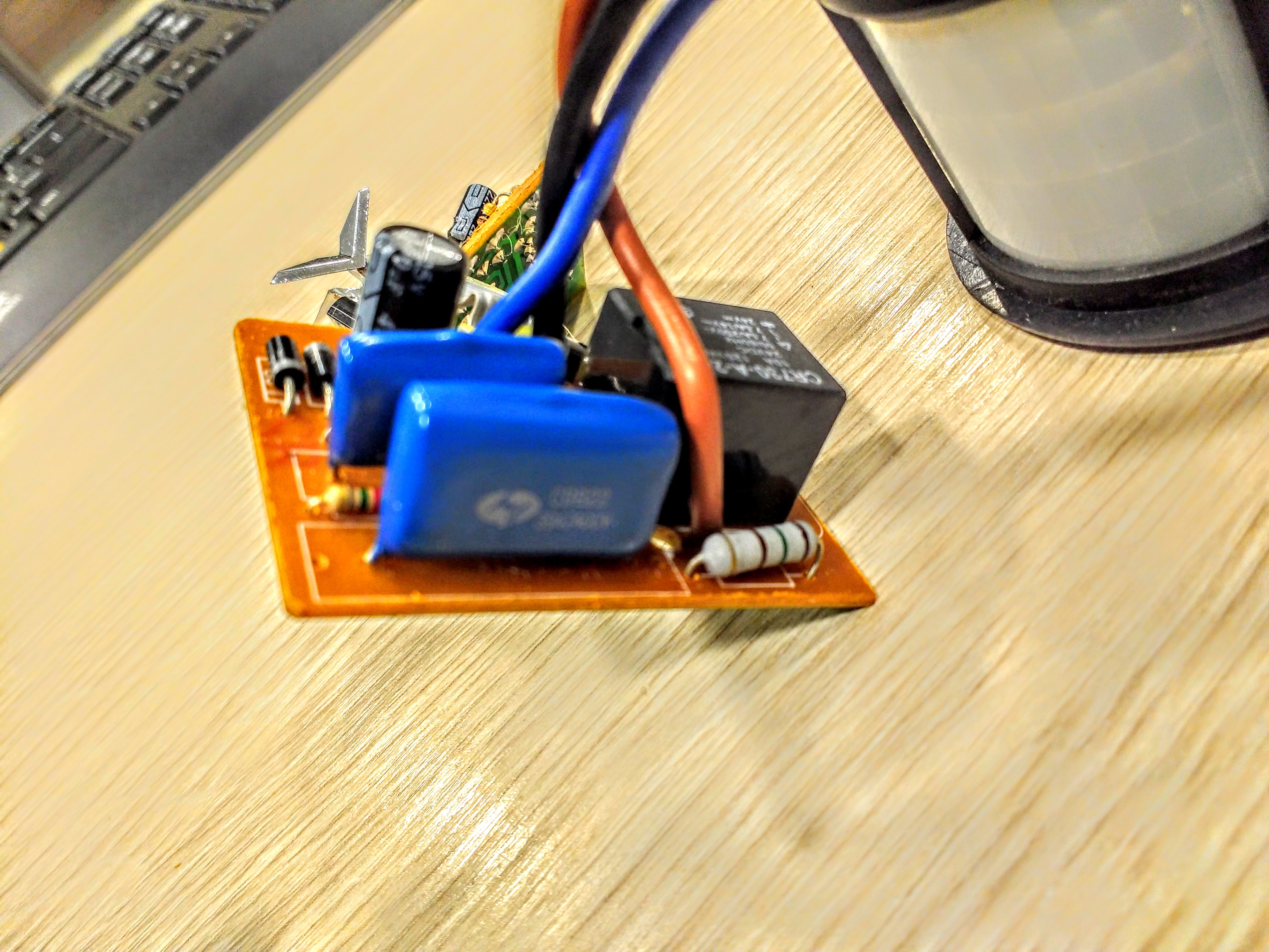

    At the relay, on the edge of the board, there is a resistor fuse
    Voltage measurement on diode ZD1

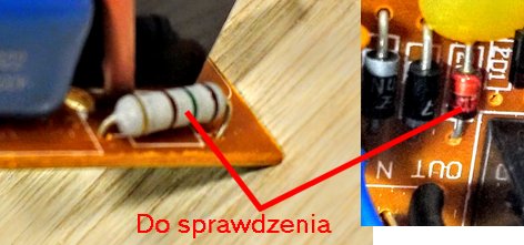

    I am guessing which ones these are, but could you please indicate the items?
    Thank you.

    Resistor value 150Ω/0.5W - looks like an ordinary resistor but also to be checked
