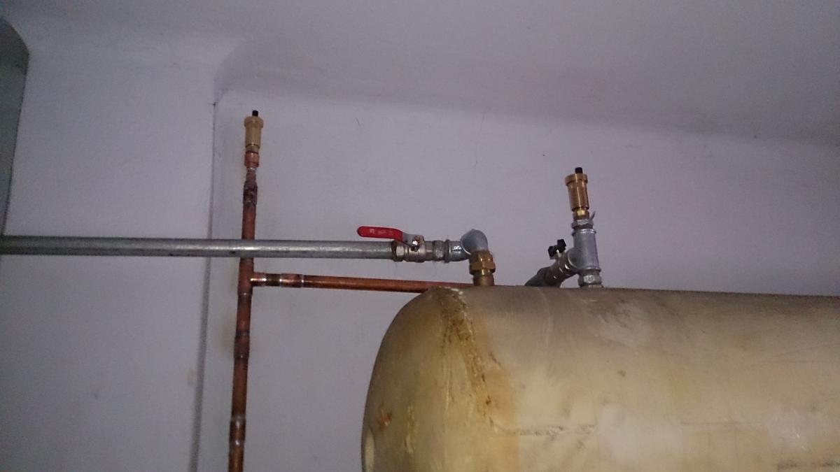

    Hello. I have a problem with a boiler that keeps airing, splashing, overflowing water, two-jacket boiler, open system. When I close the boiler power several times with this black valve next to the bleed valve, or the pump turns off, the air starts to escape through the vent valve, but after 2 hours in the boiler it starts overflowing again and you can hear air.
    From what I read, a properly made open installation should vent itself automatically through the vessel, and for me it does not happen.
    I wonder if the problem lies with the water supply to the installation. The pipe through which I admit water to the installation is led to the boiler return.

    And at what height is the vessel open? Is aeration of the collecting vessel done?

    The vessel is in the attic, i.e. at the highest point of the entire installation. As for the aeration of the vessel, I will not answer because I do not know, maybe the photo will answer this question. Air enters the boiler from the boiler. When I closed the valve on the pump for 5 seconds a few times, the air broke somewhere from the boiler and went to the boiler. I am surprised why the air that goes to the boiler supply and has two automatic vents on the way (you can see in the photos) does not escape through them, just stop in the jacket, and the boiler is vented when the pump stops working, or I temporarily close one of the boiler supply valves, then the air starts escaping through the vents.

    Is this valve all about? Boiler Continually Airing, Splashing, Overflowing - Open System, Two-Jacket Boiler Issues

    Looks like a flap check valve ...
    Move the check valve over the pipe section above the domestic hot water heater between the two vents.
    There is always a bubble of air or gas coming out of the boiler's power supply. The overflow vessel is probably not properly connected and there is air in the section from the boiler to the hot utility water pump. Non-return valve on off the pump is closed and here is the problem, because the way to the vent above the hot utility water is cut off. When the pump starts, you can hear the "buzzing" of water and air. The non-return valve opens. Some of the air will escape through the vent, but the rest of the small bubbles will go with the water to the hot water. And hence the "gurgling" in the hot water tank. In extreme cases, the pump may become air-bled and then it runs dry ... I do not have to describe the effects anymore.
    Forget the fact that alupex is connected to the overflow vessel ... To be modernized as soon as possible.

    The vessel is connected with PEX and probably to the riser with radiators. Re-attach the vessel directly from the boiler. The check valve can stay where it is. This galvanized tube on top of the vessel is clogged with something?

    If you have vents somewhere low on the return side, close them. Try shifting the pump to the lowest gear. The pump can draw air through the vent.

    The overflow vessel is not only about venting the installation, but above all for safety if the boiler boils. The most important pipe for the overflow vessel is the so-called safety pipe. There must be no valves, pumps or other devices on this pipe. The diameter of the pipe should also not be the smallest. Min ?25mm, but should be larger. A safety pipe can be a heating riser, if it meets the above-mentioned and other conditions specified by standards ...
    Safety pipe should be steel or copper. It is about the high temperature resistance of the materials.
    The vessel itself is also badly connected. Overflow, expansion pipe, vent ... Generally, "twists" are allowed and the safety pipe can be treated as an expansion pipe, but you need to connect it well at the vessel. Look on the forum - everything is there.

    I raise the topic because the problem is still valid, but I found out the reason why the air is still gathering in the boiler.
    When I have the 3d valve set to half, on a scale of 1-6 by 3, there is no full flow of water through the boiler because half of the water returns to the system and the other half to the boiler. And the problem is the too high heating of this water in the boiler, or actually on the water grates, because the problem only occurs when burning coal and in the coking phase (I burn from the top). Both DHW and CH pumps go to the maximum, but when there is no full water flow through the boiler, it does not bring the expected effect.
    There is also a second issue. Why does this water keep collecting in the boiler when I have two vents installed on the boiler and the air instead of escaping through the vent falls into the boiler shell?

    At least initially, the air will always fall into the boiler because it is forced by a quick "push" by the pump. Provided the first vent is properly installed, the second (the one above the boiler) should also "stand" on a piece of pipe that catches the flowing air. The deaeration of the boiler itself (based on my experience) takes a long time. You should bleed faster when the pump is working in the lowest gear. If you do not have fire in the boiler all the time, turn it on also in the non-smoking phase (1).
