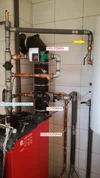

    I have a problem with the boiler, it seems there is air in it.
    The pipe to the boiler is warm, but cold at the output.
    The hot utility water pump "gurgles" during operation. How do you bleed it?
    In addition, I have a question about the GRUNDFOS ALPHA2 CO pump:
    Today the POWER lamp came on after switching on, but I cannot change the power.
    It looks like the pump is not working, is there air in it? How yes then how
    to bleed it? There is nothing to vent there.
    Everything worked fine last season ... and now it's about to air.
    Boiler - airing - how to vent?ZAPOWIETR..IE.jpg (2.3 MB)You must be logged in to download this attachment. Boiler - airing - how to vent?IMG_201610...164134.jpg (2.45 MB)You must be logged in to download this attachment.

    hello, buddy, to bleed it, unscrew the flare nut on the supply in front of the check valve, but for this time close the globe valve on the boler supply, then you will push the air back, greetings.

    unscrew the flare nut as in the picture:
    And which one is a globe valve and where the air will go out.

    hello, buddy, you marked the flare with the arrow, but this is not what I meant, but the one below the inlet valve, which you should close for the time of venting.

    Blow off this check valve at the boiler.

    Yes, I'm going to throw him out, but this pump is bothering me, how to check if it works?
    Added after 1 [hours] 43 [minutes]:
    Hello again ...
    I read that the lit Power ON diode is blocking the pump:
    Current ok, I checked another pump)
    I cleaned the mesh filter (it was dirty) and how to clean the pump or unblock it
    rotor?

    From what I can see, these check valves can be plastic, i.e. crap that does not hold once, two can get blocked, hence there may be no flow, when you release the hot water, check if the spine is plastic, so change immediately the one with metal a mushroom

    It is not clearly visible, but is this valve with a filter on the central heating pump sometimes closed?

    The valves have metal mushrooms 100% :-)
    The valve is open.

    It is possible that the problem is solved, I dismantled the pump, moved the impeller (rinsed), turned it, connected everything.
    I blew this valve in front of the boiler.
    I heated the temperature sensor so that everything would start, everything was going so that within an hour the air was escaping through the upper vent.
    In addition, I had to push through one loop of the floor heating with tap water because there was air in it.
    We will see if it will be like this when I light the stove because there will probably be some more air "warming up"

    Hello after a long time.
    All problems no longer occur.
    After modifications and accidental boiling of water, all problems with airing
    have resigned ... :-)
