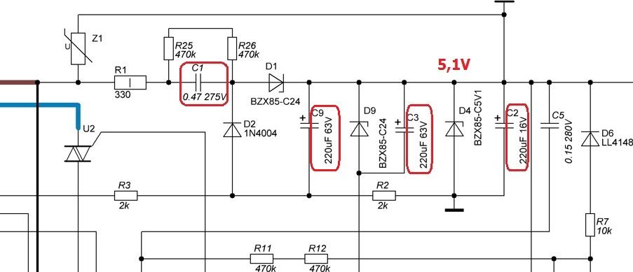

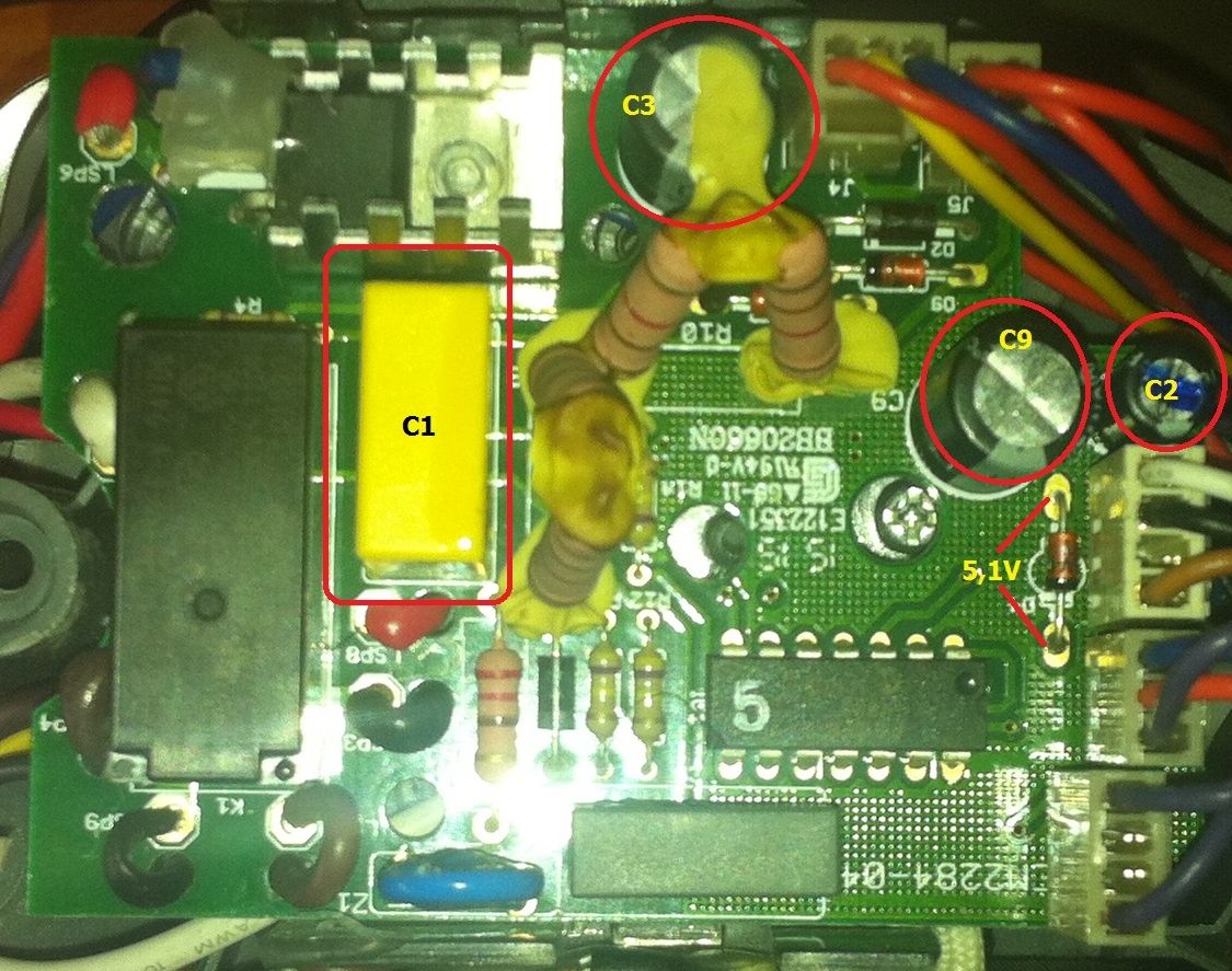

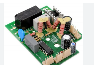

  • C1 and electrolytics replaced to restore processor power
    #33 19302031
    dasej
    Level 32  
    Posts: 1911
    Help: 165
    Rate: 267
    Again, mine refused to obey.
    This time I had more time and I hope it will last longer.
    Intermittent Functioning of Kenwood KM 287 Prospero: Arm Maneuvers Required for Operation
    The processor did not have full power and taking into account that it "probably" measured the power level, it would not start.
    I changed C1 (it was 330nF) to 470nF and the voltage on the zener diode returned to normal, according to the diagram.
    In addition, I replaced the electrolytes had half the value. Instead of 220uF it is only 100uF.

    I had a problem - sometimes the robot turned on, sometimes not, most often it started after a long stop, not necessarily after work (as if the reason was heating).
    I replaced C1 - 330nF, C9 - 100uF, C3 - 100uF, C2 - 220uF
    it did not work,
    I replaced the NT75 2C S 0.41 5 relay, unfortunately there was no such, I used RM85-2011-35-1024 (supposedly the same)
    after the change, it started, but it started being turned off - the potentiometer is set to '0', i.e. it gives power, although it should not.
    responds correctly to speed changes.
    on the processor power supply equal to 5.00V
    What could be wrong?

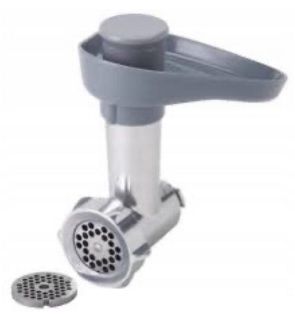

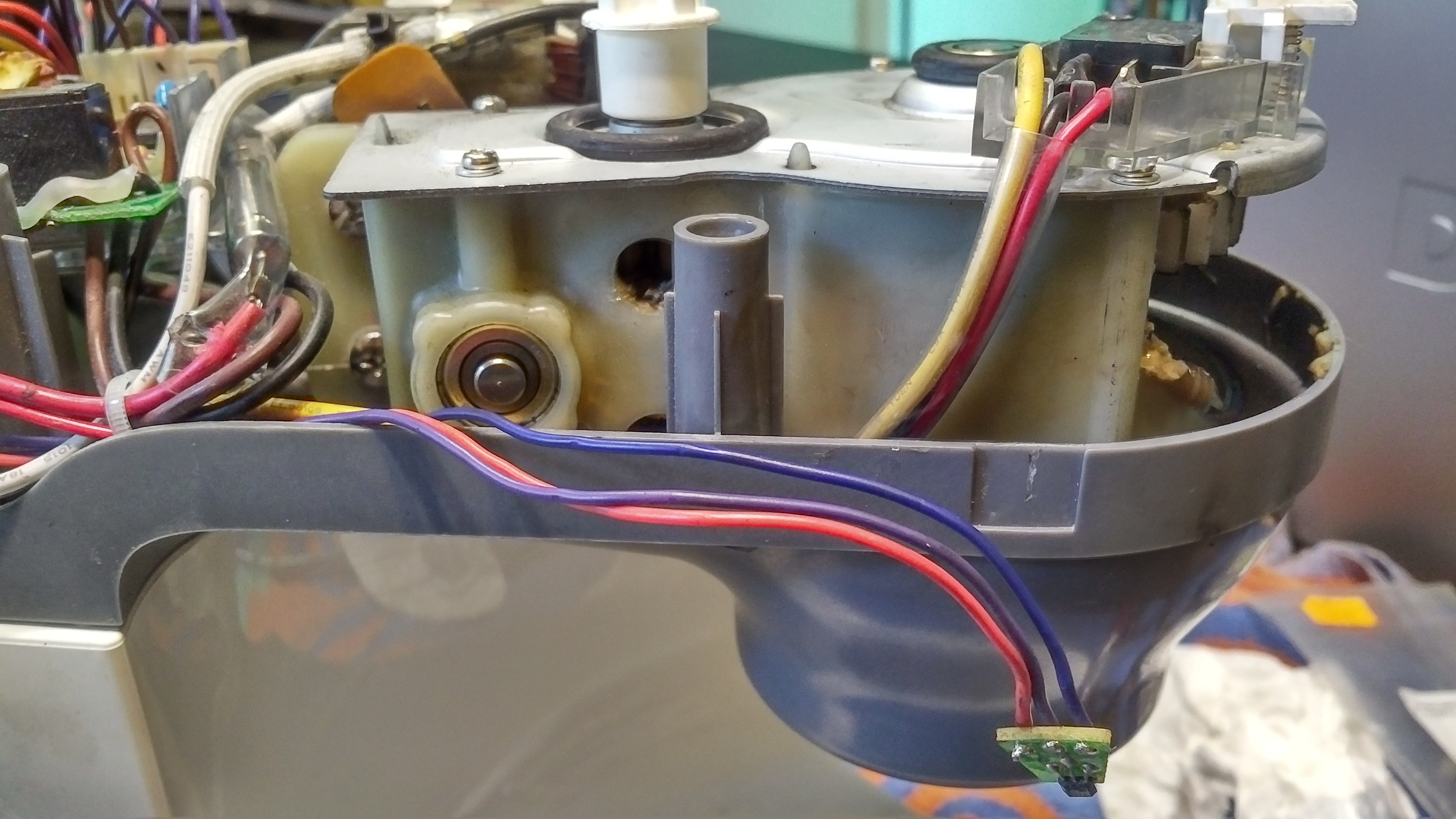

  • ATS137 hall sensor output shorted in working position
    #36 20164506
    Cyrculator
    Posts: 313
    Rate: 86

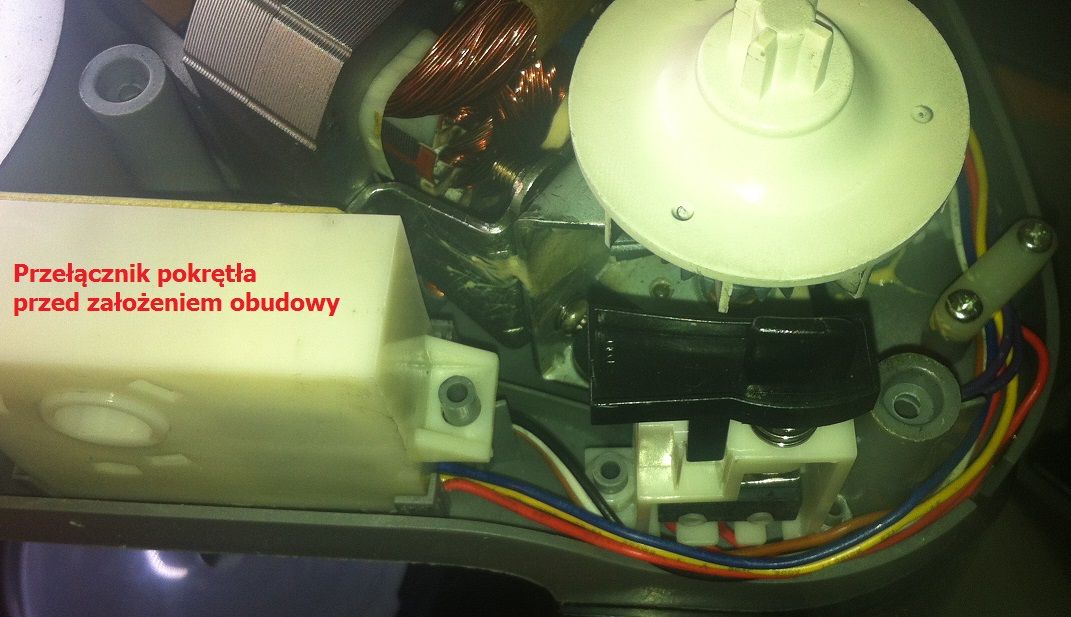

    Hello. I also "fight" with KM28 which does not turn on. I checked all the limit switches, potentiometer etc. I bought a new module with electronics and nothing like that. However, I noticed some absurdity in the ATS137 hall sensor system. This sensor in the arm lowered position, i.e. working position, has a short-circuited output with the arm lifting and lowering limit switch. I thought that someone had repaired it before and made a mistake, but now I look at this diagram that it should be like that. He doesn't understand any of this. I have no idea what can be done here. The tacho generator produces an alternating voltage when it is turned manually. I do not replace the HALL SENSOR because it is short-circuited during operation, specifically the collector with the emitter of the output transistor. It only opens when the arm is raised. I changed the contacts of the lowering lifting limit switch from NC to NO but it also did not change anything. Rel 1 relay on the board does not turn on after turning the knob.
    Anyone have some ideas yet /
  • #37 20164925
    dasej
    Level 32  
    Posts: 1911
    Help: 165
    Rate: 267
    from what I remember in this position, Hall should be open
    only after you put it on
    it should be compact.
    The KM287 Hall is used to identify the assumption of a meat grinder.
  • #38 20187622
    Cyrculator
    Posts: 313
    Rate: 86
    Thanks to Dasej for the explanation, and here my problem was that I did not know the manual or had these attachments from the customer.
    On the other hand, the problem was that one wire in the circuit of the adapters presence switches was broken in the insulation by a sharp cut with the casing.

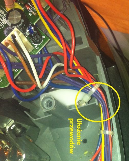

  • Deformed two-pin connector caused intermittent startup
    #41 21361227
    inar
    Posts: 262
    Help: 40
    Rate: 38
    Good morning!
    My KM28 was switching on when it wanted to, there was no rule. To start with, I replaced electrolytes, checked the wires, the switches and nothing.
    On the advice of Col. dasej I measured the voltage on diode D4-it was undervoltage, replaced capacitor C1 and again the voltage is 5 volts and the robot starts when it wants. I locked the limiters, turned it on with the knob and started moving the wires coming to the board. It turned out that in the two-pin connector ( to the right of capacitor C3) the contact had deformed and the connection was when it wanted to. I disassembled the connector, tightened up the sheet metal and the unit works.
    By the way, the whole robot vibrates quite a lot during operation and the method of connection through these delicate connectors is not the happiest solution.
    Best regards and I wish you all a peaceful Christmas , and in the New Year 1925 good health and patience when repairing such malicious failures.

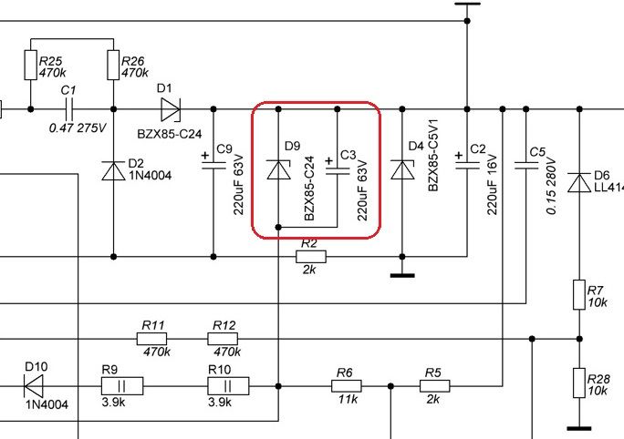

  • #42 21397068
    bratmat1
    Posts: 19
    I have no voltage on capacitor C3. What should the voltage be there? The relay does not start - capacitors changed. On the other two capacitors, the voltage is 22.5V and 4.9V
  • #43 21397171
    dasej
    Level 32  
    Posts: 1911
    Help: 165
    Rate: 267
    And how does the zener diode stand in parallel with C3?
    Section of an electrical schematic with Zener diode D9 parallel to capacitor C3 highlighted. .
  • #44 21400912
    bratmat1
    Posts: 19
    Diode D9 is in parallel with C3(no voltage on diode), diode D1 in series (voltage 11.1V). Resistors R9 and R10 have a resistance of 2.16 Kohm each. Could it be the fault that this PIC is not supplying power to C3 ? - it looks to me like the circuit is not working
  • #45 21465900

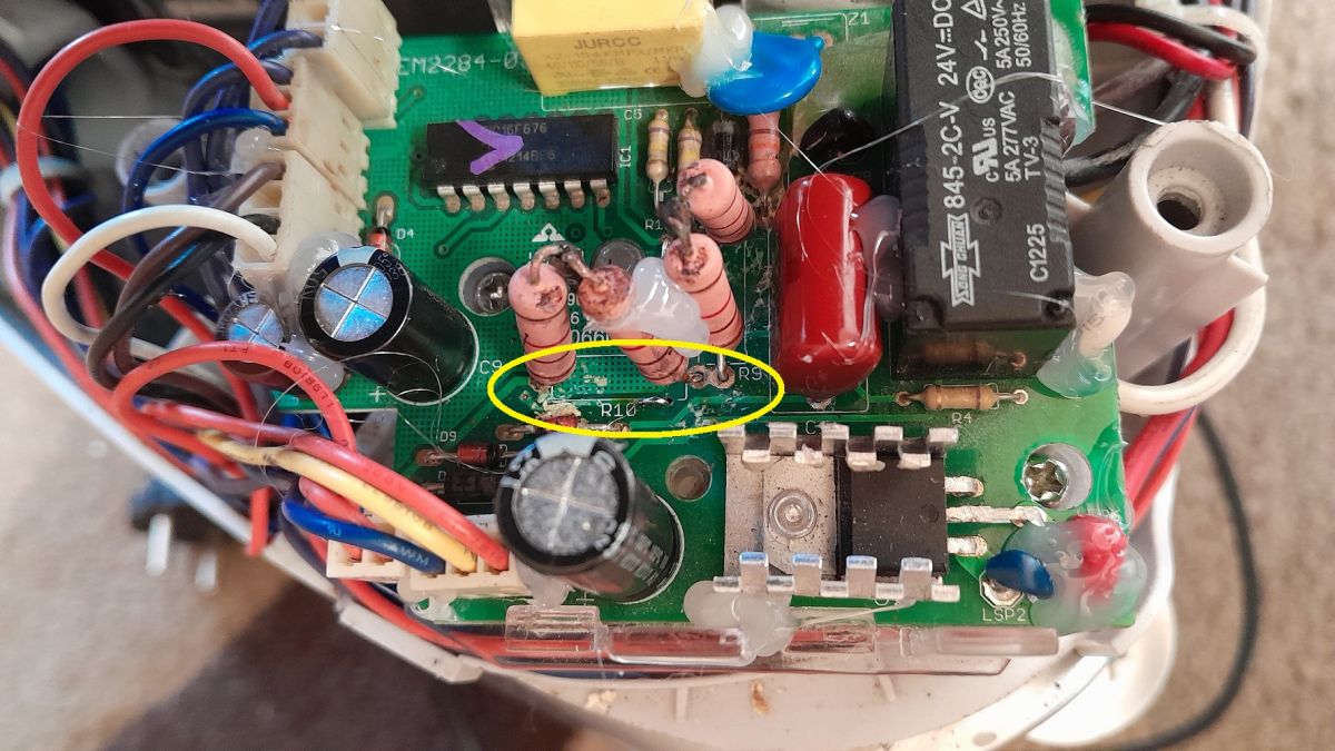

    Hi. In my case the startup problem was caused by a faulty via. It is on the gate path of the triac. It is located under the glue holding the power resistors.
    Close-up of PCB with damaged via under resistors near the triac, highlighted in yellow

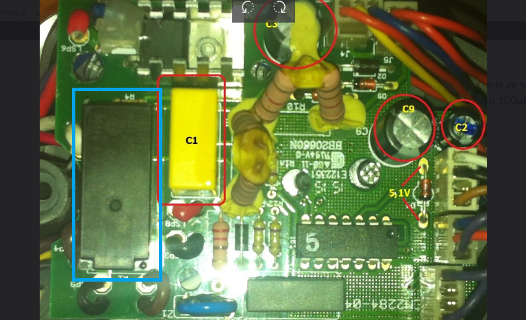

    I have a question. In my case, the relay next to this C1 does not start - I have marked it in blue.
    If I manually short-circuit it - mechanically move it, the robot works, but with the problem that it starts immediately, even when the knob is at 0 - only at minimum speed.
    Does this mean a faulty relay or a faulty board?
    Close-up of a PCB with a relay and a yellow capacitor labeled C1 highlighted
    On a video on YT, the guy in French says it behaves like this and that you can replace the C1 component and it should play - but there is no writing on it to identify it.

    From what I have been able to observe, the relay is only switched on when all the conditions for a safe start are met, checked with the limit switches. The speed control of the motor is done by a triac - in your photo the element with the heatsink above capacitor C1. Capacitor C1 is in the power supply circuit. If its capacitance drops, the output voltage after stabilisation may be too small to trigger the relay. According to the schematic, C1 = 470 nF, 275 VAC. You can also check the voltage on the controller. There is supposed to be 5 volts between legs 1 and 14, but I would advise against measurements when plugged in unless you have an isolation transformer.
  • #52 21834188
    hudy5
    Posts: 19
    In principle, I can assume that the safety conditions are met, because when I manually short the relay and the robot starts, when I let go of the top-mode cutout or simply unlock it by opening the robot up, then the robot stops working.
    Well, I won't take measurements after plugging it in.
  • #53 21834209
    mjelen
    Posts: 11
    You can simply solder out the suspect capacitor C1 and measure its capacitance with a multimeter. If it's in the region of 400 nF or more, then you may think it's OK and need to keep looking

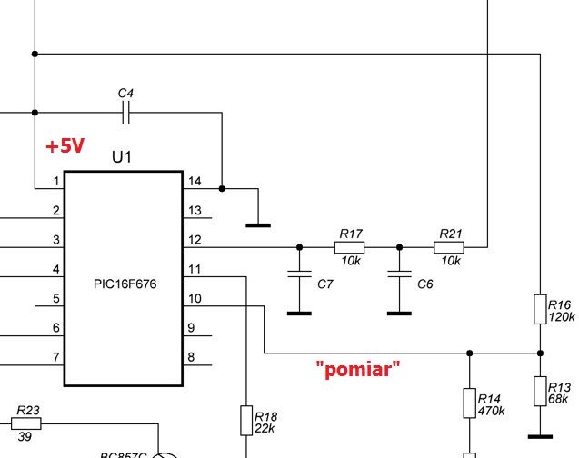

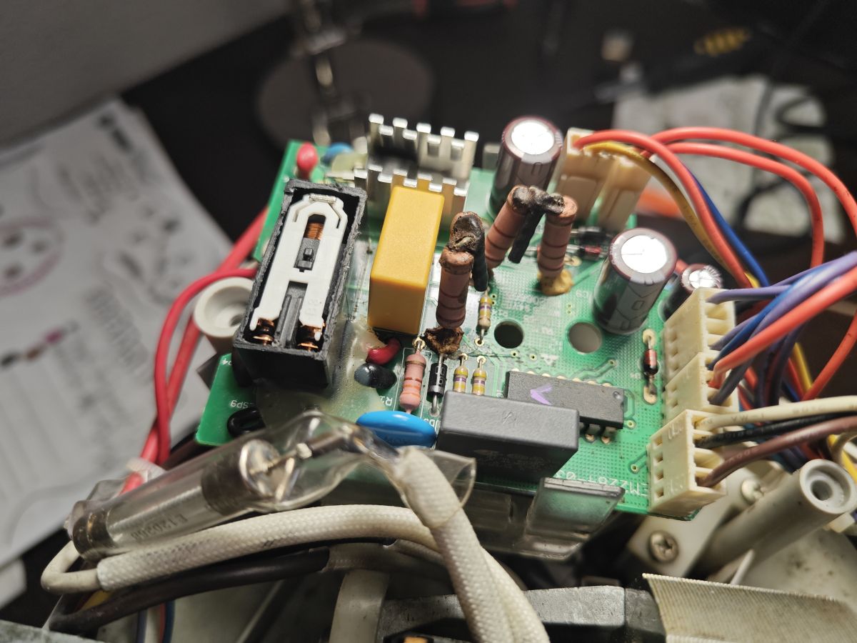

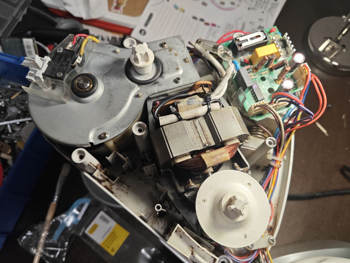

    Hello I have a km 266 model all electrolytes replaced as shown in the photo + 2 surge protectors, when pressing 2 buttons the works turns on with full power and shuts down please help what else could be , so as not to buy a whole power supply....
    Inside of a device showing motor, gearbox housing, and a PCB with capacitors and multicolored wires Power PCB with components, showing charred resistors and wiring inside a device housing
  • #57 21907272
    Telo
    Service technician RTV
    Posts: 13118
    Help: 1522
    Rate: 2366
    The supply voltage to the PIC is correct, is the triac switching the motor not faulty.
    Probably on the gate you have a full drive.
    Fellow dasej post the whole schematic of this board, it will be easier to diagnose.
  • Meter checks needed for PIC supply and triac control
    #58 21907854
    Bolox11
    Posts: 11
    Thanks for the quick response,the PIC is probably a so called chip. How do you check the power supply to it? A triac is what?
    Still a gate?
    Lots of technical stuff, and I will say from myself that this robot is the only one that probably worked for more than 10 years until now, 3 capacitors replaced but nothing worked. Then a trial with a toothpick, also nothing, until I finally replaced 2 anti-voltage capacitors, it caught on, but for a while and full power.... I would just add what to measure with a meter to bring the robot back to life.
    Many thanks in advance.
