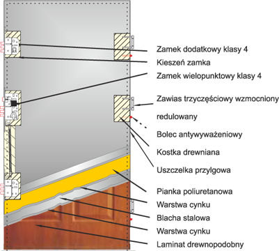

    JerzyR wrote:
    As far as it makes sense in an apartment in a block of apartments to have a class C burglar-proof door and two good locks (different)
    Apparently yes, but for an apartment in a block of apartments must be a class C door ? Isn't class B enough ? Looking at KMT's offerings, the door grades between B and C probably differ only in that C has a steel truss inside, a wooden frame around the edge of the door and perhaps two additional bolts.
    Class B doors:
    Comparing One Key System vs. Two Different Cylinders for Home Front Door Security
    Class C doors:
    Class C cylinders and anti-tamper locks can be installed for both models.
    It is known that a class C door will be better, but on the other hand, looking at it, will anyone try to balance or cut the door on the staircase in the block of apartments?
    On the other hand, certainly a class B door (with a structure like the one shown above) will certainly be much better than the doors installed "standard" in apartments with cardboard inside and clapboard outside.
