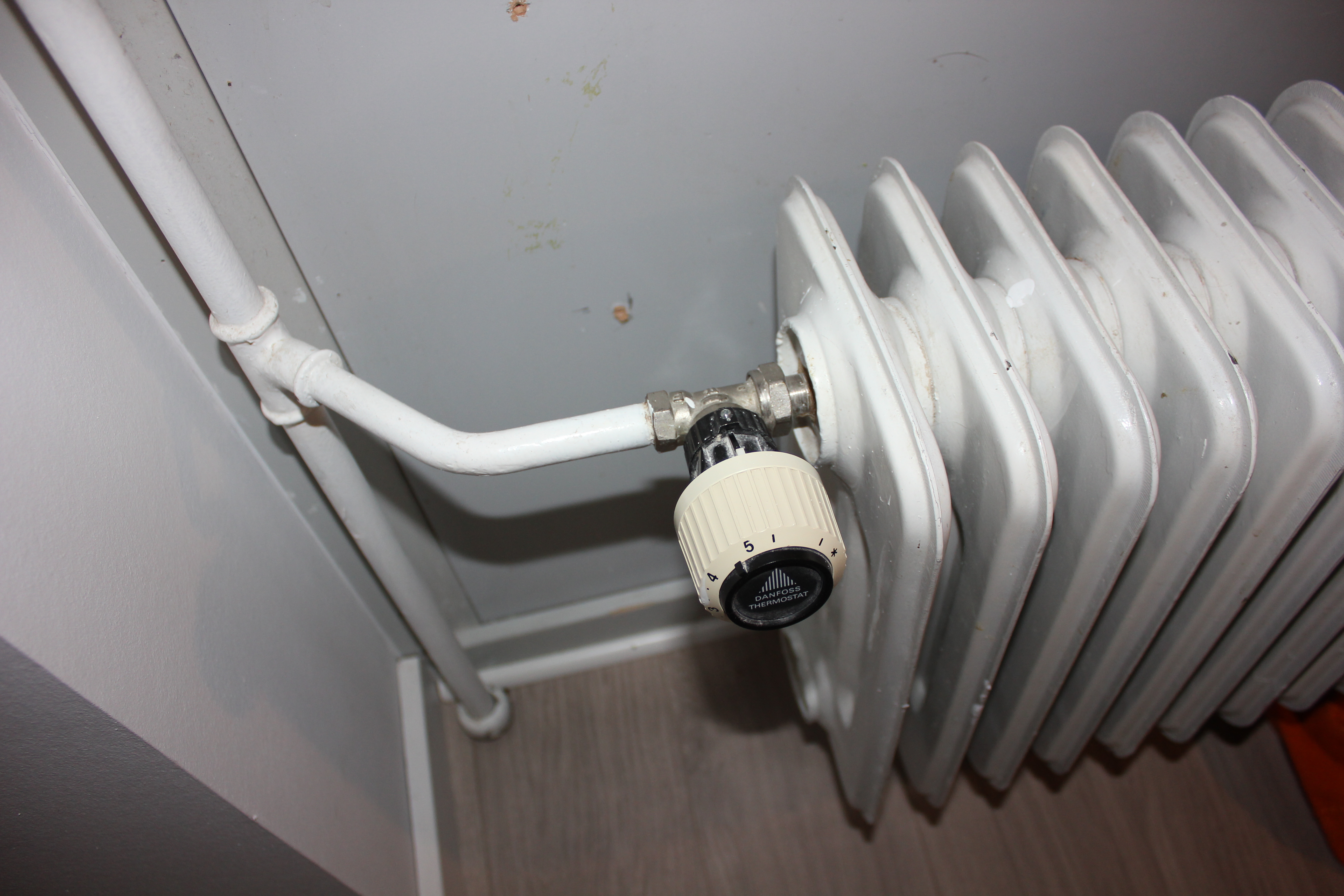

    I am asking for help, what to do here:
    Deaerated Heater Remains Cold: Troubleshooting Central Heating Block & Water Release Methods
    Added after 13 [minutes]:
    I will add that I made various combinations. I let off the water in the upper right next to the left one, all the plants and the heater was warm / very warm at the top. it is a central heating block, all right in the adjoining room

    hello, buddy, first of all, write whether the heater of this radiator last season, then check if the valve pin can be dented, maybe the valve plug is stuck and does not release the heating medium on the radiator, if so, take pliers and start this pin.

    Well, it looks like you need it too move on . Something happened: tube or valve, heater unlikely. It is unlikely to do without dismantling. :cry:

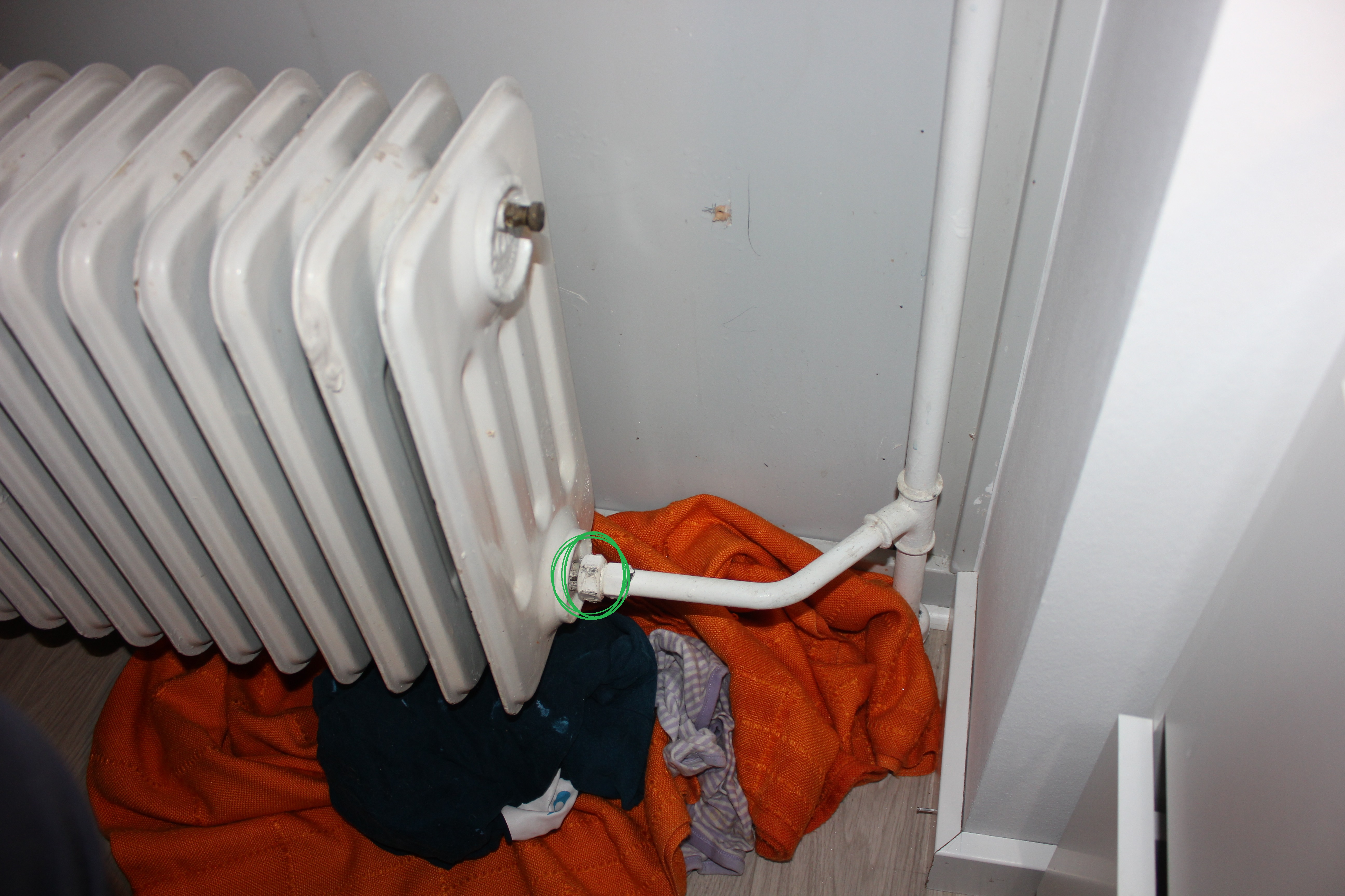

    Deaerated Heater Remains Cold: Troubleshooting Central Heating Block & Water Release Methods Deaerated Heater Remains Cold: Troubleshooting Central Heating Block & Water Release Methods Deaerated Heater Remains Cold: Troubleshooting Central Heating Block & Water Release Methods
    Added after 1 [hours] 33 [minutes]:
    it is very strange, but not the upper valve and the lower screw on the left (not visible in the photo) released the air. on another forum someone wrote that this is a sign that "there is air in the drainage riser and the problem may return. Probably in the top section of this pipe there is another vent that needs to be opened to fill the water pipe"

    Probably in the top section of this pipe there is another vent that needs to be opened to fill the pipe with water "
    Also possible. But you can vent the top and bottom of the radiator. Only water without bubbles should come out. If the inlet riser pipe is hot, there is definitely no air in this pipe! Which floor is your apartment on? If not on the upper one, ask your neighbor upstairs if his radiator in this riser works (the temperatures on the risers you described show that the above is OK).

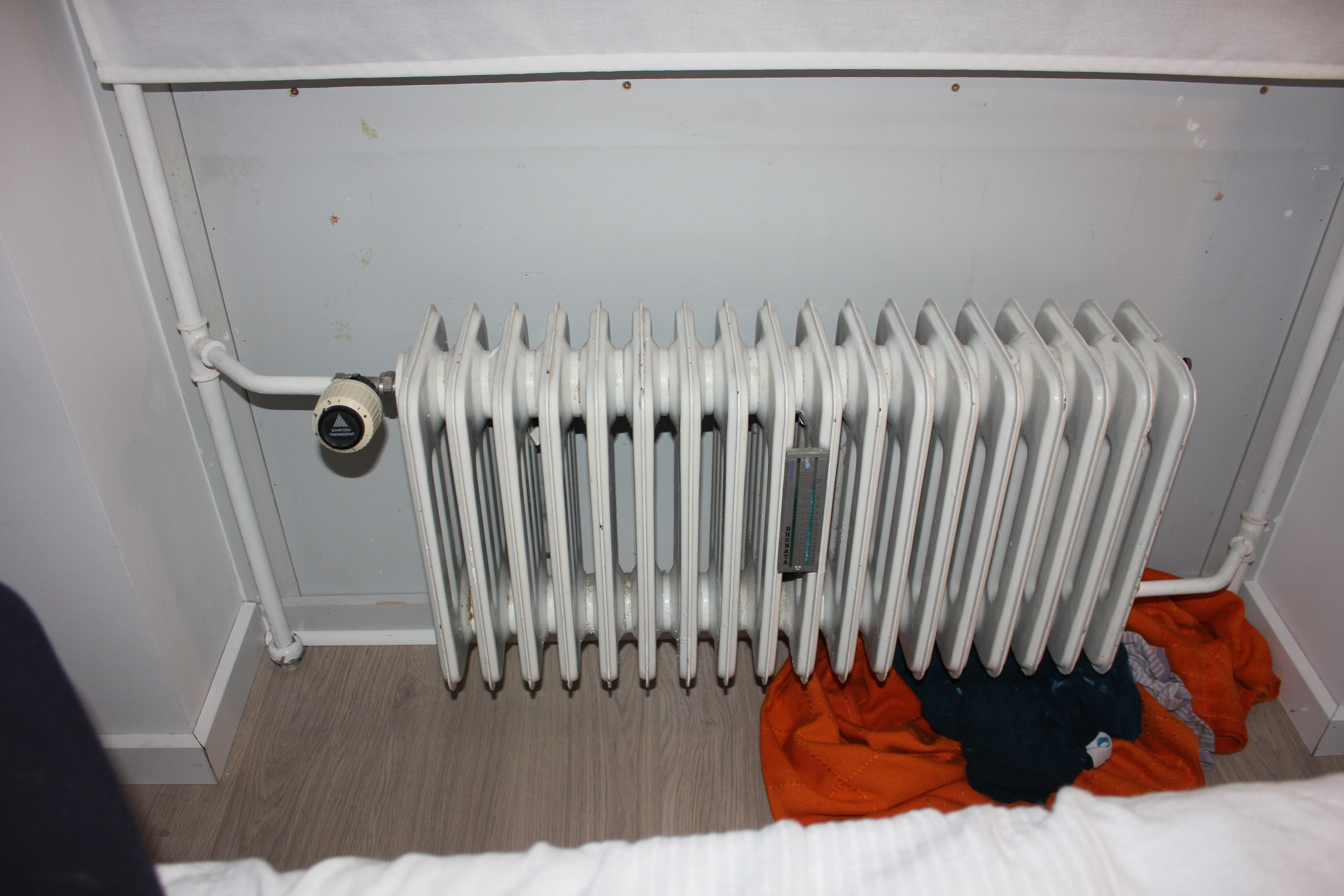

    The apartment on the ground floor is an apartment in Denmark, above me lives an old grandmother who speaks only a language I do not speak :(
    Yesterday, after the air was released, they were hot at the top, today all radiators are slightly lukewarm !!! the other, which was previously out of the question, the same symptoms, a slightly different structure
    It is badly fitted there at all. You can see in the photo (in the first post) that the twig deviates from the riser LOWER than it enters the radiator, and should go at least at the same height as the radiator thread, and it is even desirable that it deviates slightly higher from the riser to create a drop. With such a mounting as shown in the picture, it can easily get aired, hence a vent on the radiator is necessary (it's good that it is). There may also be air in the riser (there should be an air vent on the riser). What's in these photos a few posts next? It looks like a thermostatic valve with certain elements removed (head, mushroom)? It's strange that it doesn't pour.
    Speaking of Denmark, it is installed correctly.

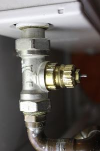

    This is a photo of the thermostat valve. There was a suspicion in another forum that it is a hertz valve, which is supposed to be at the output, not at the input. But other radiators in the house have the same valve.
