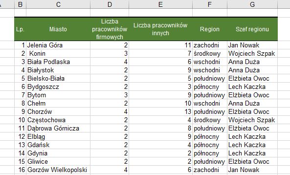

    In the attached table I have data on, among others cities and heads of regions.
    I have to use nested functions (without the use of auxiliary columns) to extract data on the number of women from cities with a two-part name (Bielsko-Biała, Biala Podlaska, etc.)
    Unfortunately, I was stuck on the 'woman' condition. I can't combine the count.if function with a fragment.text, even though its "find" components; "text fragment" work properly (ie they return me names ending in a, meaning women). However, I have a problem with counting them. "countif" returns zero to me.
    = COUNTIF (G3: G54, FRAGMENT.EXT (G3: G54, FIND (""; G3: G54) -1, 1) = "a")
    Do you have any idea how to solve it?
    (G3: G54 is the search range - column with the names and surnames of the heads of the regions)
    Thanks in advance for your help.
    It is too late time to practice such wobbles. But analyze slowly the inner functions (TextSnippet () and Find ()). Do they really work with arrays as an argument :?: If this were the case, how many occurrences of this condition would be indicated in the result and how would the array be placed in one cell? :D
    I used to make such expressions without an additional column, but then I created a variable name (here, for example, a woman) which, depending on the line number, defined the state of this variable (true-false).
    Then it was enough to count how many times in a given array the variable takes a certain state, e.g. COUNTIF (Array; Woman = True). :idea:

    what about that?
    = COUNTIF (G3: G54; "* a *")

    Prot, I guess you were right that it was not the time for such a freak :)
    Of course, I only checked the function of find and fragment.text for a single line, not for an array, and only then it worked for me.
    Thanks.
    JRV, thanks a lot !! Simple and perfect :)
    I am therefore left with the second condition, i.e. two-part cities.
    Combining these conditions in the count conditions function will be ok?
    I suppose I could check which city names contain "-" (Bielsko-Biała) OR "" (Biała Podlaska), I understand correctly?
    The assumption in the task is that I cannot use these city names, but I have to check which of them are binary.

    = COUNTIF (C3: C54, "* *") + COUNTIF (C3: C54; "* - *")

    Thank you.
    Ultimately, I put it together like this:
    = COUNTIFS (G3: G54; "* a *"; C3: C54; "* *") + COUNTIFS (G3: G54; "* a *"; C3: C54; "* - *")
