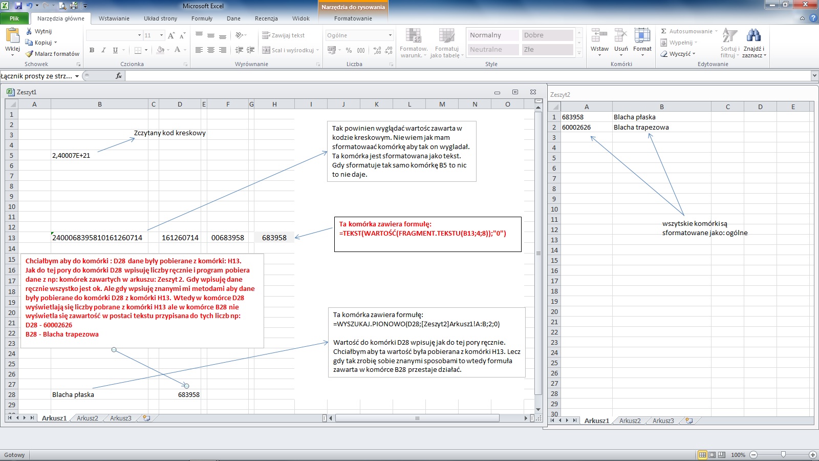

  • #4 16500539
    fafankulo
    Posts: 20
    At the beginning I thank Mr. JRV very much because what he gave was 100% successful.
    I have two more questions on the same subject, namely:
    1. how do I format a cell to display content in the form of a number of digits from the read bar code?
    I don't know why it displays this number of digits in one cell that is formatted as text, and in another cell, although it is formatted the same.
    2. How do I connect the function:
    = VLOOKUP (D28; [Book 2] Sheet1! A: B; 2; 0) So that I do not enter the values manually into cell D28 so far but it was
    taken from the cell that contains the formula:
    TEXT = (VALUE (MID (B13; 4; 8)); "0")
    I hope I wrote what I mean in an accessible and understandable way.
    I enclose printsreen excela maybe it will help what i mean.
    Thank you in advance for any help.
    Greetings.

    #5 16500557
    JRV
    VBA, Excel specialist
    Posts: 2724
    Help: 805
    Rate: 455
    fafankulo wrote:
    that I do not enter the values manually so far into cell D28
    Judging from the fact that the value alignment edge in cells, in D28 it looks like a number then as in [Book2] Sheet1! A: And it looks like text, although it would actually be a number if the formula works
    #6 16501858
    lanzul
    Level 30  
    Posts: 1023
    Help: 199
    Rate: 123
    fafankulo wrote:
    ... 1. how do I format a cell so that it displays content in the form of a read bar code in the form of a series of digits.
    2. How do I connect the function ... So that I do not enter the value manually into cell D28, but it was there?
    taken from a cell that contains ... formulas ...
    Ad 1
    Format the column into which the codes from the scanner are read on text values . but before scanning codes - Excel has display accuracy of 15 digits, and here are 22 digits.
    Ad 2
    JRV wrote:
    ... Judging from the fact that the edge of value alignment in cells, in D28 it looks like a number then as in [Book2] Sheet1! A: And it looks like text, although it would actually be a number if the formula works
    Just ... a friend JRV he rightly noticed ... how the search formula should work correctly since in "Sheet1" the value in D28 is in the form of a number , and in "Sheet1 of Book 2" the corresponding values in the form of text ?
    ... you have to decide on something ... either text or number ...
    ... or here text, there number, but search function with text-number conversion function ... or number-text ...
  • #7 16502251
    fafankulo
    Posts: 20
    Thank you for your answers.
    Although I have to admit I didn't understand much.
    That is why I decided to present again what I mean:
    I attach a screen in jpeg and two sheets in Excel.
    Thank you in advance, and I'm sorry that I'm so crude.
    Greetings, ;-)
    • Zeszyt1.xlsx (17.41 KB) You must be logged in to download this attachment.
    • Zeszyt2.xlsx (12.86 KB) You must be logged in to download this attachment.
    • Excel - a formula that extracts a series of numbers from a series of digits Formuła.jpg (384.43 KB) You must be logged in to download this attachment.
    #8 16502266
    JRV
    Posts: 2724
    Help: 805
    Rate: 455
    It should be from the very beginning.
    Values in Book 2, column A: A is numbers (all cells are formatted as: general), but .... the alignment takes place on the left edge, then it has look text.
    Simply use H = VALUE (TEXT FRAGMENT (B13; 4; 8)) in H13
    As for B5 - the same format general , left edge alignment
    Barcode lookup via hyperlink to product photos
