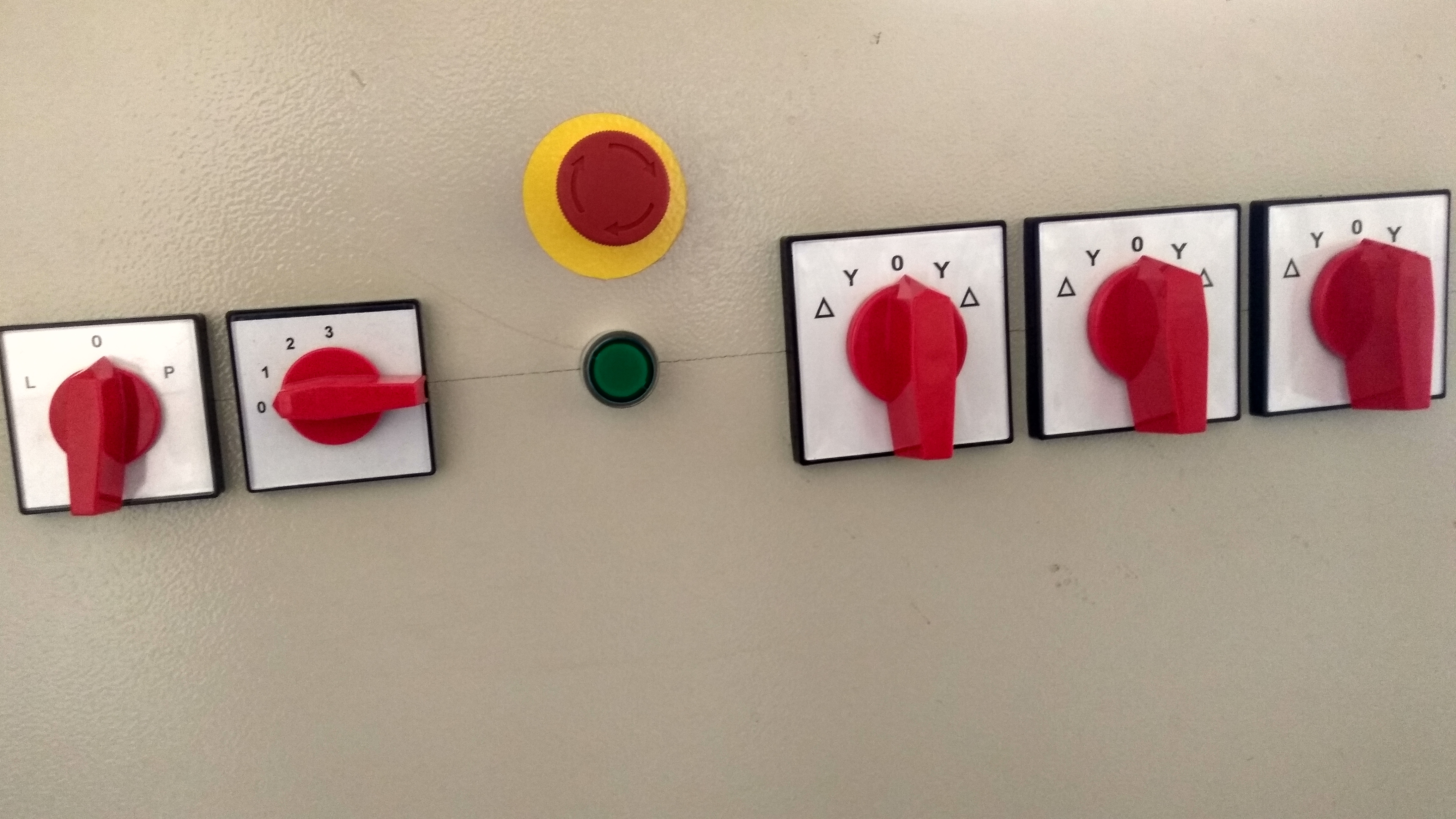

    And related to the topic, I now have a month`s internship and I make control cabinets for engines. Why do star/delta cam switches have two stars and two delta? (i.e. both left and right). Understanding Engine Nameplate Voltage Ratings: 230/400V and 400/690V Delta/Star
  • #9 16063136
    ciuqu
    Posts: 3279
    Help: 512
    Rate: 829
    These are the so-called Δ/Y switches. "reversible", i.e. a left-right and Δ/Y switch in one.
