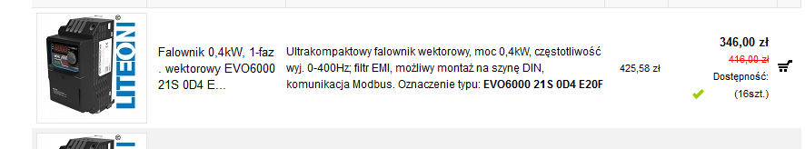

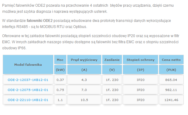

    And there are even inverters that do not have the correct voltage on the DC bus to get 400V for the motor.
    The 1-phase inverter with 230V voltage controls a 400V star-connected motor (400V) and has almost four hundred
    and it is true that such a situation should not be long-lasting because the motor and the inverter suffer.
    This is the reverse of your case.
  • #14 16802868
    Krzysztof Kamienski
    Posts: 21895
    Help: 2033
    Rate: 5167
    @ jaro33 Have a colleague heard about inverters with voltage doublers? Very popular in the USA. Powered by 120 VAC, they drive the 3x 220VAC motor. So who is suffering here? :D
  • #15 16804738
    jaro33
    Posts: 100
    Help: 7
    Rate: 33
    I do not entirely agree.
    This is how the inverter has a system that allows you to power the motor with higher voltage.
    And I wrote that there are such solutions, but at the cost ... .. I can not even mention because I did not analyze this issue.
    But nothing is free in nature, and prices must be calculated. Only my opinion - maybe wrong.
    And besides, why inverters for 1-phase motors are much more expensive ???
    Haven't read that anymore?
    Understanding Inverter Output Voltages for 230V Delta-Connected Motor in a 400V Network
    to compare
    865 and 346 is a big difference
    https://www.sklepfaliczki.pl/faliczki-do-silnikow-1f.html
    Anything you can do is just another thing like economics.

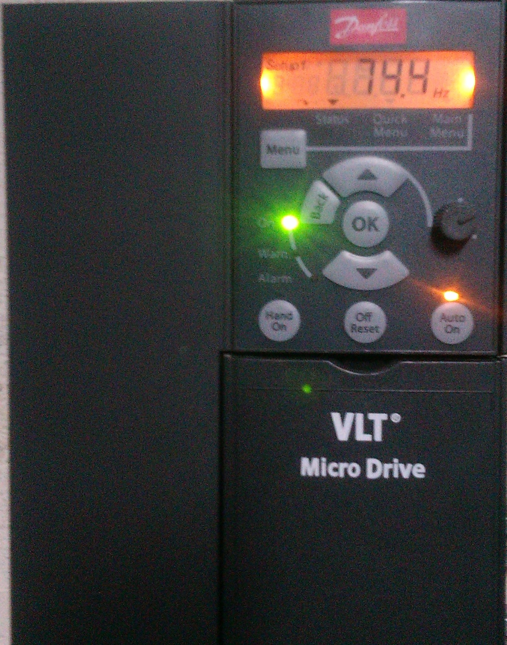

    Today I had the opportunity to correct the settings of inverters that were installed a year ago. Due to the amount of space, the designer assumed an increase in the efficiency of small fans by increasing the rotational speed.
    For example - this inverter can be ordered as single-phase 230V or three-phase 3x400V.
    In the menu, I can choose a powered motor: 3 x 230V or 3 x 400V.
    I have come across inverters that have a much wider motor rated voltage, for example from 3x230V to 3x660V.
    kisses
    - GIFT-
