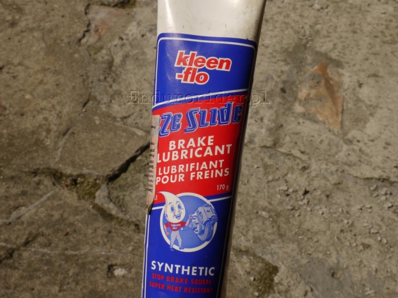

  • Silicone paste recommended for brake yoke guides
    #15 16072380
    oktawian89
    Posts: 1046
    Help: 52
    Rate: 444
    Copper and graphite greases are not suitable for brake yokes!
    The lubricants dry out over time and block the yoke guides!
    They were good as an "anti-squeak" on the back of the block!
    Only silicone paste should be used for this type of application!
    I use Kleen-Flo and I praise myself! It does the job, and that's it.
    You can also use something from the Plastilube series from ate, textara, tres etc etc, all these pastes are the same, only the print on the box is different. Except that, as I say, silicone grease definitely wins!
    For pistons and only for them! there is also the special ATE bremszylinder paste. Jsst based on some soap, a phenomenon when it comes to mounting pistons to the caliper!
    Alternatively, you can always fold a brake fluid caliper, but why are there definitely more efficient replacements?
    With such lubricated brakes, you can forget about servicing them for several years, of course when changing the brake fluid every two years, or after checking with appropriate equipment.
    So much for the topic, Regards
