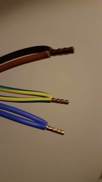

    Hello, I do not know how to connect the plug to the induction hob. Here is the socket:
    Connecting Induction Hob Plug: Properly Match Wires to Socket & Cables from Hob
    Here's the unfortunate plug:
    These are the cables coming from the induction hob, I don't know how to connect it all, please help. Thank you greetings:

    Have a colleague take a voltage tester and check which terminals of the socket are under voltage. In these places, the colleague connects the phase wires. The neutral wire should be connected to the terminal where there is no voltage (not the middle terminal), and the protective conductor to the middle terminal.

    The cables are still originally pinned together, because it can also be connected to 230 V.

    How they are "pinned" together, let a colleague elaborate on this statement. Are they electrically connected or "fastened" with clamping straps?
    Then it is a single phase board and the pin diagram is not correct for this device. In this case, the phase conductor (s) should be connected to one terminal on which there is voltage, and the rest of the conductors as in the above post :) .

    Buddy Adijos1990, you have to do as the previous speaker advised, and disconnect the brown and black wires and connect them to the plugs corresponding to the phase in the socket.
    Z-cables (not disconnected) to the center terminal, blue cables (not disconnected) to the terminal corresponding to N in the socket.
    Finally, you sign a guarantee with a certificate of professional qualifications for a possible complaint.

    On the other side of the sticker there is a diagram to be connected to 230V. I have a separate 230/400 fuse for induction and a special socket.
