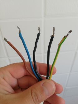

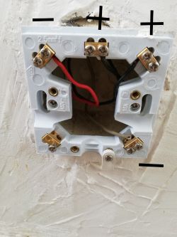

    Hello, I have a problem with connecting the oven and induction hobs to strength and I would like to ask for help. Below I attach pictures, on the last photo I marked the plus wire where the current is. Thank you in advance and best regards

    Dziki149 wrote:
    on the last photo I marked the plus cable where the current is.

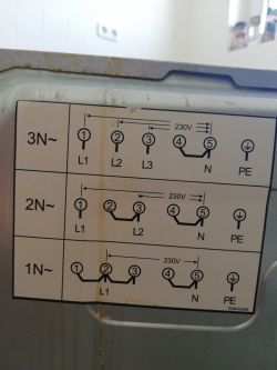

    So you don't have "typical strength", no third phase.
    The connection should look like the "2N" diagram
    Connection should be made by a person with permissions. :cry:
