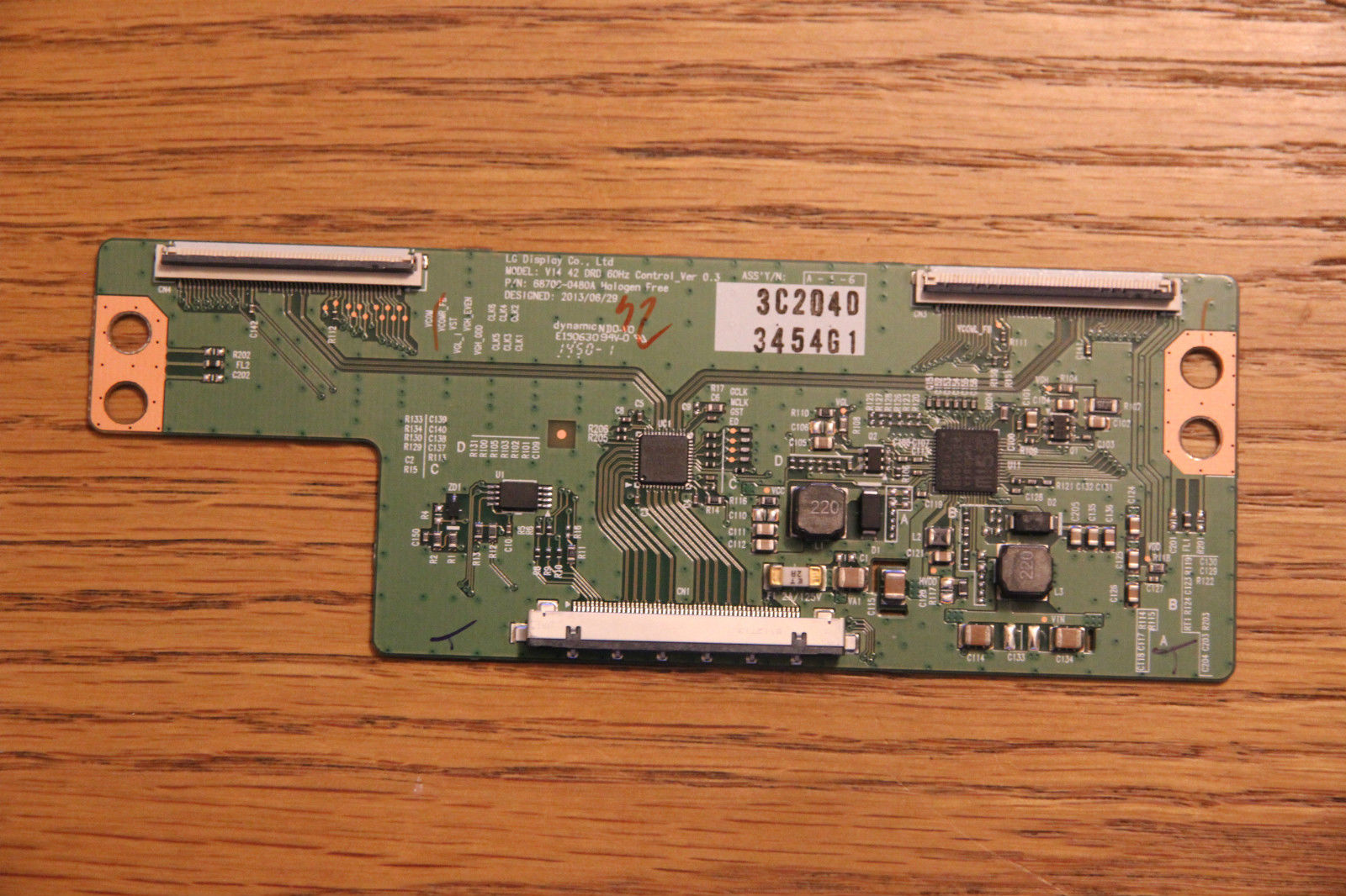

    For me, this model was on the main album described as
    MAIN BOARD
    pcb: EAX65361503 (1.0) / EAX65361505 (1.0) >>> EBT62973012, chassis LD44B for LG 42LB5500
    * also used on pcb: Eax65359104 (1.1)
    T-con 6870C-0480A
    LG 42LB5500 TV Not Turning On: Status Light Blinks Twice, Power Supply Voltages Compliant
    SM for this chassis is poor, I will tomorrow (see if there is no forum)
    - extended by the Repair process (additional 14 pages with, for example, fault algorithms)

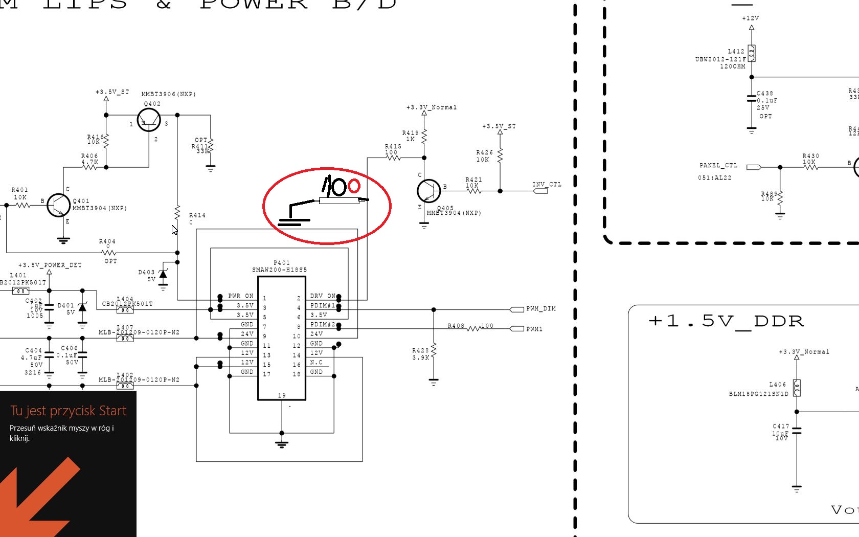

    I managed to determine that there is definitely no backlight. Does anyone have this schematic of the power supply?
    Added after 32 [minutes]:
    shorting the DrvON through the resistor to the ground showed the voltage at the pins for backlight oscillates between 130-190 V. But ledy still do not shine. I wonder if it is necessary to bring a PWM signal. LG 42LB5500 TV Not Turning On: Status Light Blinks Twice, Power Supply Voltages Compliant
    • LG 42LB5500 TV Not Turning On: Status Light Blinks Twice, Power Supply Voltages Compliant ddd.jpg (202.37 KB) You must be logged in to download this attachment.

    Awdek wrote:
    shorting the DrvON through the resistor to the ground showed the voltage at the pins for backlight oscillates in the range of 130-190 V. But ledy still do not shine.
    hmm no, I think you have an answer ... or not.
    Is something standing in the way and to check Ledy?
