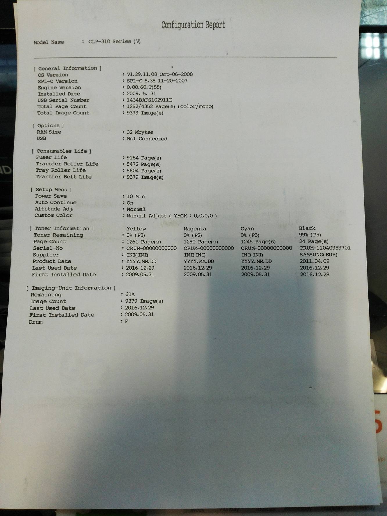

    I have a Samsung CLP 315 color laser printer (customer equipment). The machine is dirty while printing. Dirty in different colors. I have two sets of toners. I changed it, there is no difference so I can eliminate the toners. Drum oem 40% consumption. The toner powder remains on the foil. I am asking for suggestions whether the drum or the transfer belt is to blame for this condition?

    And, in my opinion, the foil of the belt is fed up, and the belt is fed up, and the toners are probably also shabby (or the drum with the electrode is working wrong with it)! Why do I suppose so? Look at the prints:
    a. the one with dark waves and smudges
    - toner, something wrong with magnetic properties or with gradation
    b.Now the one with the yellow belt (from a sudden puncture of the Y module?)
    - something wrong with the Y bias or the potential that pierces the drum matrix. Or the electrode has punctures or something wrong with color toners?
    Is it reasonably good to print only a black image?
