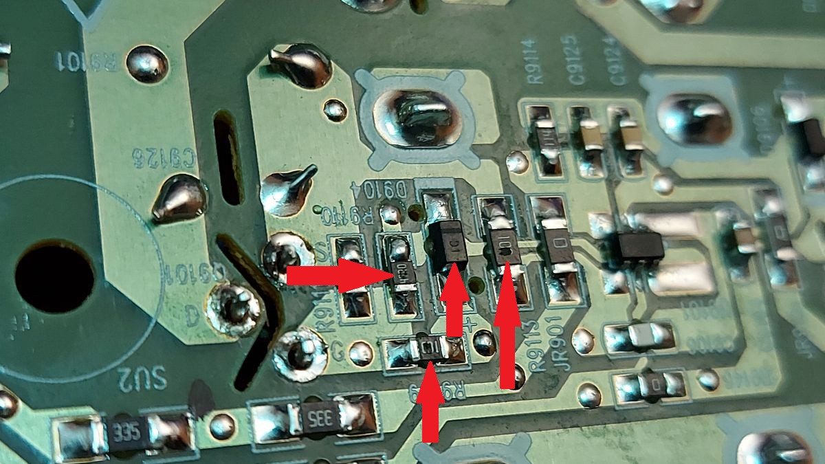

    Good morning
    This TV has the 715G7734-P01-005-002H TPV power supply
    elements are fired - transistor Q9101, U9101, C9126, R9101, R9109, D9104.
    I am asking for a diagram or identification of damaged elements.
    I found a working power supply that looks identical from the photo, except for the color of the power socket with the symbol 715G7734-P02-005-002H TPV from a 32pht4132 TV. Are these similar power supplies?
    Please let me know.

    PIOTREL wrote:
    Unfortunately it is not the same.
    Which element is not the same? There may be suggestions.
    Which item is not the same? There may be suggestions.

    C9126 is not for TV 32 ", it is only for larger ones and has different capacities, T9001 is 22 or 27ohm. U9101 is also 6 and 8 pin version.
    It is not a reliable method. If there is a C9126 replace it with 100pF 2KV.
    PF6005-SOT-26
    This is not a foolproof method. If it is C9126, replace it with 100pF 2KV.
    • Philips 32PHT4032 - Damaged power supply 715G7734-P01-005-002H pf6005.jpg (51.76 KB) You must be logged in to download this attachment.

    PIOTREL wrote:
    I meant R9001 22 or 27 Ohm
    That it is not a fault in the resistor mark? Where is it? R9101 you think?
    That it is not a resistor mark fault? Where it is? R9101 do you think?

    PIOTREL wrote:
    This resistor is also damaged, as are the listed elements.
    What a coincidence, on Saturday I took out the same power supply, of course, it was more practical, the same as for you, a mosfet, a resistor and a capacitor, 4 years and a pad. Write that he is from WLKP ;)
  • #13 18617799
    badael
    Posts: 553
    Help: 137
    Rate: 215
    C9126 is the main culprit. Solder like this.
    C9126 is the main culprit. Yes soldered.

    cysiekw wrote:
    Yes, I am from WLKP
    You are right, the culprit is the replaced capacitor, as in the LG 32LN540 model

  • Questioning fuse placement and C9126 voltage upgrade
    #19 20880855
    blaadee man
    Posts: 190
    Rate: 34
    Hello, For all those following, the topic is not closed. Ultimately, I wanted to find out where, after repairing such a power supply, it would be worth inserting an additional fuse (because the original one did not work, whether in parallel with the C9126 capacitor, or immediately at the output of the transformer supplying power to the entire system that fails) so that there would be no repeat in about 2 years+, or whether changing the capacitor in the original C9126 100pf power supply without repairs from 1KV to 2KV will do anything, or is this a defect that is designed so that after some time the TV has been working, it must be fixed, because these are all similar Philips power supplies that fail in the same way and are even repair kits :) ?
    Damaged component on a circuit board with capacitors and a resistor. Close-up of a printed circuit board with electronic components, including capacitors and copper traces. Close-up of a circuit board with visible capacitors and resistors.

    The photo shows damaged elements, have they been replaced? The power supply driver may also be damaged.
    • Philips 32PHT4032 - Damaged power supply 715G7734-P01-005-002H Zasilacz 001_1.jpg (204.86 KB) You must be logged in to download this attachment.
  • #25 21049465
    Syberek
    Posts: 125
    Help: 18
    Rate: 10
    I didn`t replace them because both the diode and resistors have the right value. If the controller was damaged, would voltages appear at all?
  • #26 21049478
    Wojtek M
    Posts: 3692
    Help: 520
    Rate: 1125
    You can clearly see "fires" on them (not on the diode), but if there are such effects, everything needs to be replaced, probably the controller, and the optocoupler should also be checked. The measurement of elements is only reliable after desoldering.
