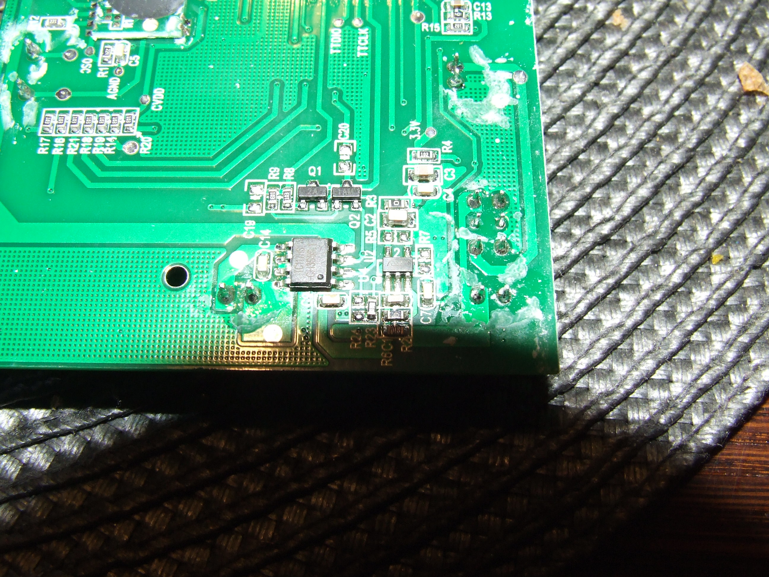

    I have a problem with the Cyber Robot Clementoni toy, the toy does not work and there is one element missing on the disc. Maybe someone from forum members has such a toy and could check for me what element it is and what parameters?

    Here you are: Missing PCB Element in Cyber Robot Clementoni Toy - Seeking Identification & Parameters Missing PCB Element in Cyber Robot Clementoni Toy - Seeking Identification & Parameters Missing PCB Element in Cyber Robot Clementoni Toy - Seeking Identification & Parameters

    you could give what is the number on this resistor-ku because in the picture you can not see too much

    C19 capacitor C smd near the transistor, insert the same as you have on the top left near the transistor. C20 15 pico ttl line, this one is not necessary, in some cases it is necessary where the resonator works. Edit is not better than the line. C20 is the same copy goes out of the transistor.
    R7? resistor I do not know what kind of circuit it is, you can read it, you need to find a dataschet or some scheme in googole from a typical application for it, I would do that.
