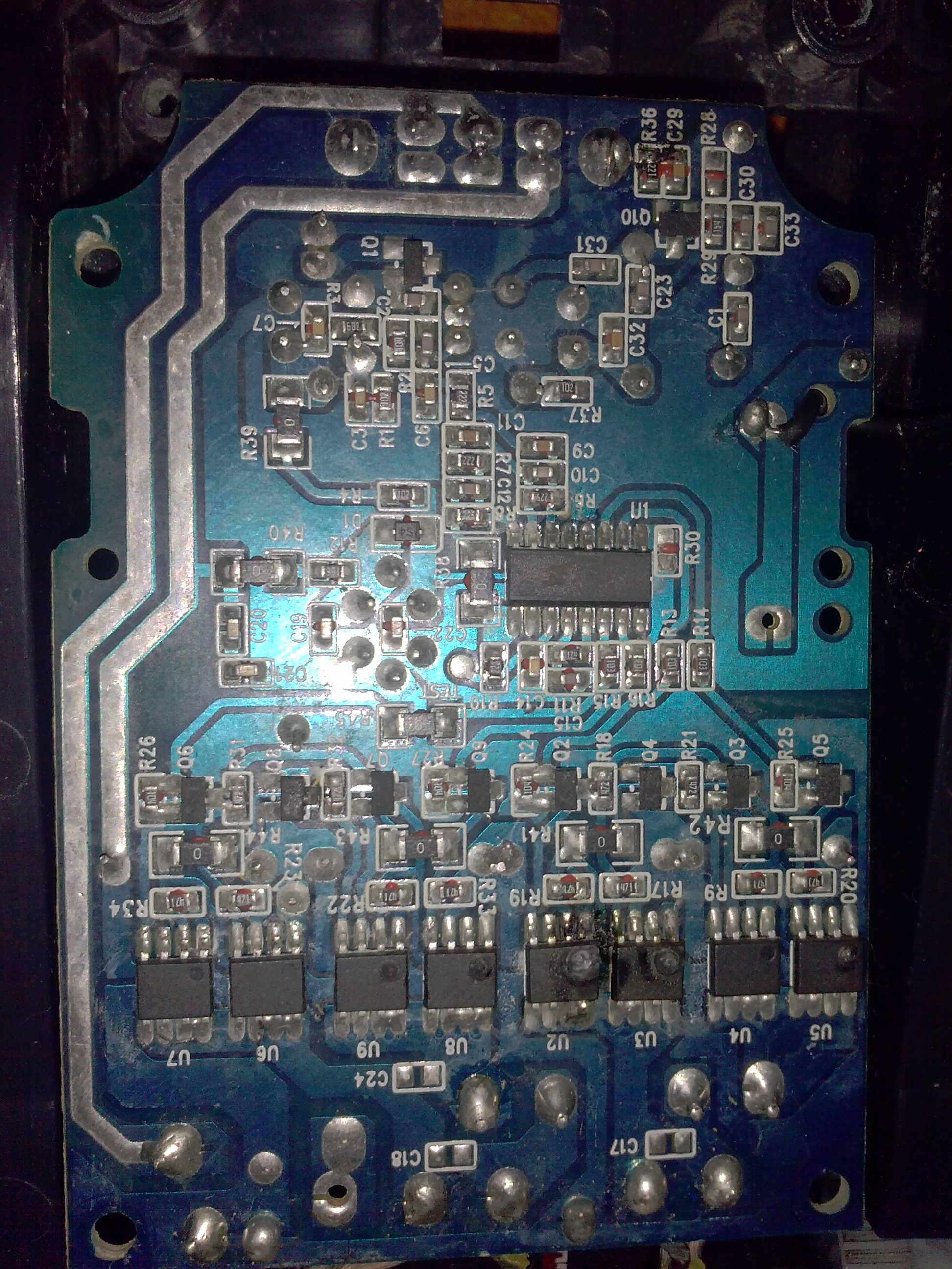

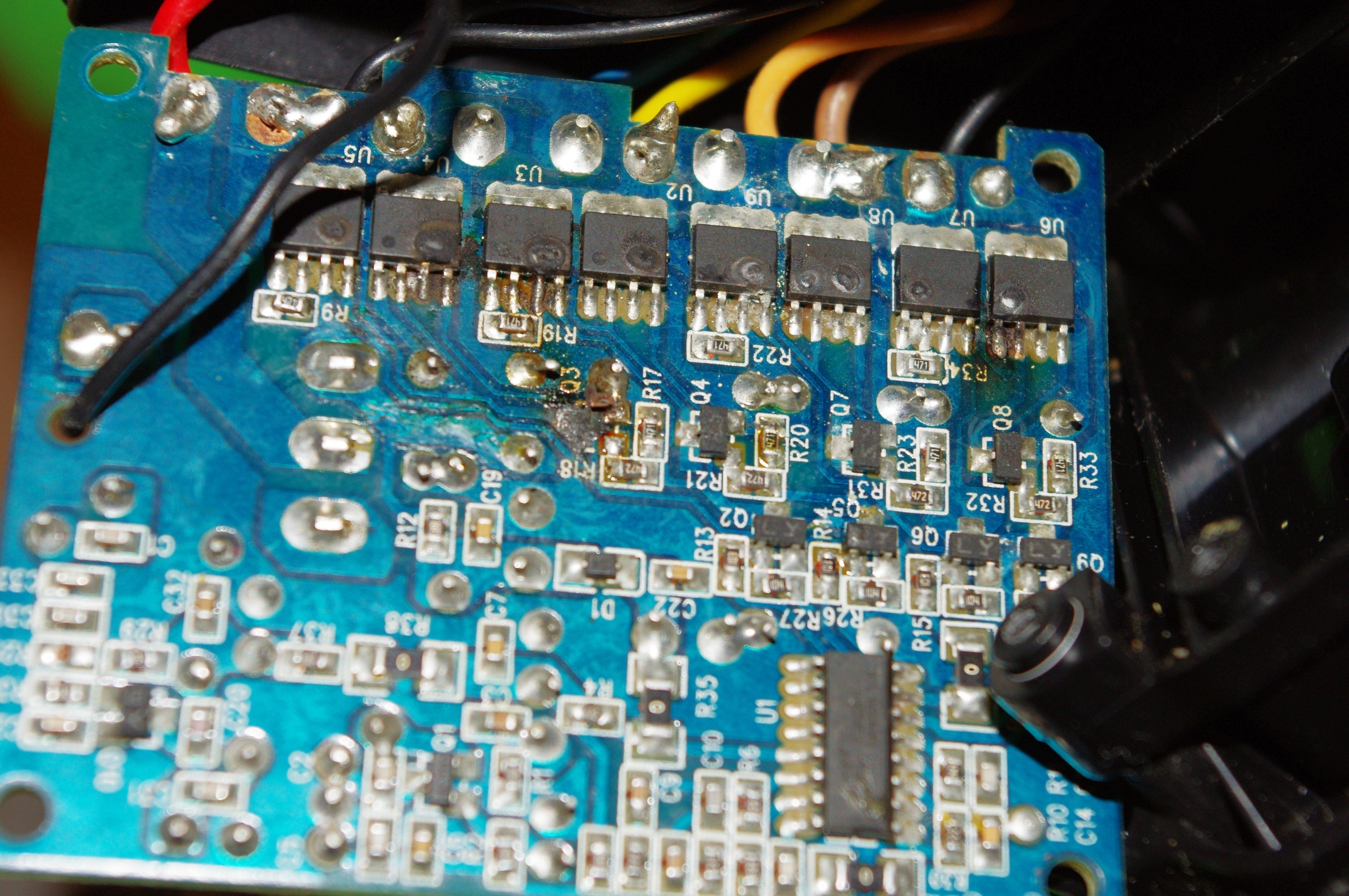

    I have a broken Bandai Cyclaws r/c car, the integrated circuits (?) marked 2M04 ASQ were burned in it, there are 8 of them on the board.
    Unfortunately, I cannot find its datasheet, I would like to ask for help in finding a replacement or I would be happy to buy the above-mentioned elements.
    Burnt elements are rather easy to locate ;)

    Hello - these are probably SMD Mosfets. Please post a photo of the damaged board.

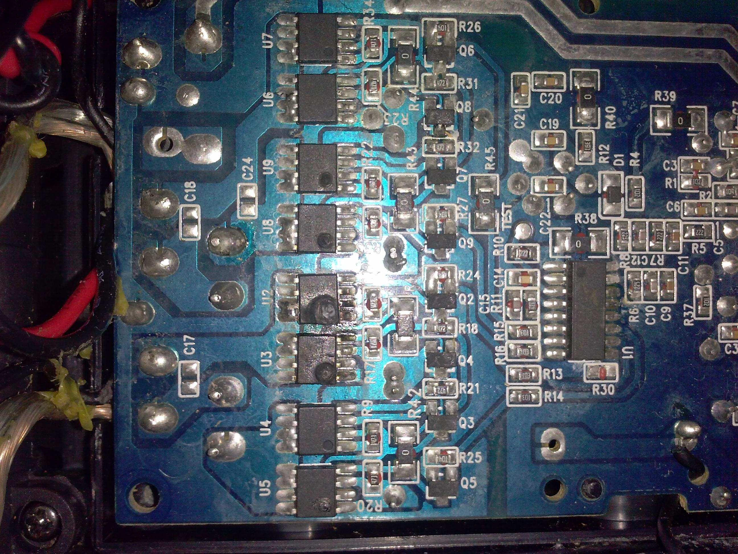

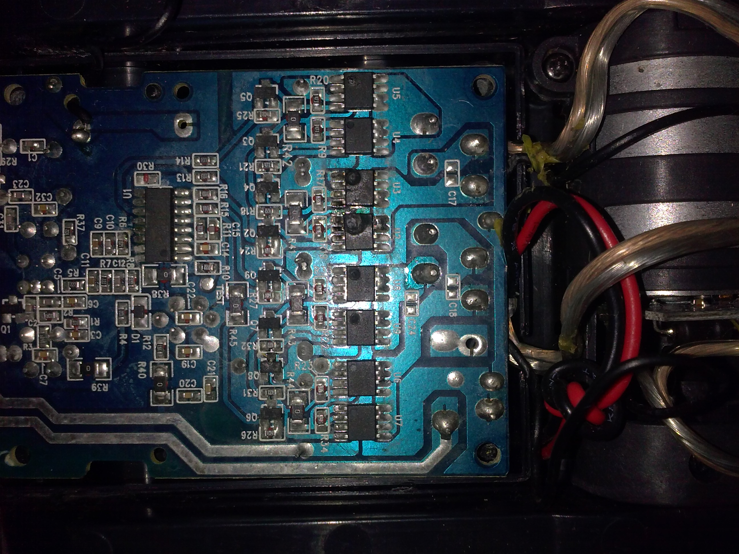

    Hello - based on the photo, I am convinced that these are double N/P Mosfets.

    As a replacement element, you could use - FDS8958 - available for purchase here

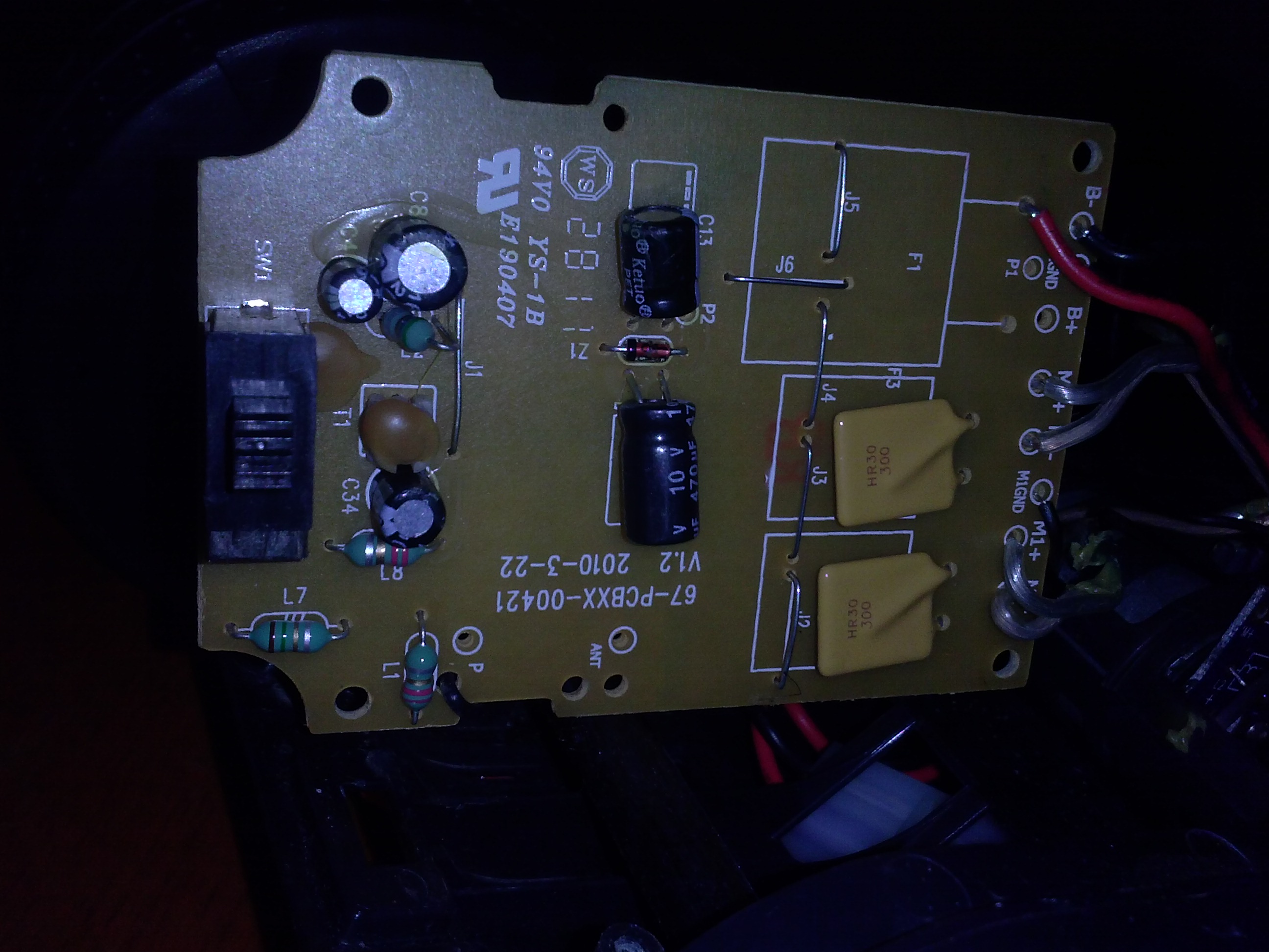

    Can you post a photo of the reverse side of the tile? Seeking Replacement for Burned 2M04 ASQ Integrated Circuits in Bandai Cyclaws R/C Car

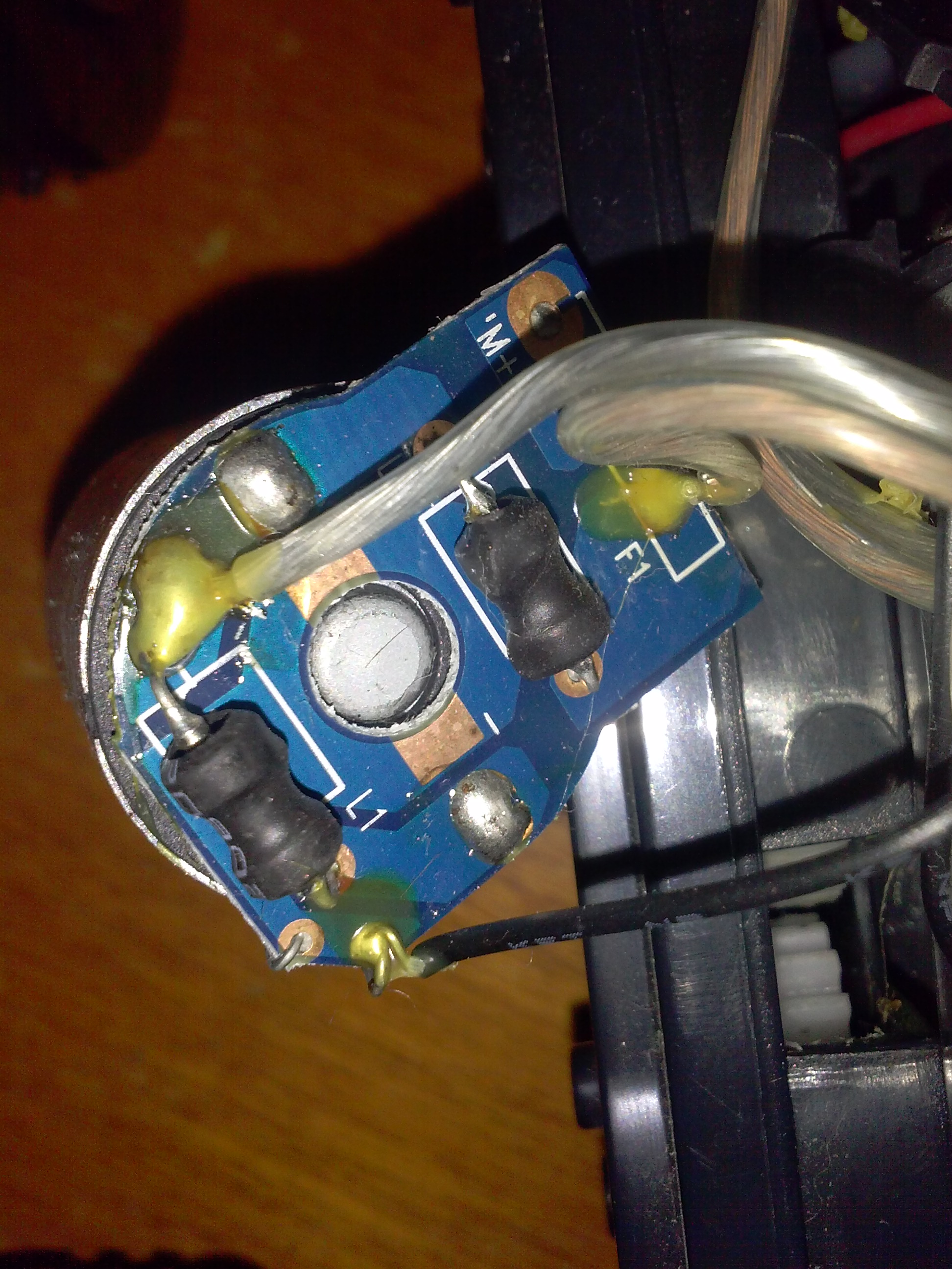

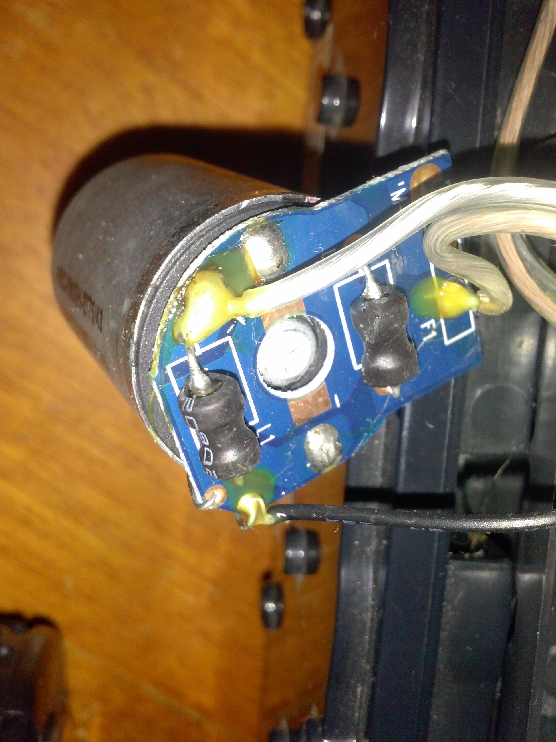

    Hello - these elements are damaged - you can see in the photo. What worries me more is what happened
    the reason why so many elements were damaged. Was the car pushed too hard?
    Maybe the brushes in the motors are wearing out - you should check this before soldering
    new elements appear.

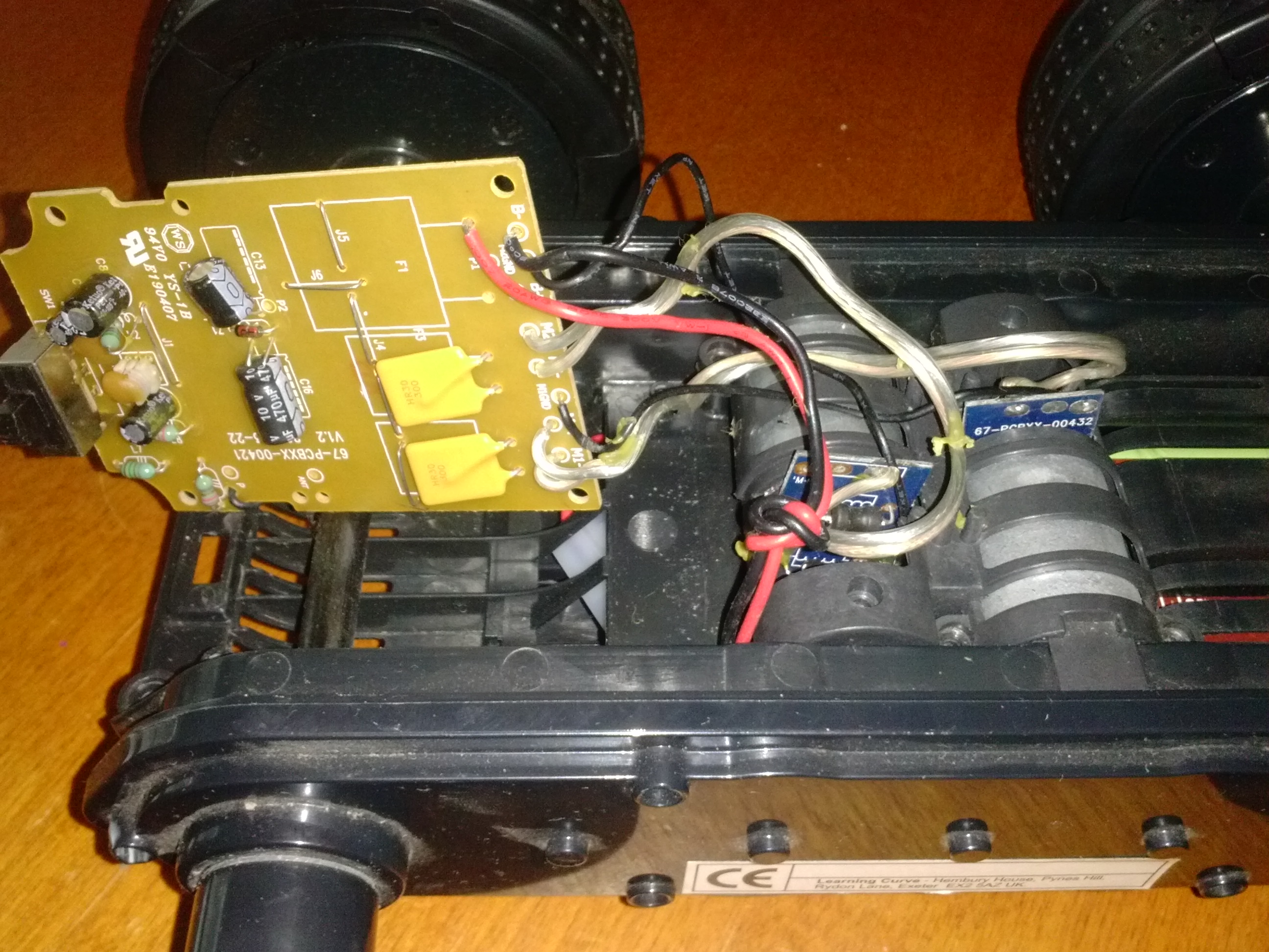

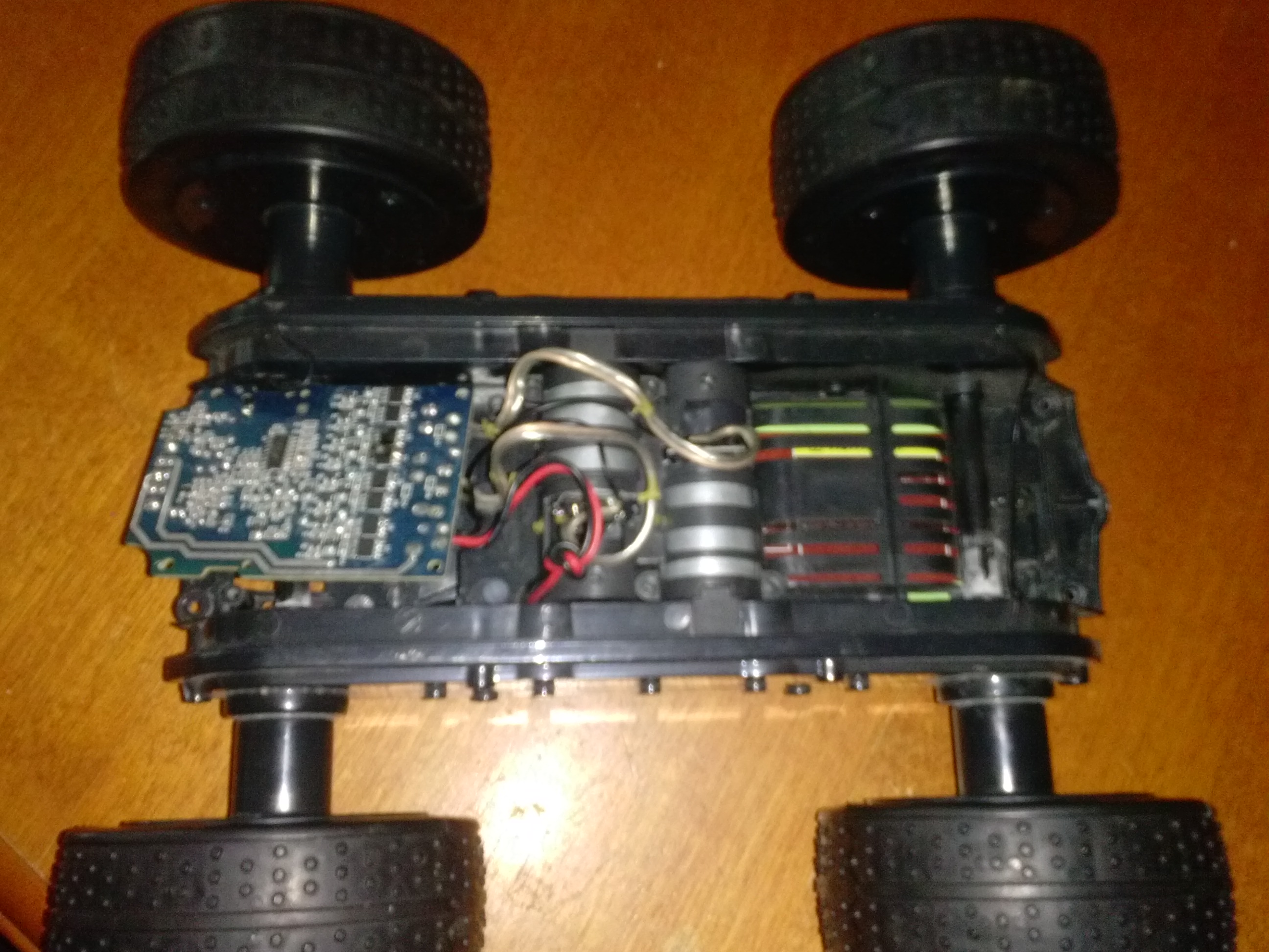

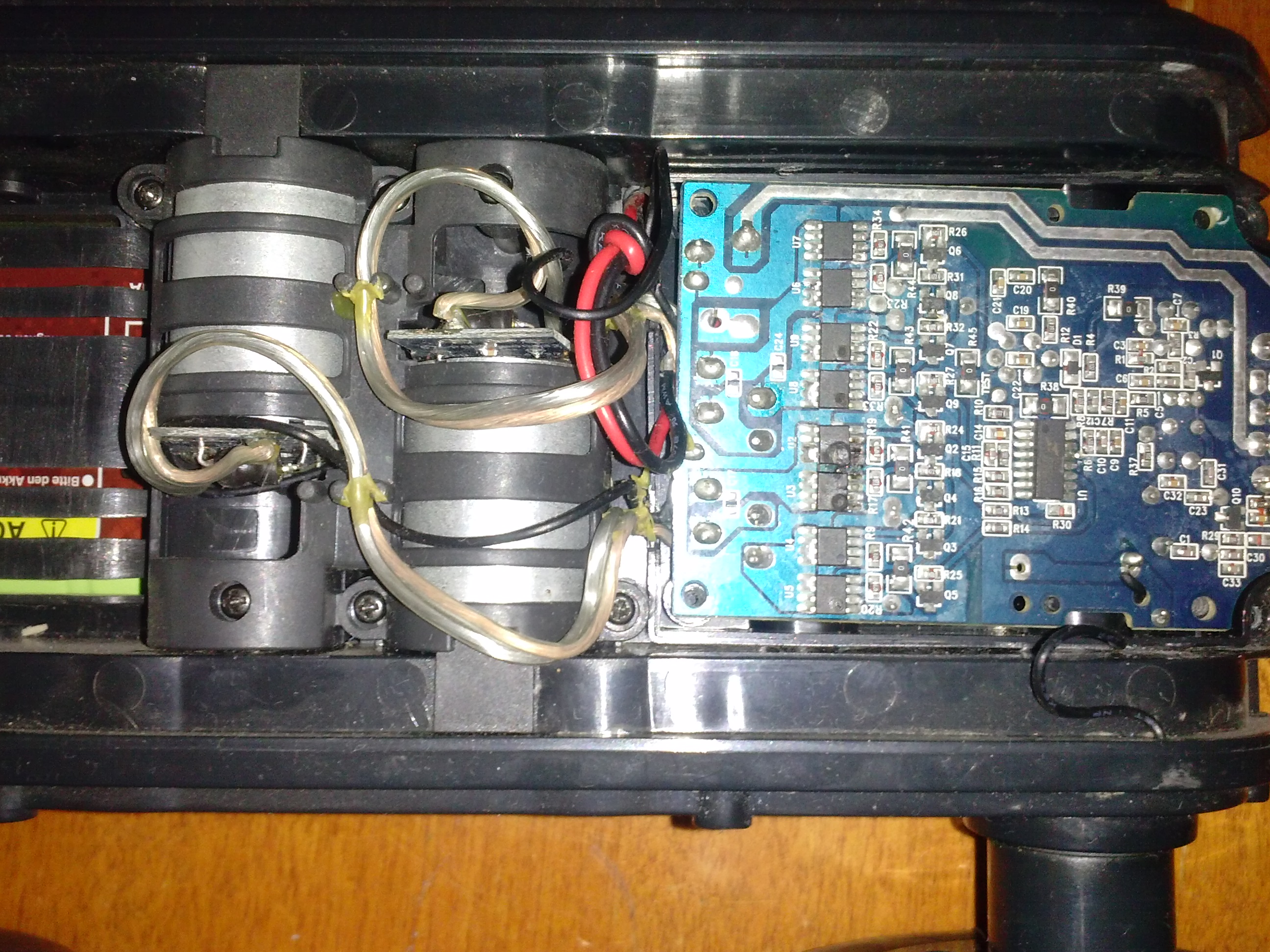

    Generally, the car was used in a room on panels and the right drive side was weaker than the left (steering like a tracked vehicle) so it was spinning to the right, so I opened it and started it to see if something was burning and then the left mosfet burned (looking from the bottom of the board). (engines at the top) and the right drive side stopped permanently. It seemed to me that it was the fault of burnt mosfets. The previous owner certainly used the toy in the field.
    Today I'm coming back from the trip, I'll take detailed photos of all the electronics and engines and post them here or send them to your e-mail.
    Regards
    I'm sorry it's only now, but I just got back from the tour. Promised photos below;
    Seeking Replacement for Burned 2M04 ASQ Integrated Circuits in Bandai Cyclaws R/C Car Seeking Replacement for Burned 2M04 ASQ Integrated Circuits in Bandai Cyclaws R/C Car Seeking Replacement for Burned 2M04 ASQ Integrated Circuits in Bandai Cyclaws R/C Car Seeking Replacement for Burned 2M04 ASQ Integrated Circuits in Bandai Cyclaws R/C Car Seeking Replacement for Burned 2M04 ASQ Integrated Circuits in Bandai Cyclaws R/C Car Seeking Replacement for Burned 2M04 ASQ Integrated Circuits in Bandai Cyclaws R/C Car Seeking Replacement for Burned 2M04 ASQ Integrated Circuits in Bandai Cyclaws R/C Car Seeking Replacement for Burned 2M04 ASQ Integrated Circuits in Bandai Cyclaws R/C Car

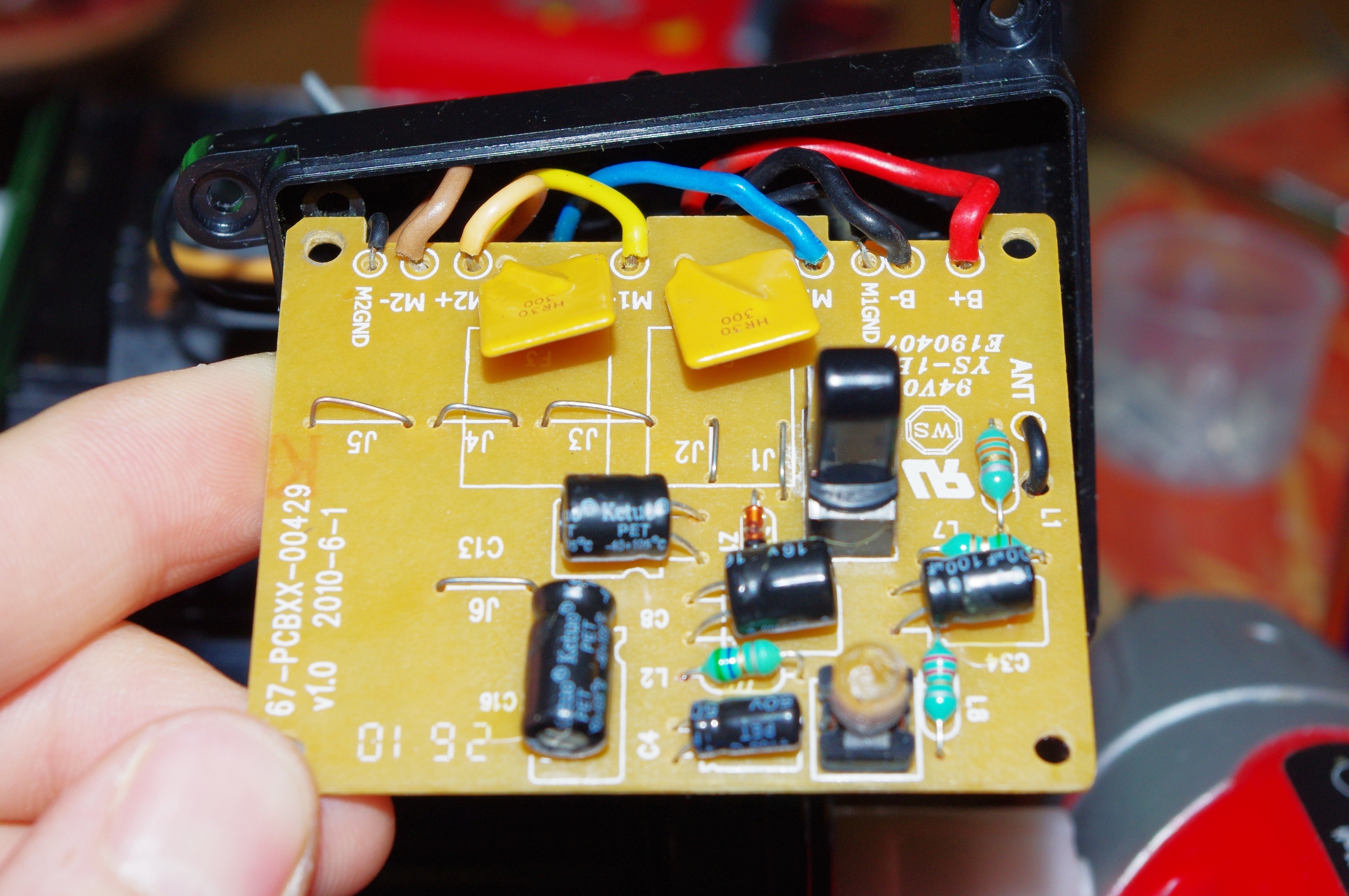

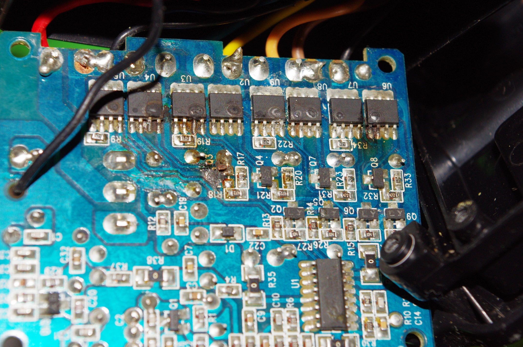

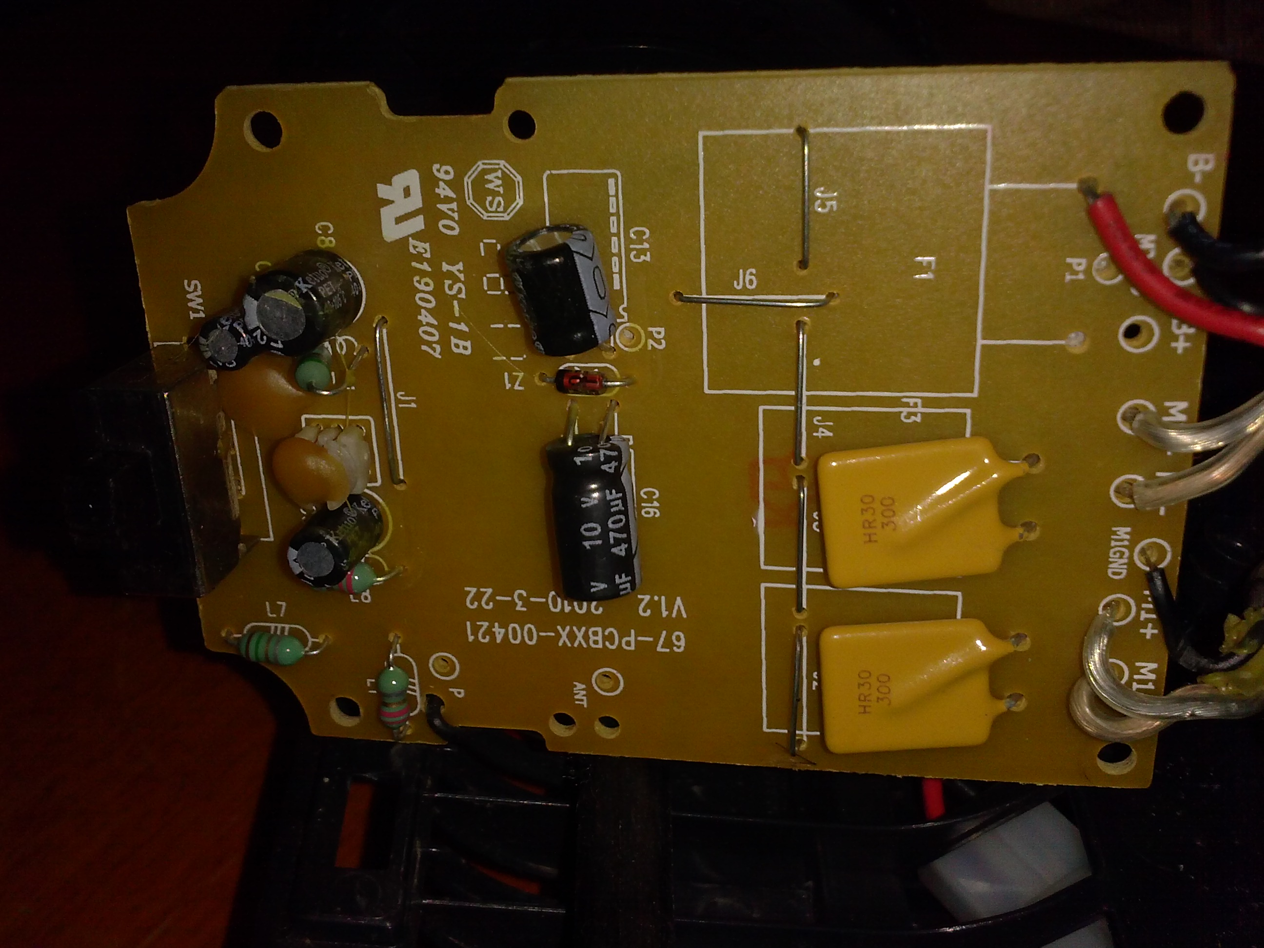

    I have the same problem as my friend, but in another RC vehicle (JLX, green pumped wheels) powered by a 9.6V pack. I bought the car already damaged. I am posting photos below, maybe they will add something to the topic. As for the excessive load, I rather think it is simply a manufacturing defect because, for example, in my vehicle it is quite common from what I found out.
