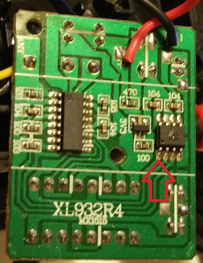

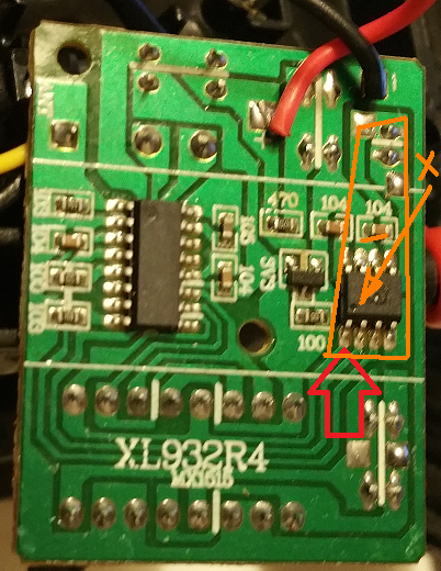

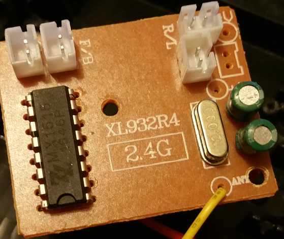

    This item worked in a cheap radio controlled toy (Monster Truck from China). A friend connected a more powerful battery and burned the system.
    The circuit board is about 40x32 mm, the elements are on both sides.
    The power supply is a set of 4.8V rechargeable batteries. The original battery capacity is 700 mAh, and ultimately 2600 mAh.
    I was able to find very little about the burnt element - some markings are invisible.
    It's probably a layout like this page:
    www yoycart com/Product/42747566143
    or
    pl aliexpress com/store/product/Free-shipping-10pcs-MX08-DC-motor-driver-chip-SOP-8/1980358_32675130315 html
    I tried to take better pictures but I don't have a good enough camera:
    ] Identifying and Replacing Burnt SMD in MX08 Monster Truck RC Toy from China

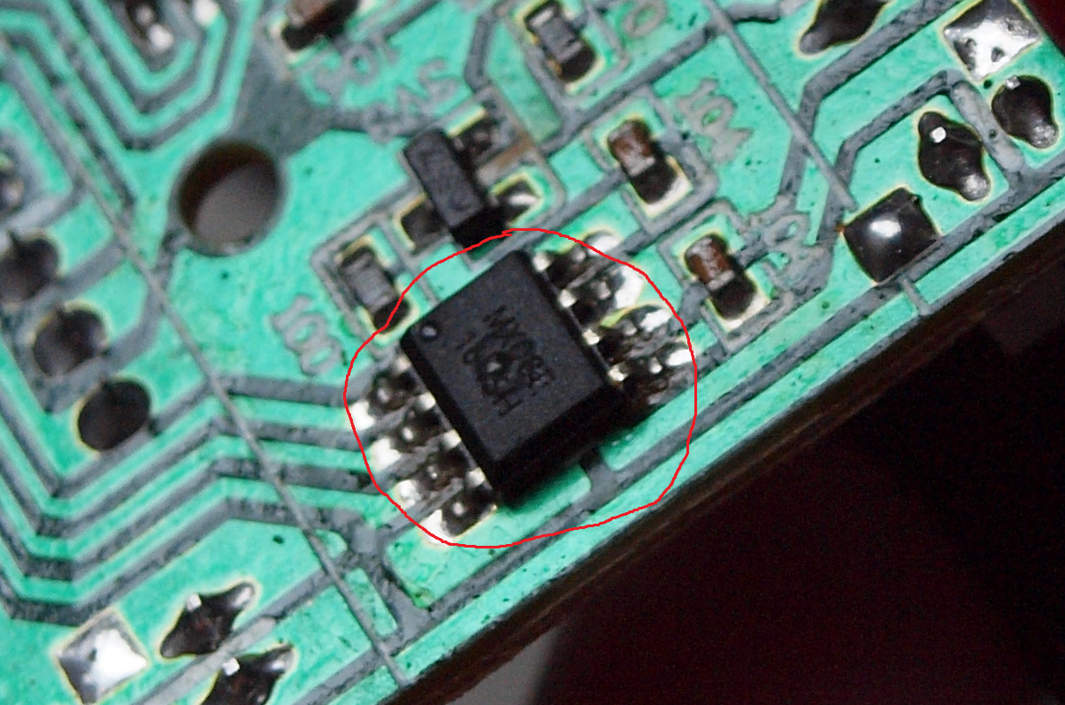

    #5 16818807
    wojtek 9007
    Level 40  
    Posts: 3939
    Help: 711
    Rate: 844
    Board Language: polish
    Hello - this is an H-bridge in one IC - similar to the L9110 system.
    Please desolder the damaged one and take a photo, it will be possible to determine it more.
    Of course, a photo of the board. This L9110 is for sale.

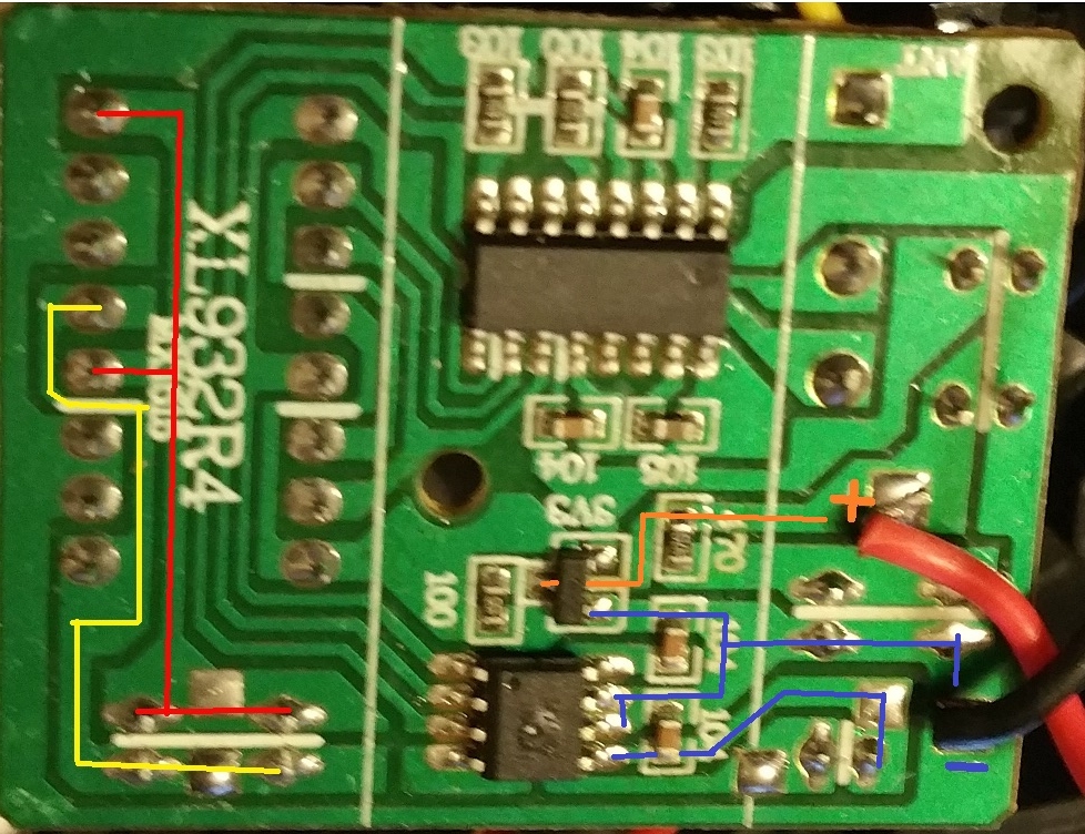

    kil0F
    Posts: 7
    I confirm that the function provided by Wojtek makes the most sense. There are 3 engines in this car. Two for driving forward and backward and one for turning left and right. The part of the engine control system for turning left and right has gone out. the other engines are working properly.
    So it is highly probable (as Feynman used to say) that it is the H-bridge.
    Perhaps it is a specific variation of this bridge because it supports up to 3 motors (two of them have common + and - so we can treat them as one because they are connected in parallel):
    I dug up another post, also from the electrode, regarding the identical system - sorry, but it didn't occur to me that someone would give the full name of the tile:
    https://www.elektroda.pl/rtvforum/topic3252443.html

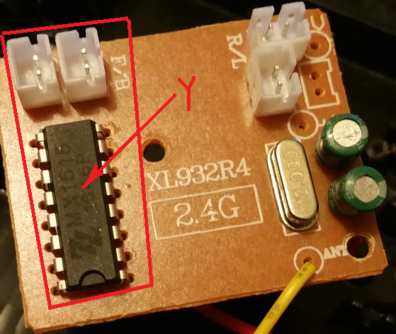

    Hello - the MX1515 system - it is a double bridge;
    http://www.datasheetspdf.com/PDF/MX1515/909509/2
    It drives two motors marked Y.
    The MX08 system drives one motor marked X.
    Added after 4 [minutes]:
    Added after 31 [seconds]:

    kil0F
    Posts: 7
    Thank you for your suggestions. I'll try to desolder the chip and see what's underneath.

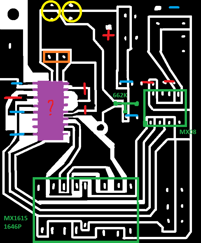

  • #16 16833460
    kil0F
    Posts: 7
    yellow are capacitors,
    the voltage connection is + and -,
    orange is silver something
    green are two chips,
    purple - without any markings,
    blue are probably capacitors again,
    the red ones are more resistances

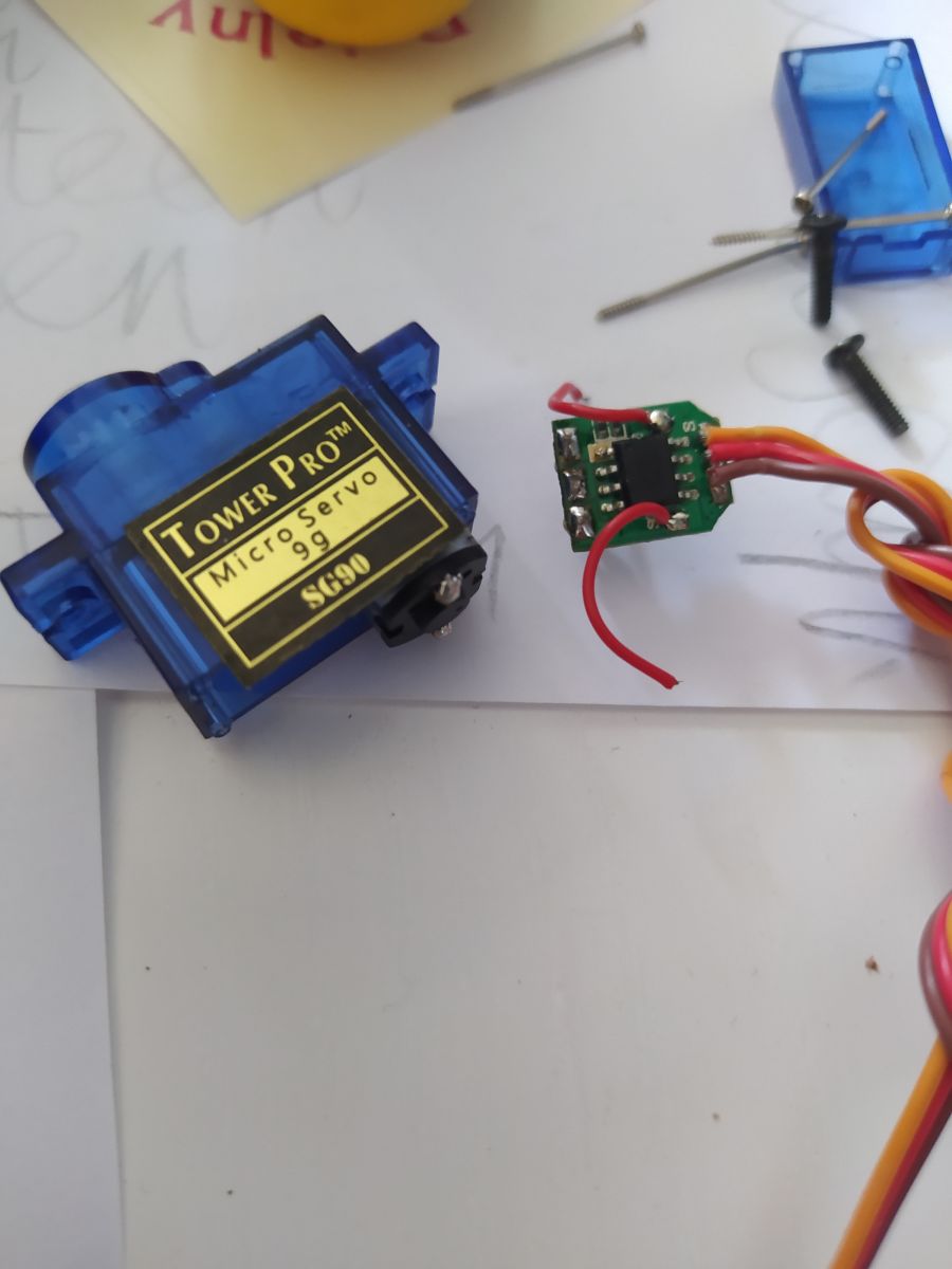

  • #20 20234282
    kowal011
    Level 22  
    Posts: 463
    Help: 21
    Rate: 266
    Identifying and Replacing Burnt SMD in MX08 Monster Truck RC Toy from China The scaler is present in the SG-90 modeling servos.
