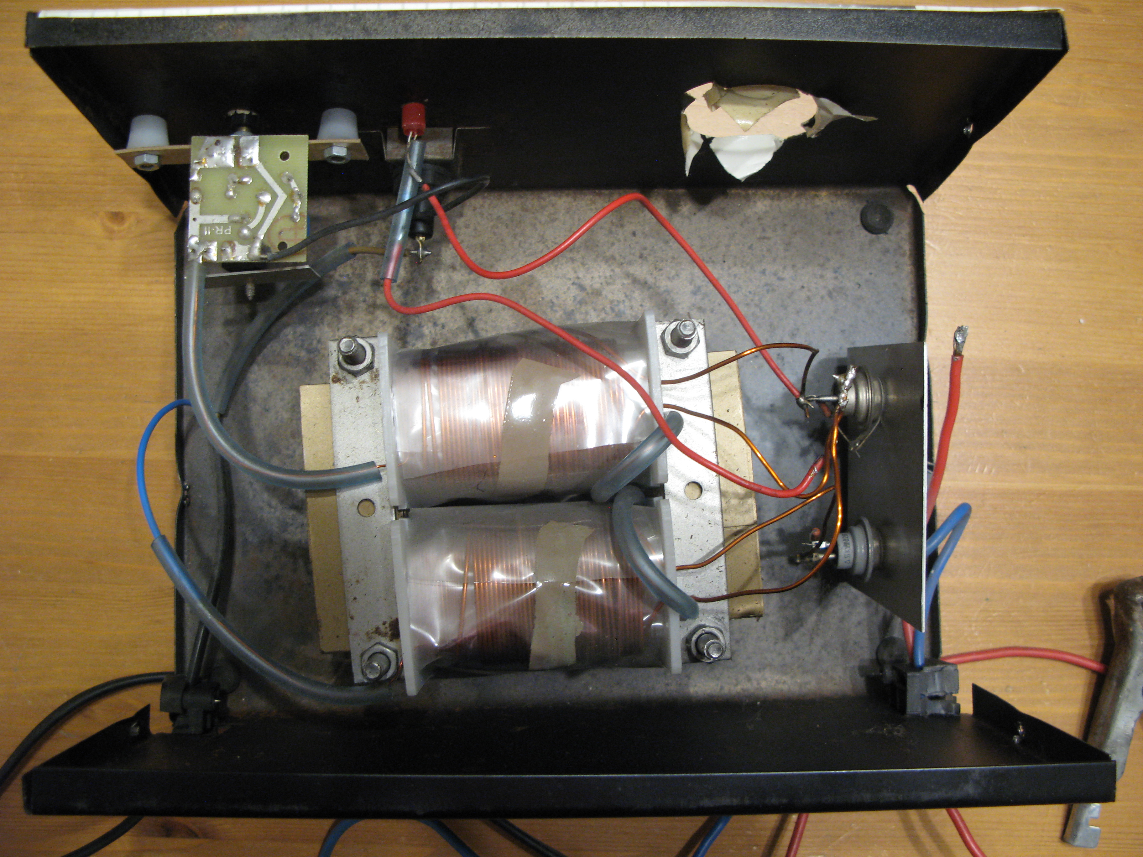

    I would like to improve my ROMSTAN BP12 / 15 rectifier. First of all, I need to replace the ammeter, because the original tip dropped out, by the way I would be tempted to add a voltmeter. Hence my first questions:
    - with what range should you choose an ammeter - up to 5, 8, 10 or 15A?
    - with what range should you choose a voltmeter - up to 15 or 20V?
    The charger is to be used to charge car batteries up to 100Ah, but it will be in the range of 40-80Ah.
    How much can A get out of this transformer? Leave the original adjustment or replace / modify it? Leave the diodes or try to mount the rectifier bridge (some heat sink from the old computer will be found)? Maybe add some protection, although always before connecting the charger to the network, I connect the clamps to the battery terminals and only then turn on the power.

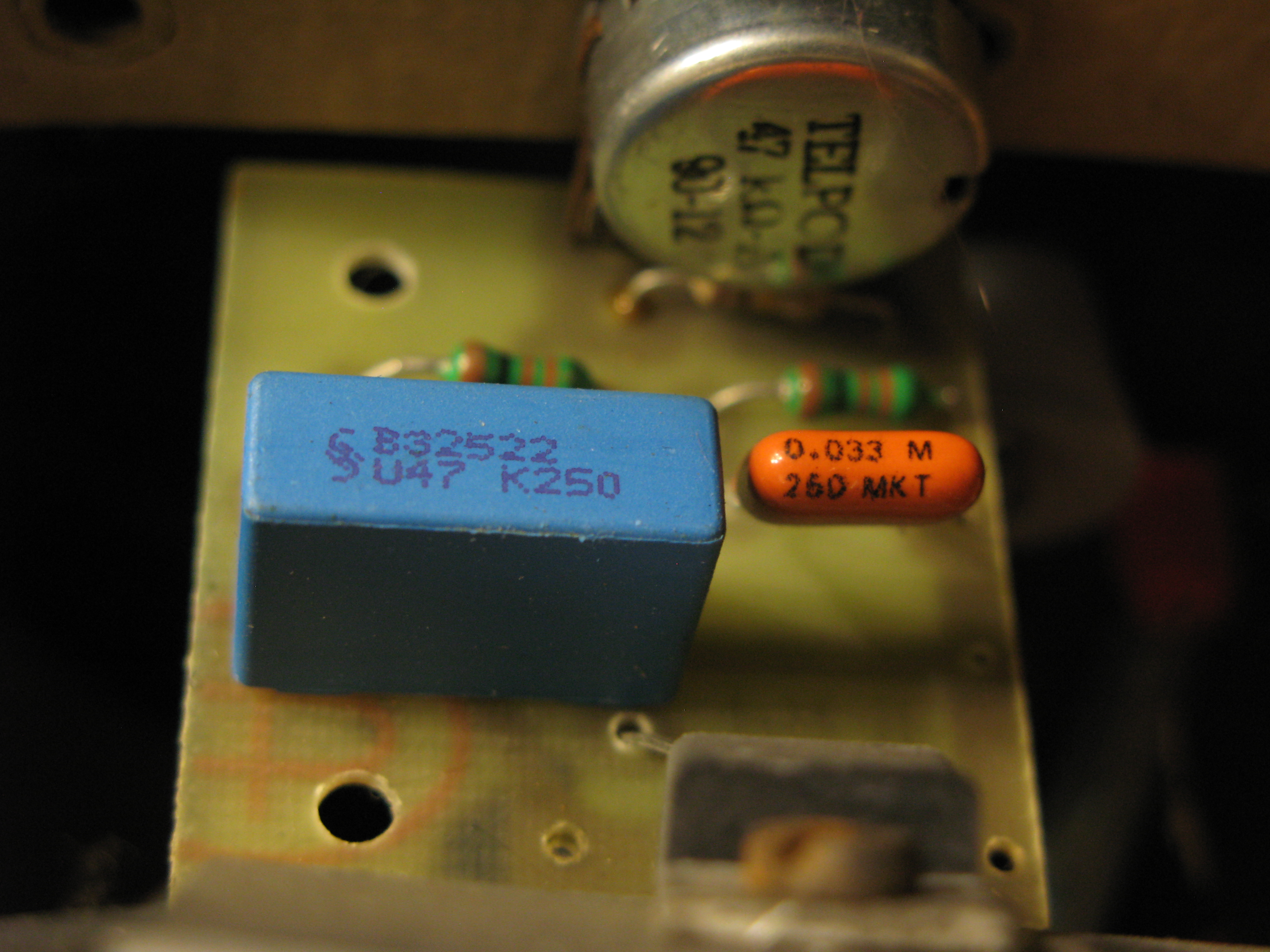

    Here are photos of my rectifier:

    If the rectifier is at 15A, then mount such an ammeter as for the voltmeter, then 15V should be suitable. From what I can see this system is implemented on a thyristor plus a power diode.

    What ??? What nonsense :D Because here I see the regulation on triac in the primary circuit - typical and a full-wave secondary circuit on two diodes. Not much to improve here, apart from the addition of measuring instruments - an ammeter - necessary, a voltmeter as ..... additional.

    This transformer will be hot already at the 5A charging current. LCD or LED indicators need their own power supply, so again an additional transformer and power supply .... According to me, it is enough to install a new 15A ammeter, e.g. DH-50 2153 and as an additional voltmeter. Why, it is important to charge the battery when charging the battery the charging current and the voltmeter only shows the voltage at the terminals of the battery being charged, and these increase as the charging time passes. Oh, because I can't see clearly where the rectifier diodes are? Because I see for sure one BT type thyristor or rather Russian KU and the other element, which can be a 10A diode but it can also be a thyristor. I would like to have a diagram of this interesting system.

    'Someone has already processed, two Russian thyristors stuck in, with gates shorted resistors - they work as ordinary diodes. I would dump it all and buy a real rectifier.
    Both elements are KY202B :D

    It's trash, built massively at minimal cost. Neither durable nor economical.
