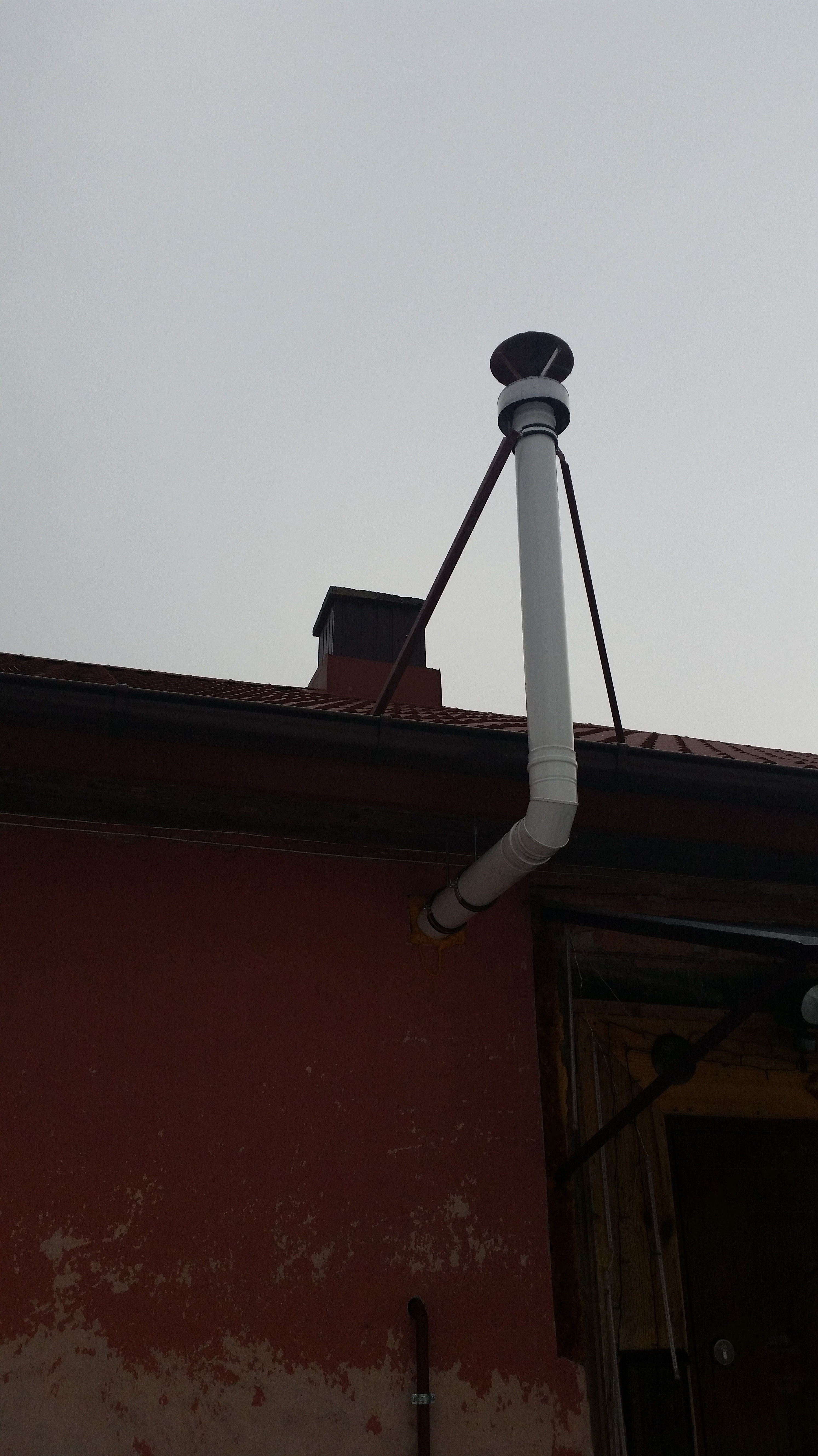

    I am looking for help with a common error on the stove (as in the topic). The worst part is that this error most often occurs at night when no one can get up and reset the stove. The apartment gets cold, because this error prevents the stove from being re-ignited, the pump runs all the time and there is no flame and no hot radiators. Is there any possibility for this error to be automatically removed / ignored / reset by the furnace?
    I look forward to hearing your reply.

  • #6 16212821
    Annl
    Posts: 11
    Rate: 10
    The service technician said that the reason may be a freezing chimney, that the steam condenses at night and when it is frosty, the chimney freezes and the stove does not have enough air to start it. Do you know ways to keep the chimney from freezing?
  • #8 16285345
    Annl
    Posts: 11
    Rate: 10
    However, probably the chimney's fault, the frosts are over, the stove is functioning normally. Now just find a solution for the next winter. Anyone have any idea?

  • #9 16701739
    Annl
    Posts: 11
    Rate: 10
    Hello. I am writing how I solved the problem. The fault was on the side of the electrode, which the service technician replaced with a new one.
