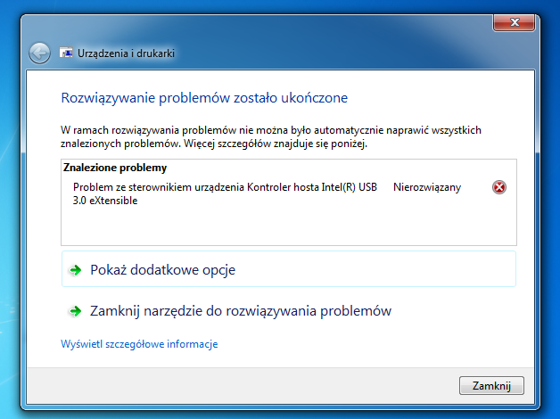

    Description of the problem:
    About 4 months ago, at some point, the USB 3.0 ports on the Lenovo G500 laptop stopped working properly. They give power, the LED on the external drive. is on but does not see the device, also does not see a wireless mouse, flash drives etc. After booting Linux from the flash drive, the problem does not disappear, the system still does not see anything.
    In the device manager, it displays next to the driver the message Device status: "This device cannot be started. (Code 10)"
    Uninstalling and reinstalling the driver does nothing, after restarting the computer the problem returns.
    I tried to fix the problem like this:

    Installing drivers from the manufacturer's website does not solve the problem?
  • #3 16181110
    Souls21998
    Maybe you have non-original drivers?

    Use Link_usb_ support from Microsoft
    Another option, as Lenovo writes
    Shutdown the machine, remove the battery and unplug the AC adapter then hold the power button for 20secs (this drains any electric charge that's left on the machine).
    When finished, plug-in the AC adapter and turn on the machine then hit F2 to boot into the BIOS. Once In the BIOS, hit F9 to load default settings then hit F10 to save and exit (this resets the hardware configuration of the machine to default).
    - min. Link_support Lenovo
    If it doesn't help, you need to see what version. mb and depending on where the signal from usb3.o (PCH or ..) is sent, this element is damaged!
    - look carefully at the Usb3.0 sockets for a short circuit, about what and how I wrote last week
    (' :idea: ') - USB3.o socket, unfortunately from PCH that is rather its replacement waiting!
    Look at SM Link

  • #6 16340150
    inconu
    Posts: 38
    lisek wrote:
    ('') - USB3.o sockets, unfortunately with PCH, which means that its replacement awaits!
    Take a look at SM Link
    is this your final diagnosis?
