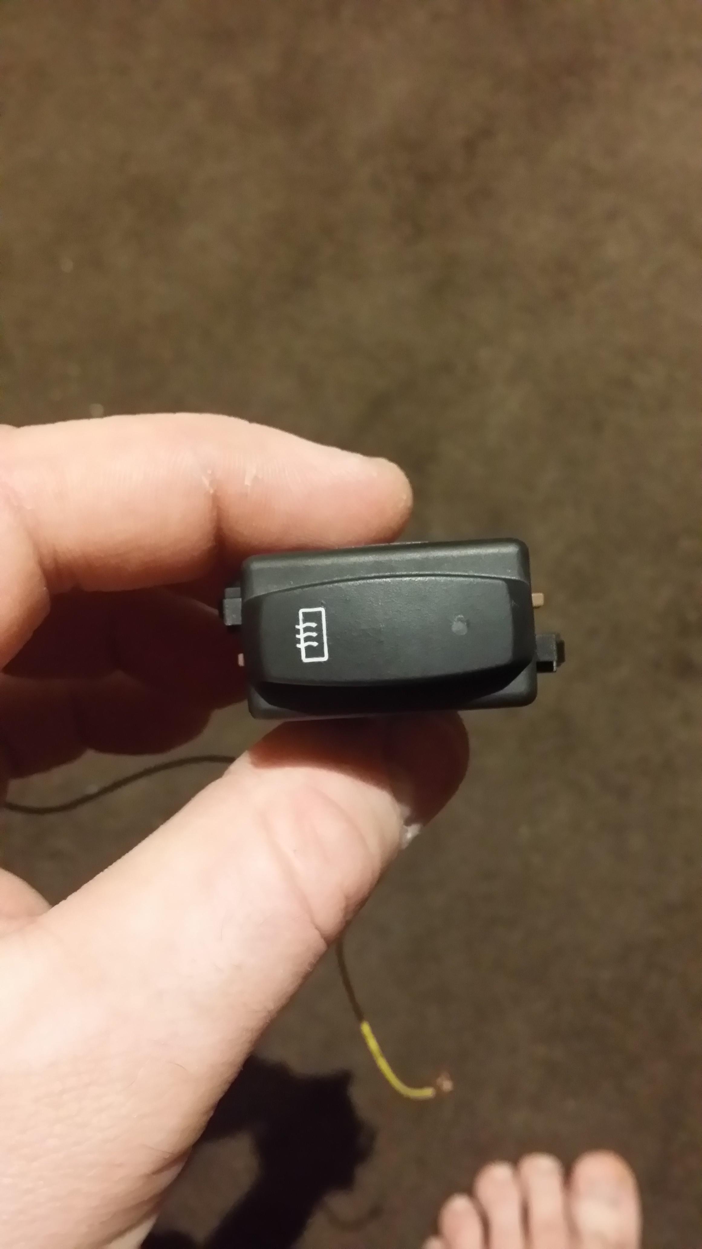

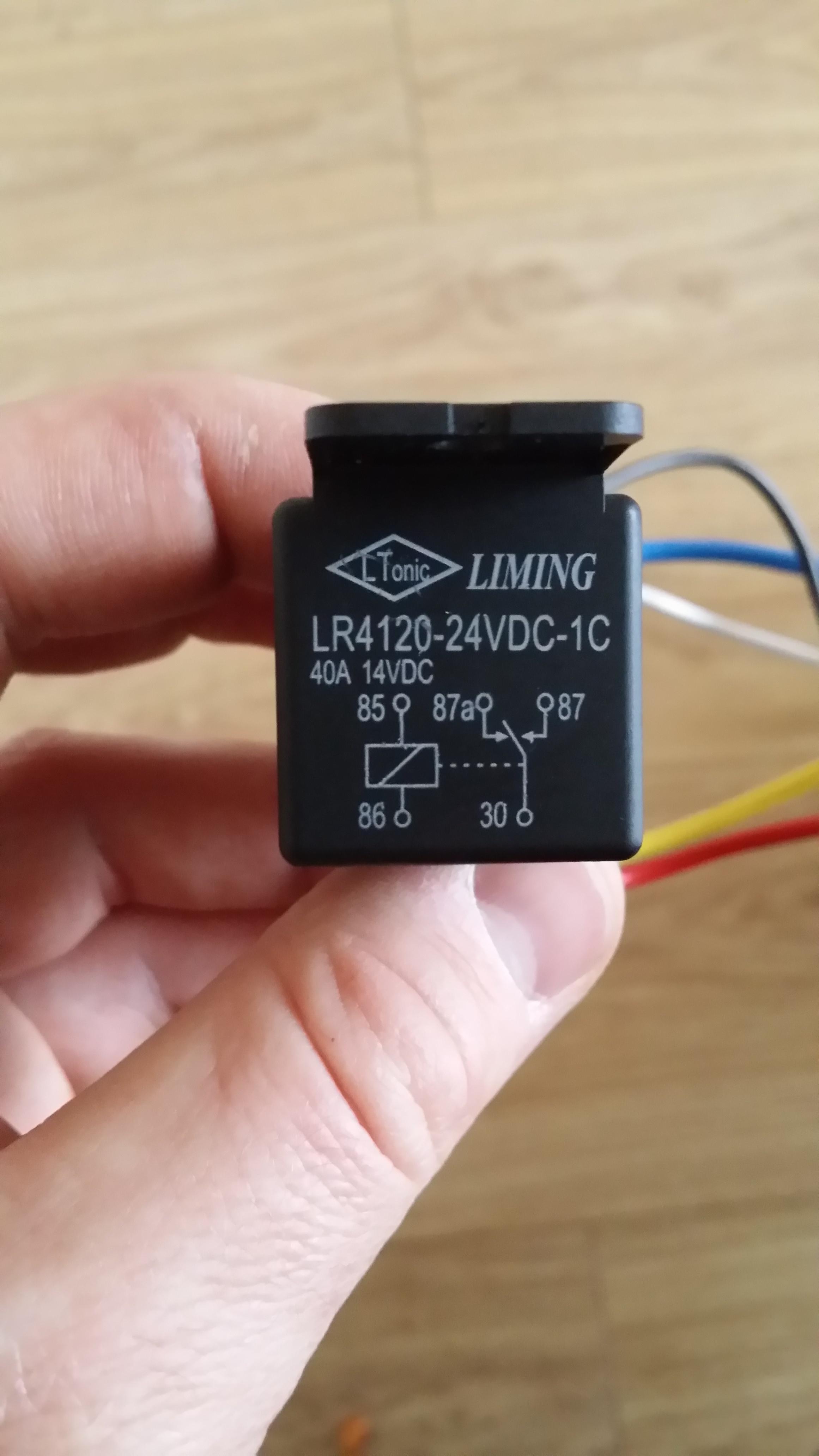

    Hello, I have a problem with connecting the transmitter in the car. I will start from the beginning in a car cut off the ignition I have a cable on which after ignition I have 12v after disconnecting it does not fire myself, I would like to use the relay attached in the picture below to press the contactor after ignition so that the relay lets current and start the car such a small protection against thieves. Please help me describe how to connect the relay and my contactor. I don't have much to do with electronics, please help. [/ B]

    At the beginning do not write "contactor" but a switch, on the relay you have the descriptions of the pins:
    85 and 86 - powering the relay coil
    30 - permanent contact
    87 - normally closed contact
    87a - normally open contact
    that is, you connect what you want to "cut off" to 30 and 87a
    you supply the relay with a switch on 85 and 86

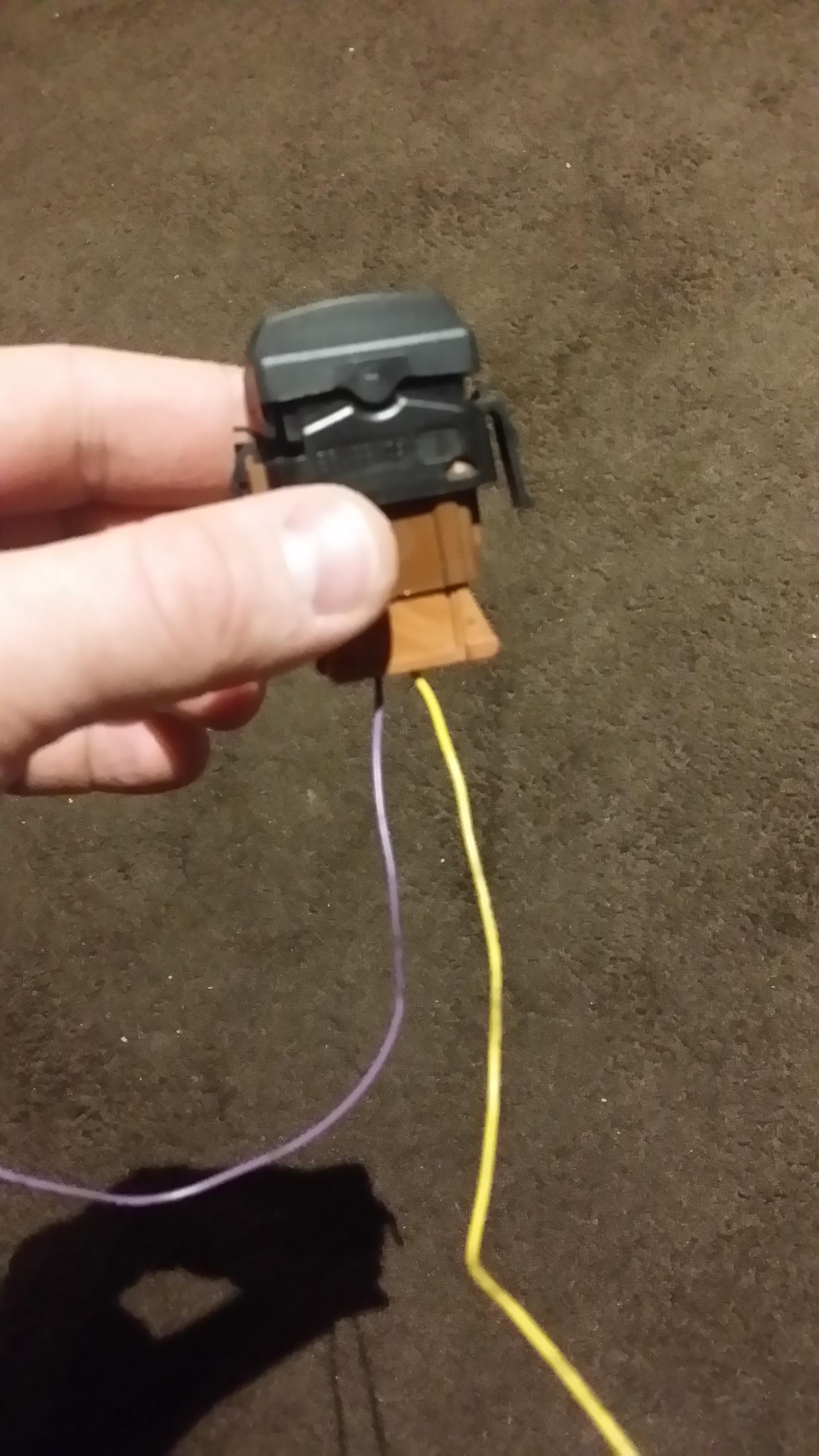

    Rolak88 wrote:
    I plan to make the switch as a micro contact that I press after ignition and he will switch on the relay
    Something like that ?
    Relay connection, ignition cut off - how?
  • #9 16185291
    Rolak88
    Posts: 7
    That's exactly what I mean and after pressing it switches on the relay and the car lights
  • #10 16185307
    leonov
    Posts: 8917
    Help: 1039
    Rate: 2248
    Well, this relay will not work, you must have a relay with support, read this subject.

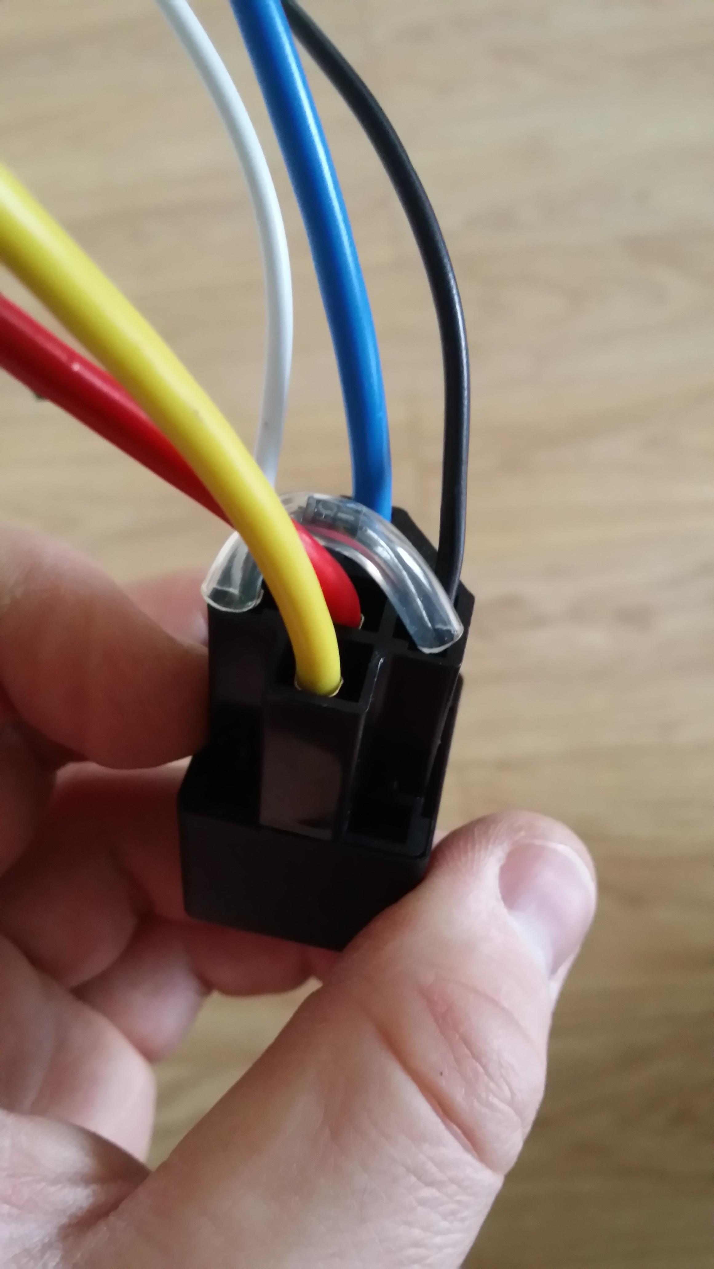

  • #11 16185331
    Rolak88
    Posts: 7
    I will add a photo in the electronics store once again that it is suitable

    Rolak88 wrote:
    they said it was suitable
    Not suitable, read the topic I gave above.
    It will be like it will support the relay coil by the separating diode and will cut off the plus not dying when turning the starter.
