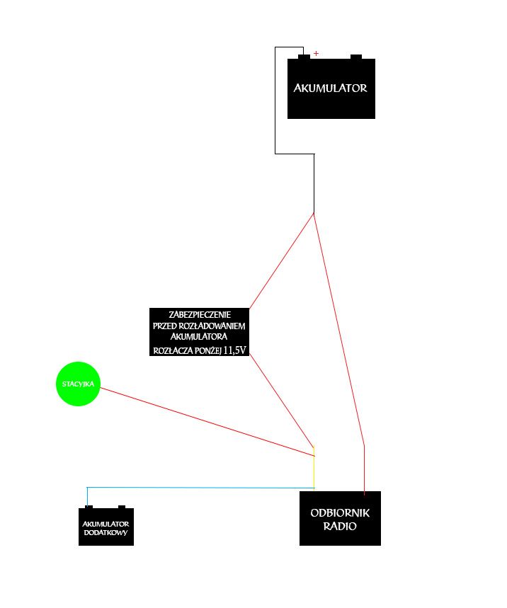

    My question is a little bit different, but I didn't want to start a new topic.
    Well, I installed a multimedia station in the car, which has the feature that it starts automatically when power is supplied to the ignition switch. Meanwhile, the car has the feature that it cuts off the radio power when the engine starts. The result is that when the ignition is switched on, the radio starts, and then turns off for the starter.
    How to get around this?
    - install a small gel battery to support the radio? Only if the radio does not discharge it overnight, or several days of not using the car.
    - give a plus directly from the car battery?
    - install the switch and manually turn on the radio only after starting the engine?
    - to regret and count on resistance and good quality of the radio?

    How would you charge this extra gel battery because I have the same problem, if it drops to 10.5 then the car will not start I now have a protection that holds up to 11.5 but shortly and disconnects the radio after half an hour. I think I just put an extra gel battery but I have no idea how to charge.

    The additional battery will be charged, because in the entire installation during operation the engine is 14.5V. A small rechargeable battery does not need to be charged as much time as the one under the hood.
    I made an additional switch and turn on the radio after starting the engine.

    Can you write me what battery you have (type, link)? How much support does you have on it, because I am drawn to support 1A.
