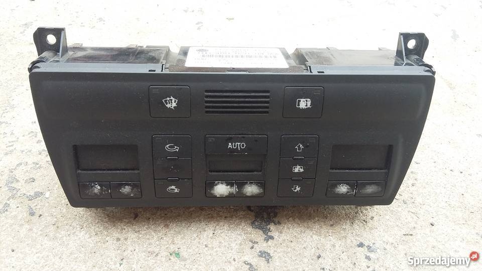

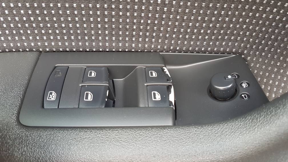

    In this car model 2004 - 2008 you will already have problems by mounting this type of lock. It is not as simple and obvious as in "Matiza".
    Also pay attention to how much the descriptions (pictograms) of switches (e.g. light switch or window opening buttons) are worn in some heavily used cars.
