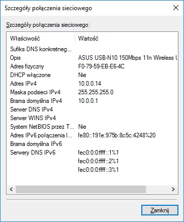

    I rather expect problems with Win10, because, as I said, there is a new router, Win7 is ok, and there is no problem with the Win10 notebook in other networks. Transferring to another USB port does not change anything, only what's strange is that a few days after using the WiFi USB modem was a connection and the internal WiFi does not. After a few days, problems on the external WiFi also occurred. Attached call drop - address assigned.
    greetings Win10 WiFi problem - No internet connection with active connection to the router

    Why permanent addressing assigned? Do you get something after setting up the network card for automatic download?

    How to give a car there are no addresses at all, but at the time when the USB WiFi card worked - until yesterday - the address was broadcast.
    How to attach in windows AIPIA this address is always broadcast from the series 168.192 .... and there is also no internet.

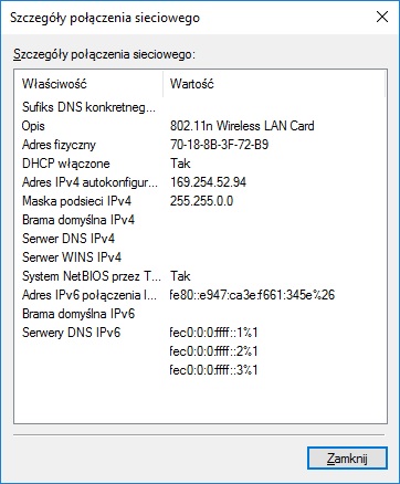

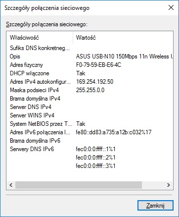

    I tested the proposed variants:
    As I wrote above on the Orange router, which worked for 2 years and was replaced about 2 months ago, the problem was identical.
    On the new router also from Orange, the built-in card and USB behave similarly.
    In addition, I had on Saturday a router from Orange operating in a neighborly company - similar effects:
    There are no problems on win7 and on Android. In addition, I tested on the old XP - also OK.
    On my notebook with win10 after combining with drivers, using the commands "ipconfig / release and ipconfig / renew", after reset - in different order sometimes the IP address was assigned by the router and the internet was until the next reset or start / stop the network.
    I think it is a problem in Win10. If there are no better proposals then I will try Microsoft.
    I will share the effects.
    greetings
    • Win10 WiFi problem - No internet connection with active connection to the router wifiWbud.jpg (53.84 KB) You must be logged in to download this attachment.
    • Win10 WiFi problem - No internet connection with active connection to the router WiFiUSB.jpg (55.87 KB) You must be logged in to download this attachment.
