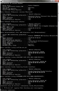

    Here he adds a screenshot of what it all looks like:

    as already screen, give one more after clicking on the right side on the inscription "Wireless network connection (Lukasz)"

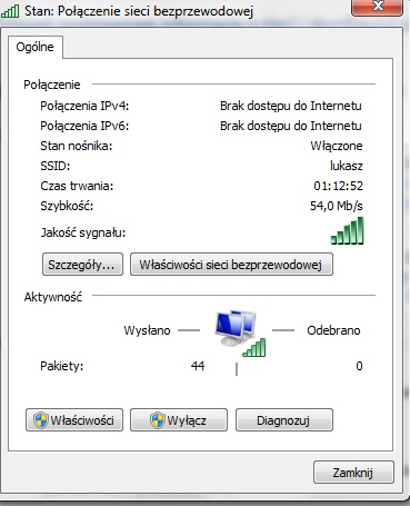

    A similar symptom will occur when you enter the wrong key. If you have already turned off encryption in APek, remove the saved network in the computer (Just like the last screen -> wireless network properties (find the list of remembered networks and delete them), then reconnect to lukasz ..
    If that didn't help, give a screen again after pressing Details ...

    WiFi Connection on Windows 7 Laptop: Connects to Router but No Internet Access (Ethernet Works)
    removing the remembered networks did not help, and the router has already been reset several times.

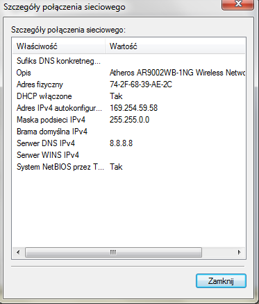

    Added after 3 [minutes]:
    I did as you said, but it will do nothing.

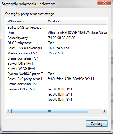

    Now I have it that it will connect normally, asks to enter the MAC address and after restarting the router automatically it starts every 5 seconds. change to restricted access and connected and so on all the time.

    Who configured this APeka? Do you have access to it? It doesn't seem to act as a router but as a bridge (swith). The net gentlemen assign you an address by MAC address. If you want to achieve the same on the WiFi card, you need to assign the wireless MAC LAN address that is: 14: AD: E9: 27: 69: 94
