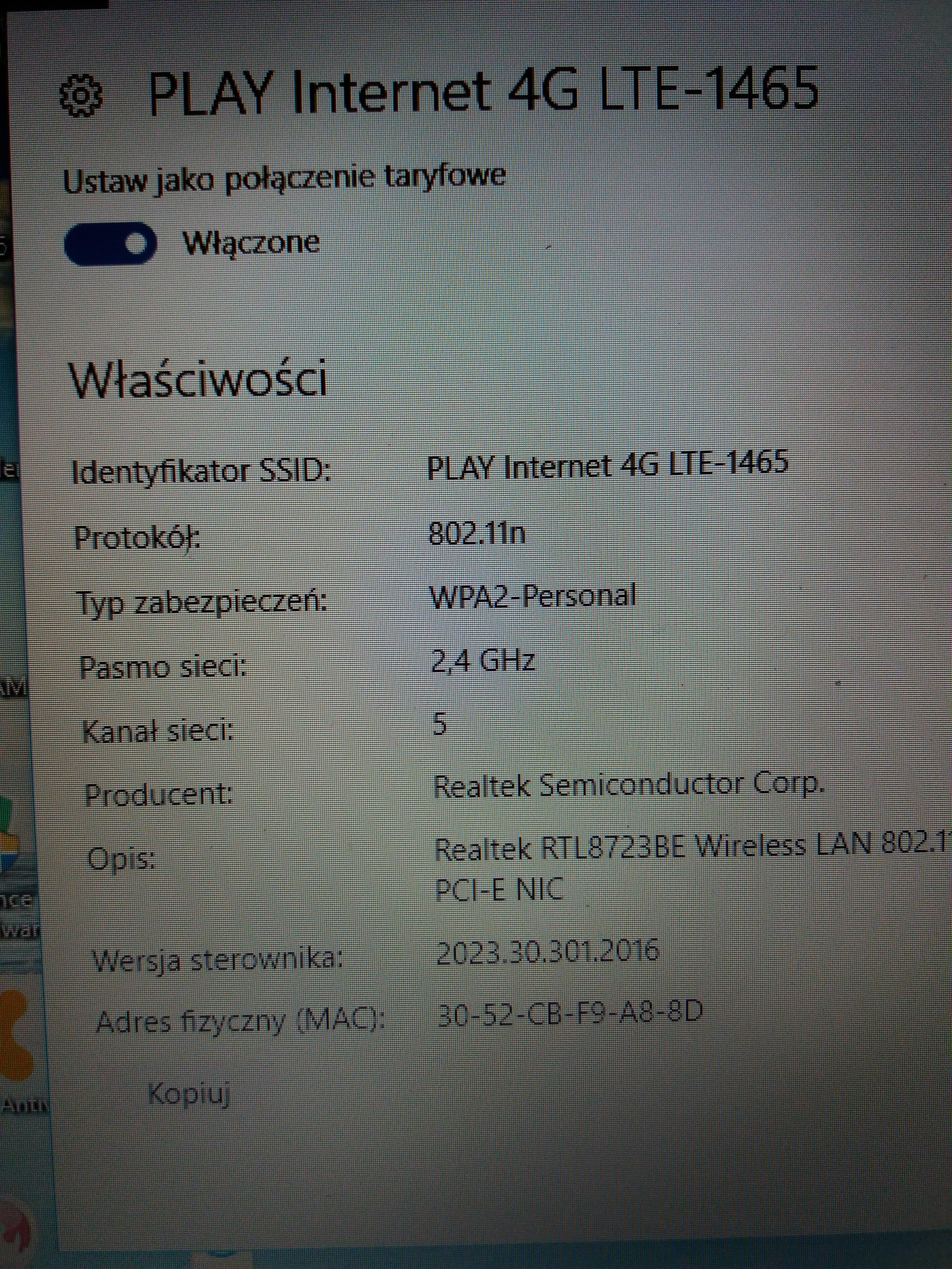

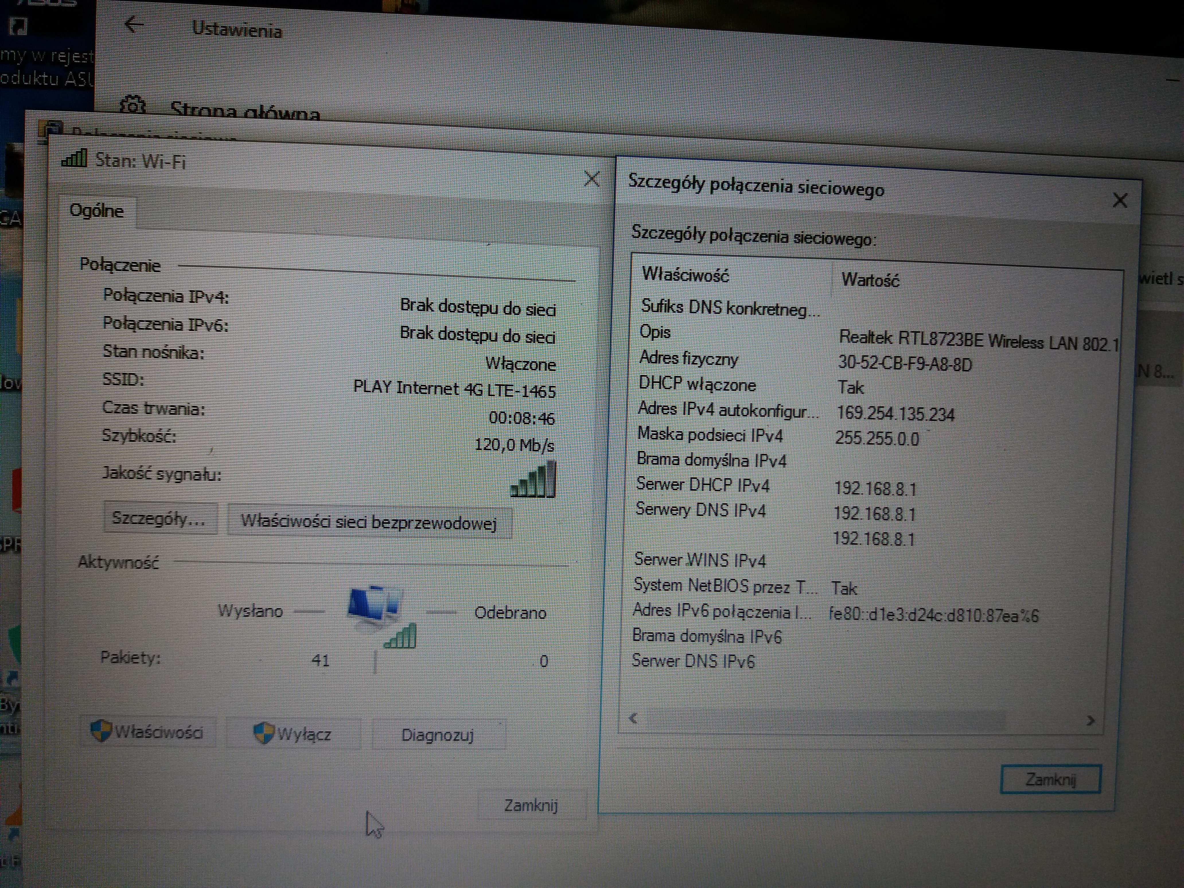

  • #14 16205938
    feerbe
    Posts: 31
    Rate: 40

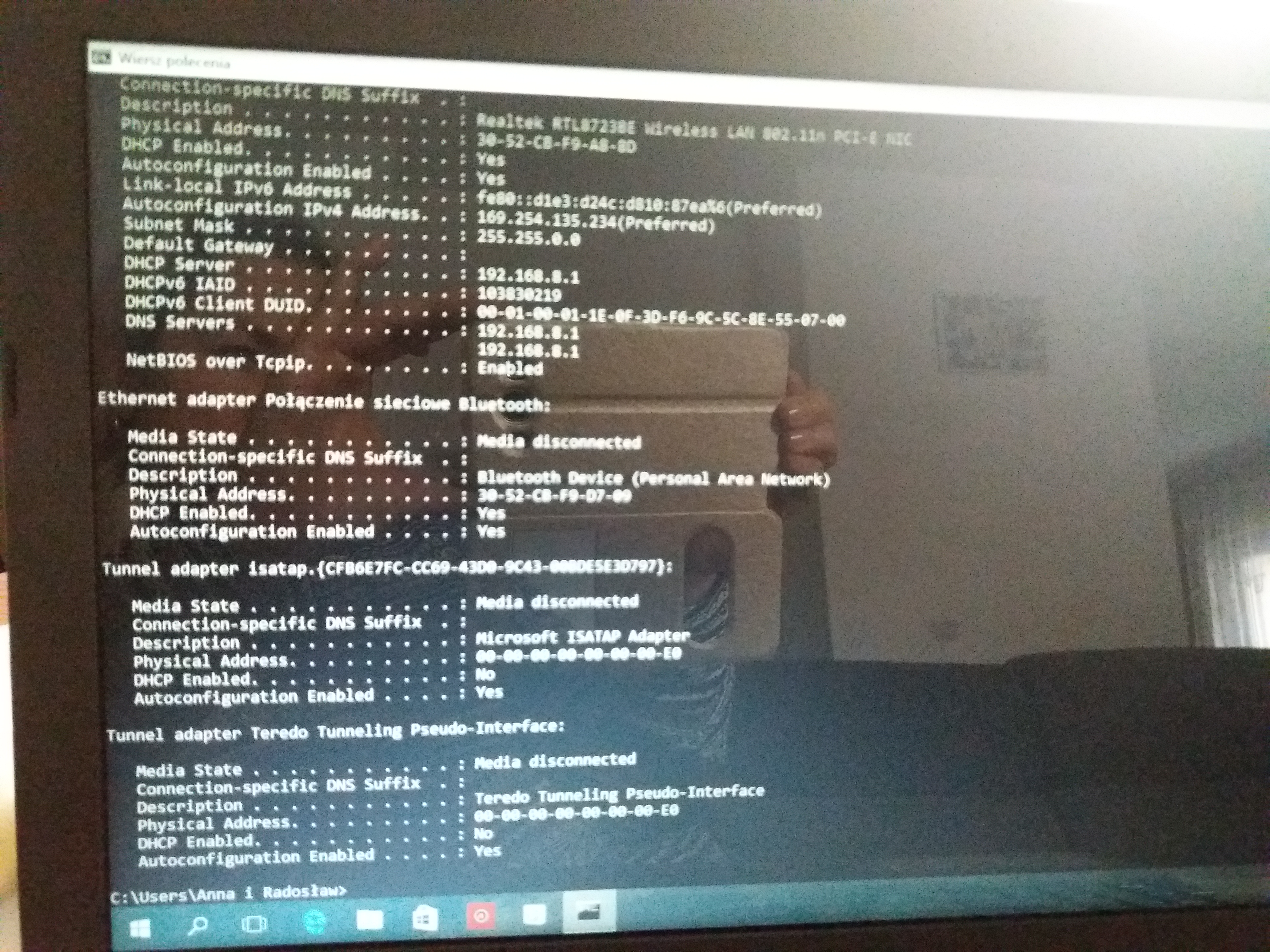

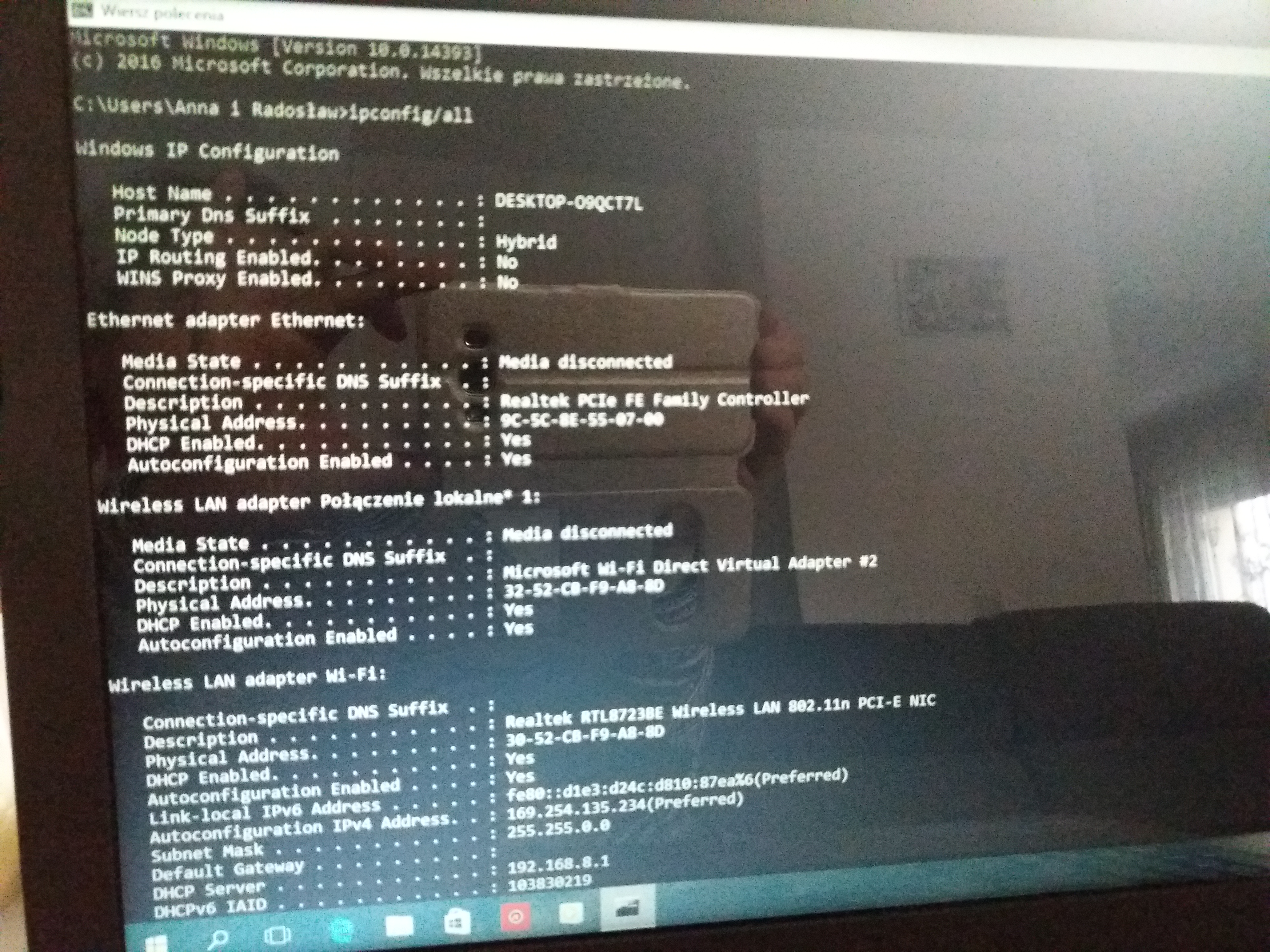

    These are 2 photos
    • Incorrect IP Protocol Configuration on WiFi Network Adapter: Laptop Modem Connection Issue 20170117_085838.jpg (4.86 MB) You must be logged in to download this attachment.
    • Incorrect IP Protocol Configuration on WiFi Network Adapter: Laptop Modem Connection Issue 20170117_085922.jpg (4.83 MB) You must be logged in to download this attachment.
  • #15 16205980
    Kolobos
    IT specialist
    Posts: 85178
    Help: 17171
    Rate: 10455

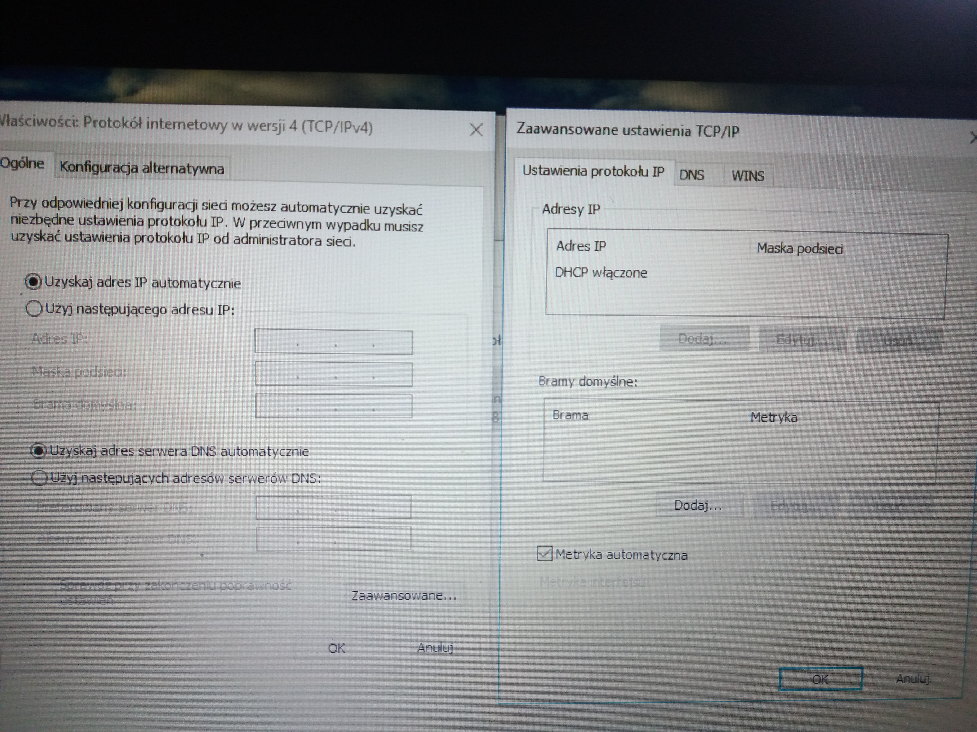

    The screen shows that wifi is assigned dhcp, dnsy, etc.
    Post a screen of the wifi card's tcp / ip properties, along with what is under "advanced".
    Earlier you wrote "wifi modem", do you mean the wifi card integrated in the laptop or maybe a gsm modem connected to the usb?

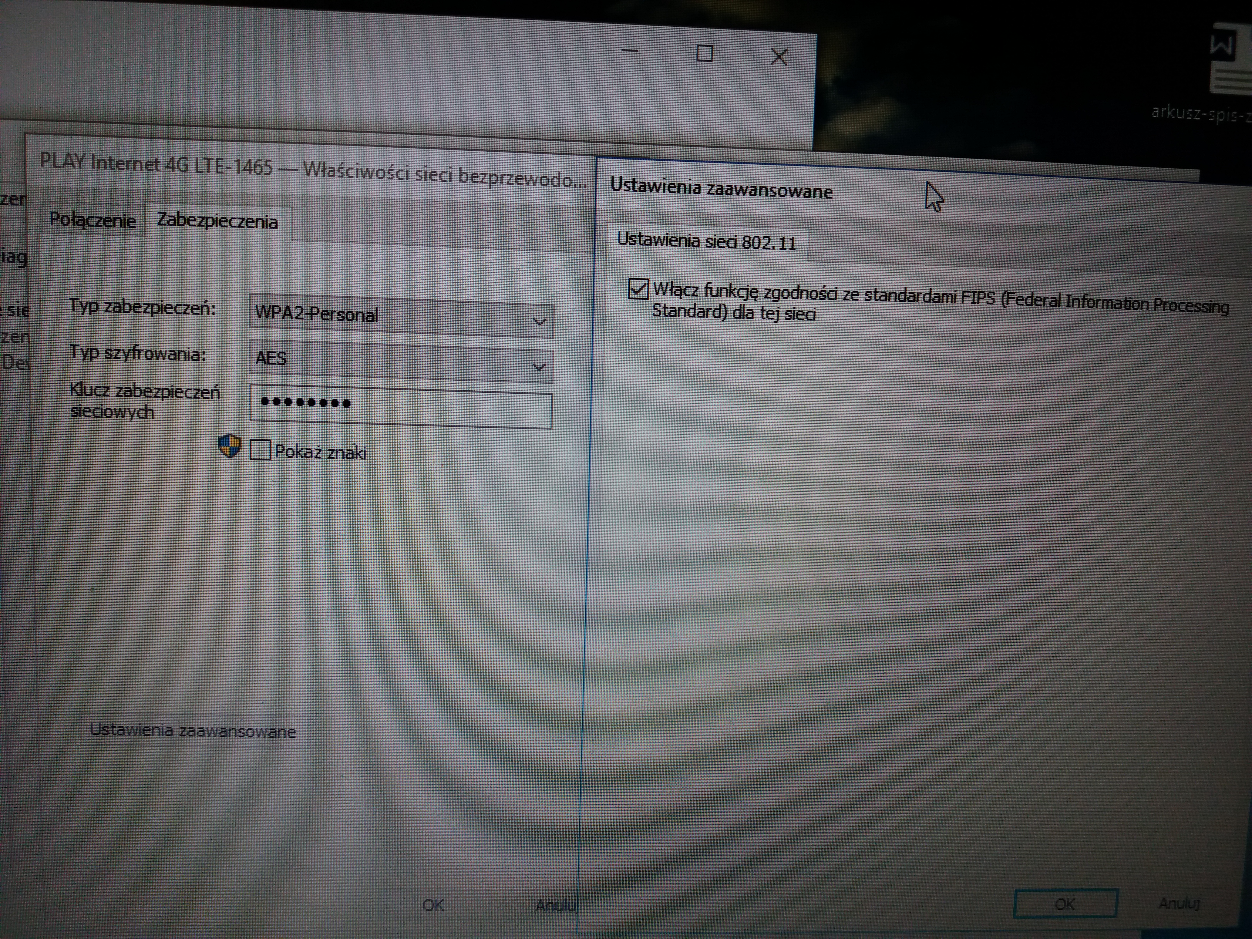

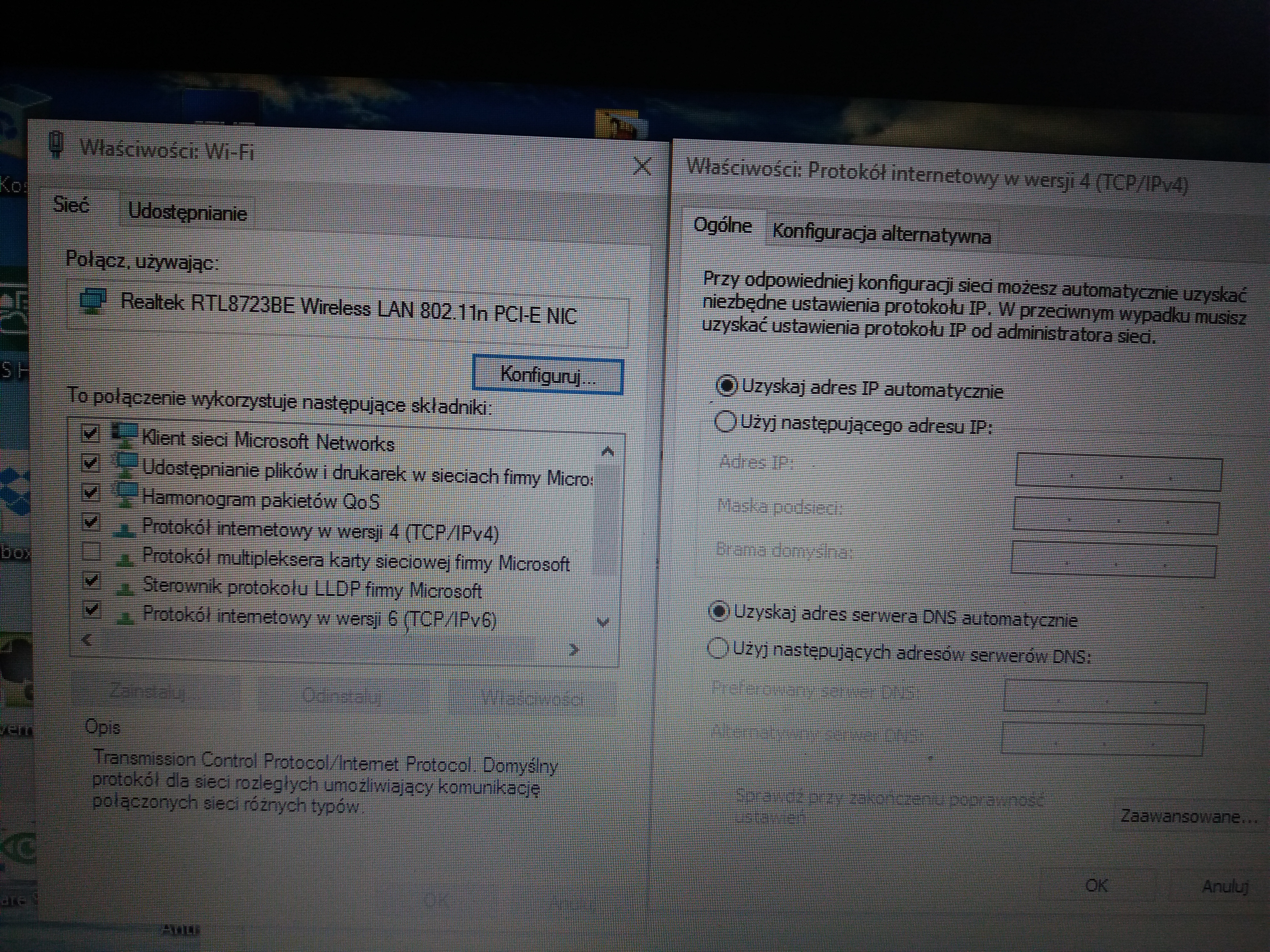

    > Post the screen of the tcp / ip property of the wifi card, along with what is under "advanced".
  • #18 16206291
    feerbe
    Posts: 31
    Rate: 40
    Was that what it was about?

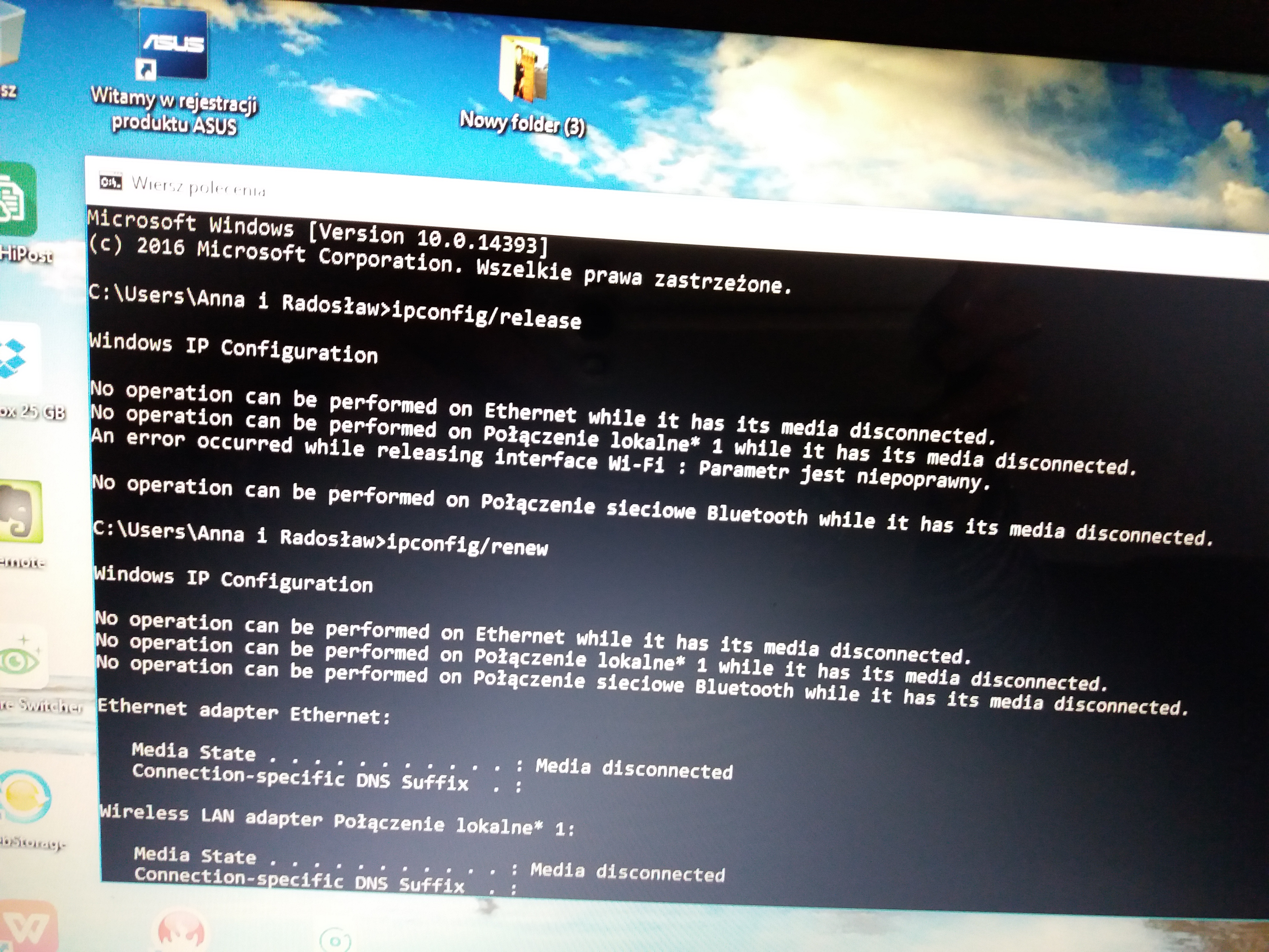

    Run the cmd window with administrator rights and there:
    ipconfig / release
    ipconfig / renew
    ipconfig / flushdns
    Have you tried to uninstall the card as I did before? After uninstalling, it should install itself.

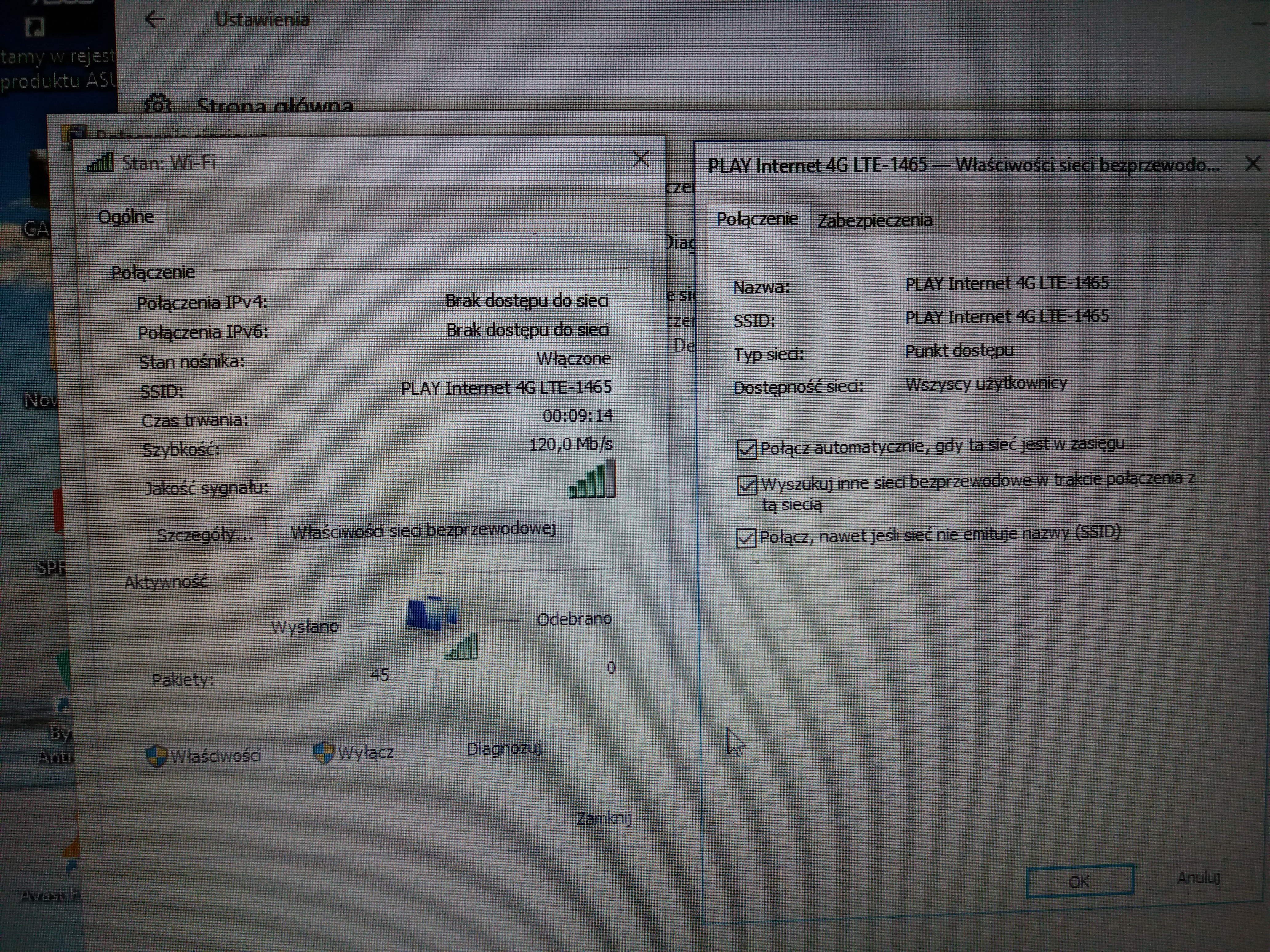

    The wifi card looks connected, got an ip address etc.

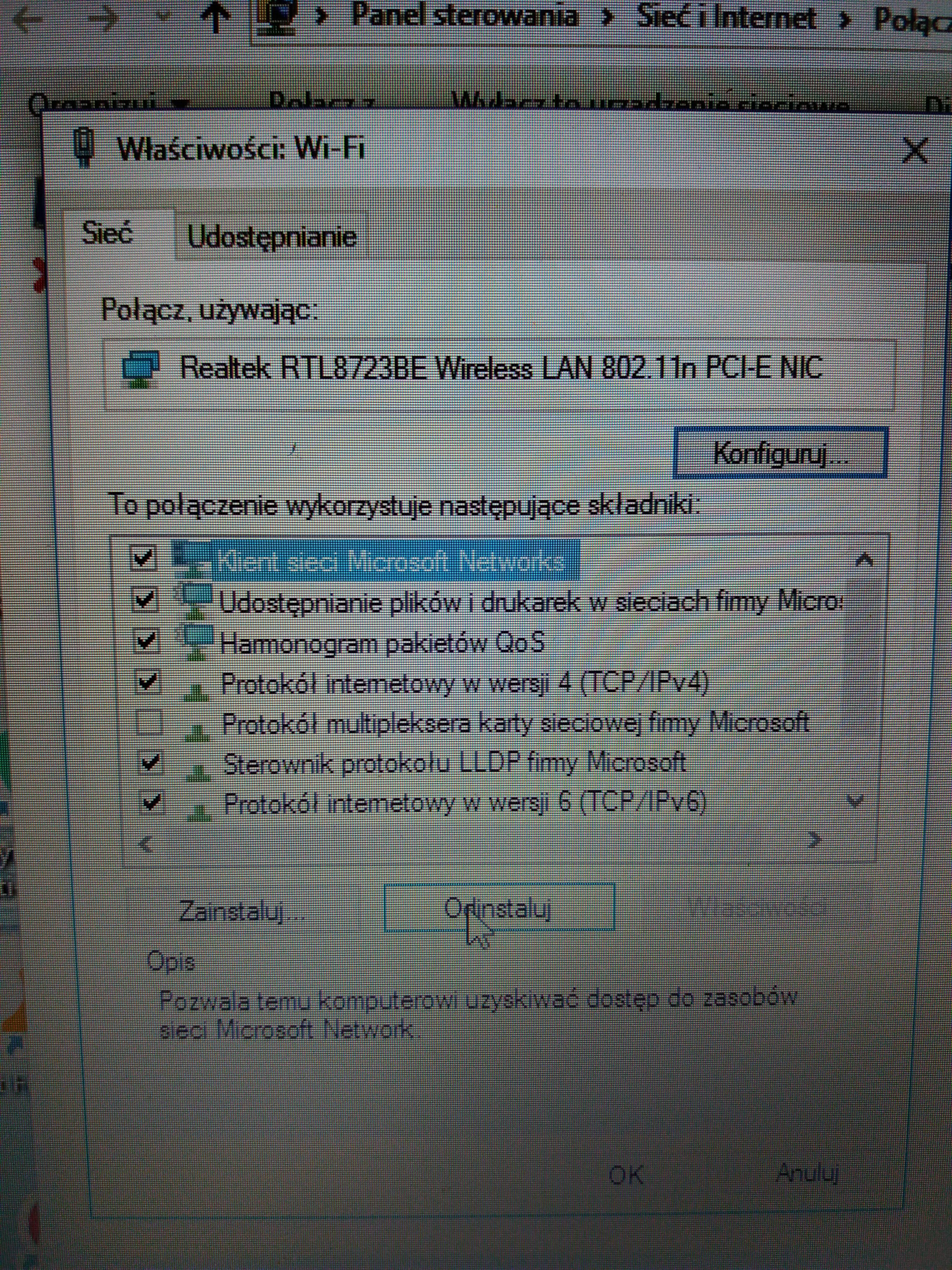

    Is it okay here to uninstall the card?
    • Incorrect IP Protocol Configuration on WiFi Network Adapter: Laptop Modem Connection Issue 20170117_135732.jpg (4.17 MB) You must be logged in to download this attachment.

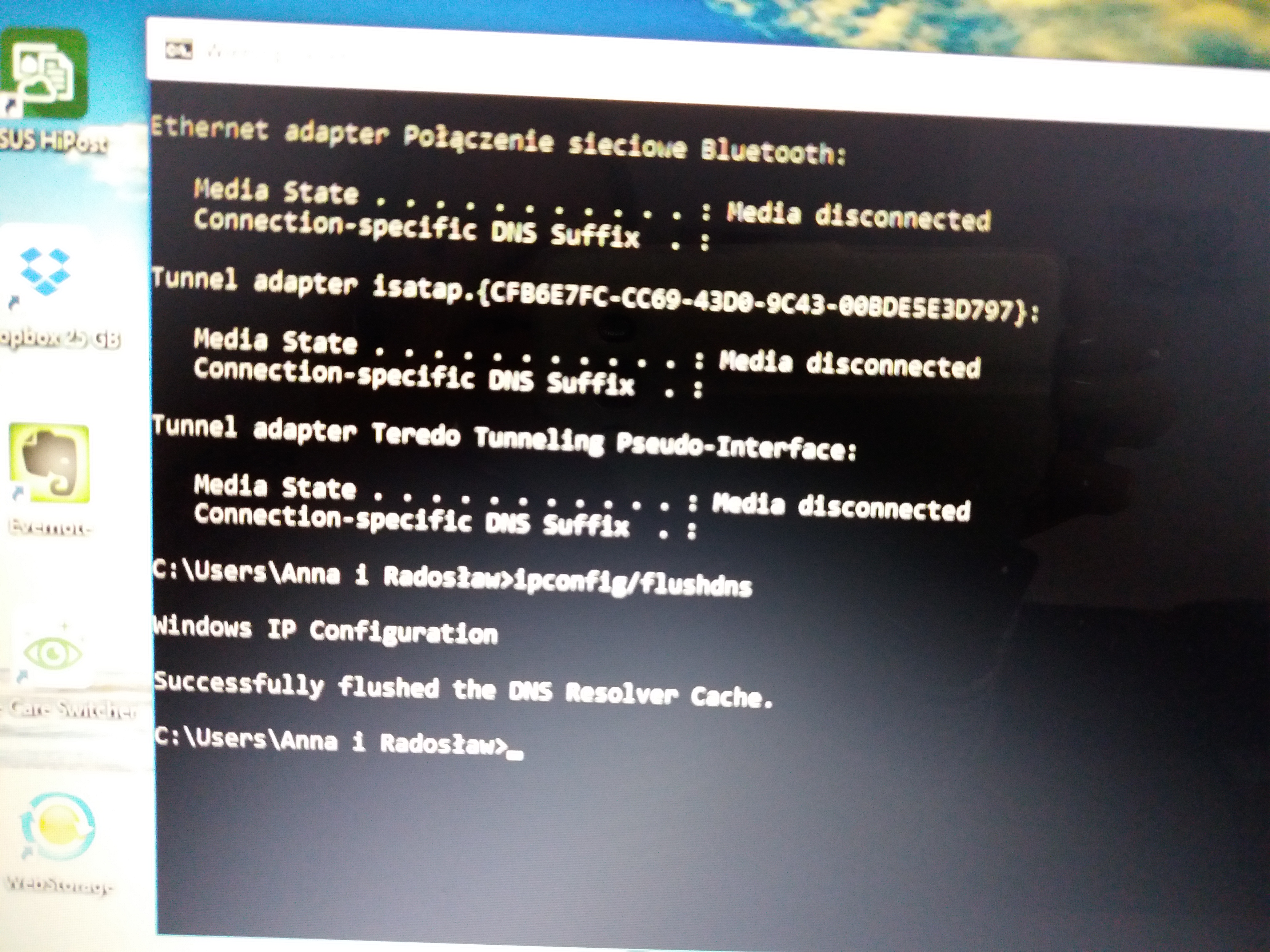

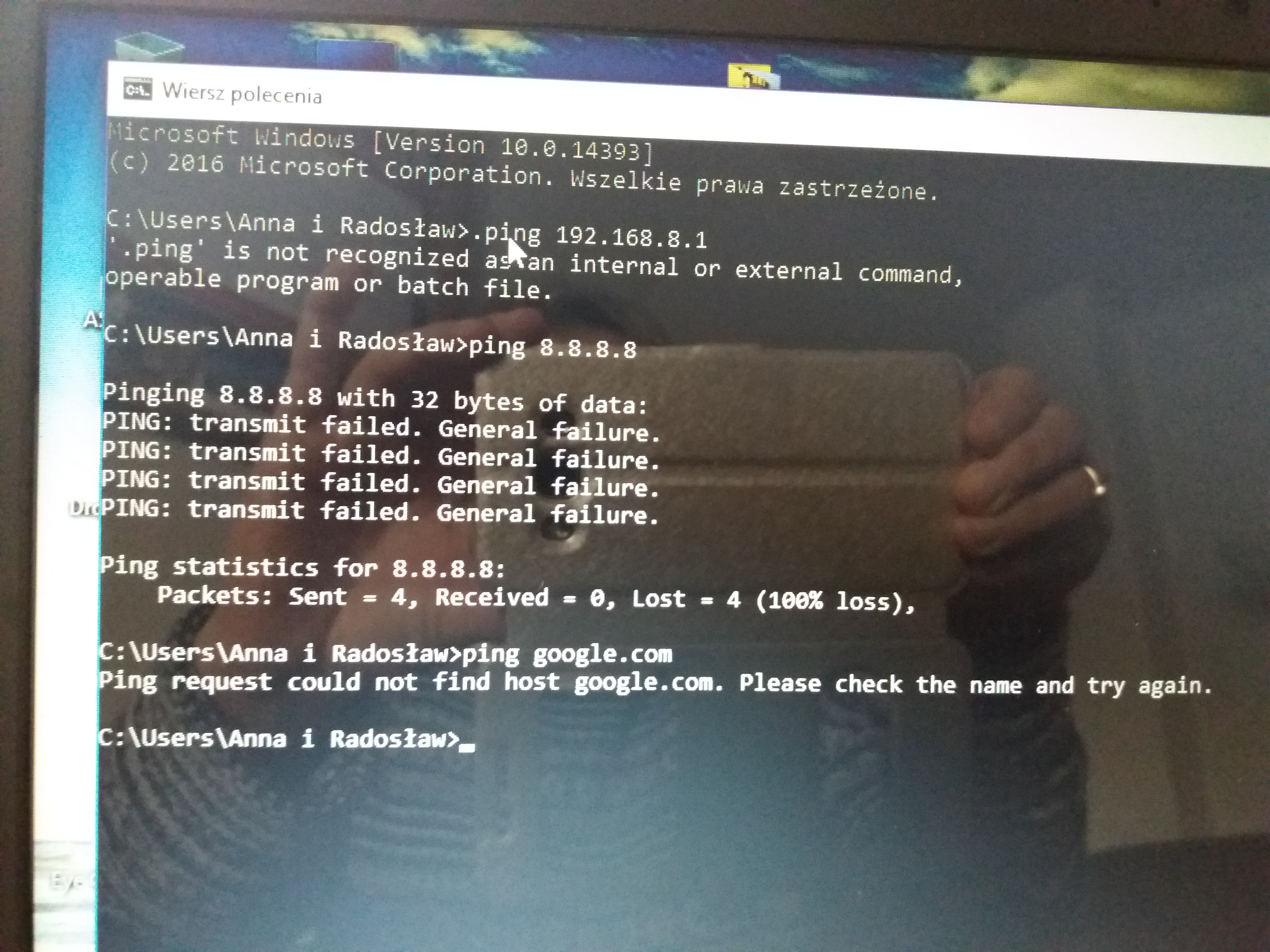

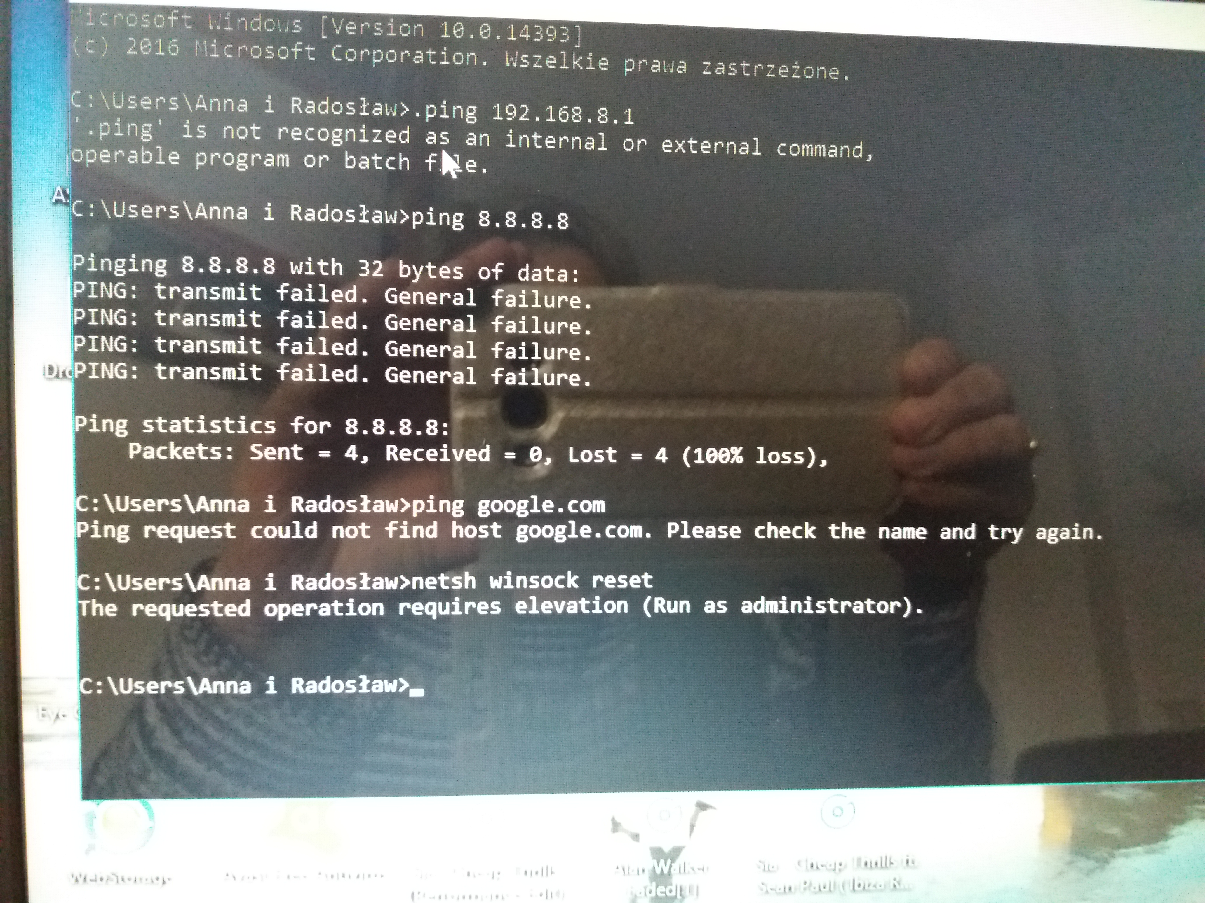

    Hello . Well, I did these commands as you asked, and by connecting the net via a usb cable, the net works, but not wirelessly anymore.
    These are a few photos
    • Incorrect IP Protocol Configuration on WiFi Network Adapter: Laptop Modem Connection Issue 20170118_100715.jpg (4.05 MB) You must be logged in to download this attachment.
    • Incorrect IP Protocol Configuration on WiFi Network Adapter: Laptop Modem Connection Issue 20170118_100539.jpg (3.87 MB) You must be logged in to download this attachment.
    • Incorrect IP Protocol Configuration on WiFi Network Adapter: Laptop Modem Connection Issue 20170118_100457.jpg (4.78 MB) You must be logged in to download this attachment.
    • Incorrect IP Protocol Configuration on WiFi Network Adapter: Laptop Modem Connection Issue 20170118_100353.jpg (3.75 MB) You must be logged in to download this attachment.
  • Correct ping syntax and elevated Winsock reset required
    #29 16208667
    dt1
    Admin of Computers group
    Posts: 48250
    Help: 7315
    Rate: 8292
    ping 192.168.8.1 and .ping 192.168.8.1 are two different commands. Please note that there is no period in my commands - and it was entered with a period in the screenshots, so the result was a command error. Please only test ping 192.168.8.1 again, now correct, no leading dot.
    The netsh winsock reset command must be run at the command prompt as administrator, otherwise the command is ignored (as can be seen from the rest of the resulting message - elevation of privilege is requested). I would also ask you to re-issue this command, but at the command prompt as Administrator.
