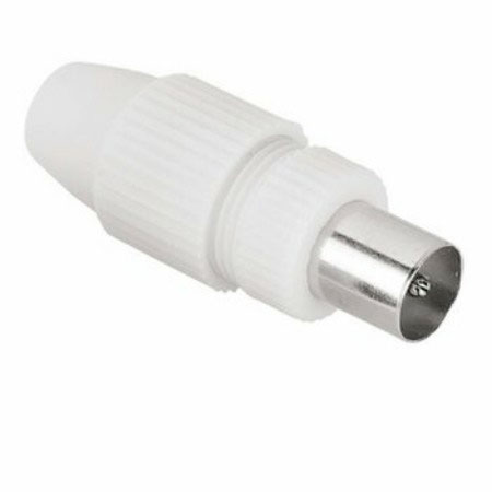

    Now I have something like:
    Connecting Antenna Amplifier: Improving Reception for Polsat, TVN, TV4 Channelszlaczka-an...prosta.jpg (9.99 kB)You must be logged in to download this attachment.
    This is not searched for by tvn, polsat, tv4, tvn 7. In the past it used to search for this once but terribly these channels were cut off, there was a low signal, etc. The rest of the channels is and works perfectly
    On the power supply which I made, I found 7 channels such as 1, 2 but the signal strength was not too high. So I went back to the connector which I gave above.

    You were supposed to give what was this connector? How do others in this house have?
