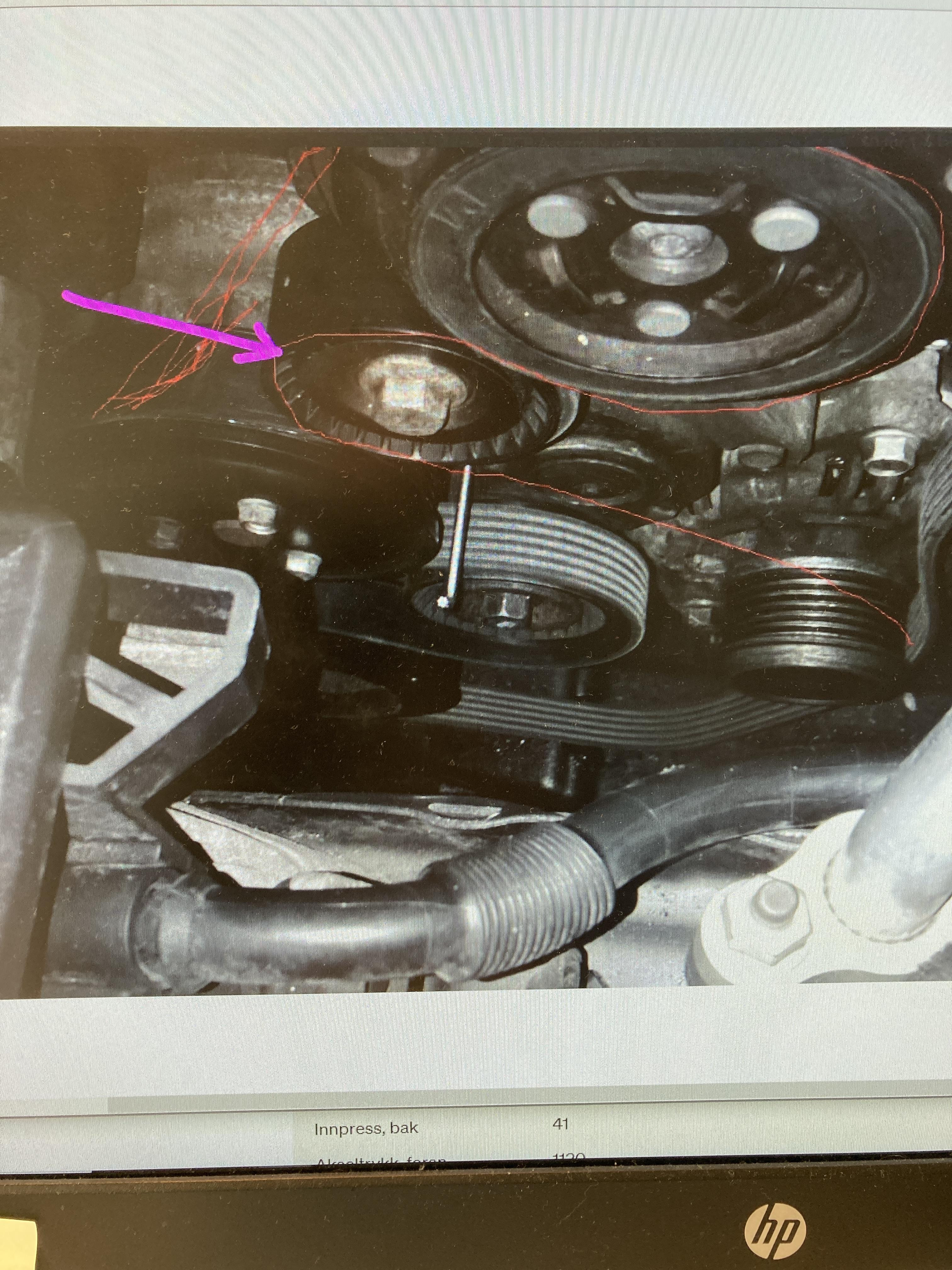

  • #8 20994204
    msumi
    Can anyone tell me what the name of the roll shown in the picture is? I mean the number and dimensions that fit Astra 1.7 cdti 2011, 81kw, engine type A17DTE?
    • Opel Astra J 1.7 cdti - drawing / wiring diagram for the multi-ribbed belt image.jpg (2.73 MB) You must be logged in to download this attachment.
