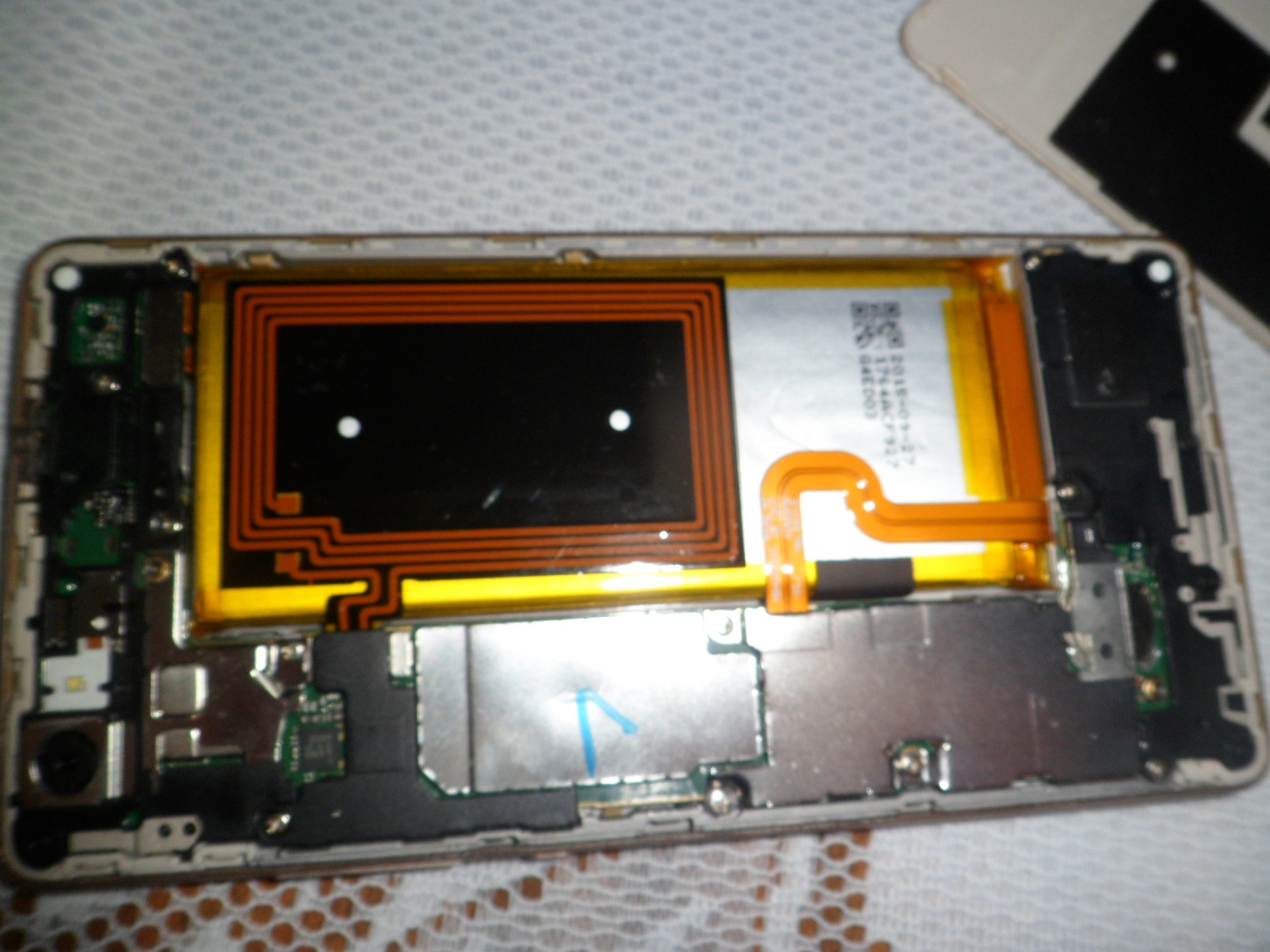

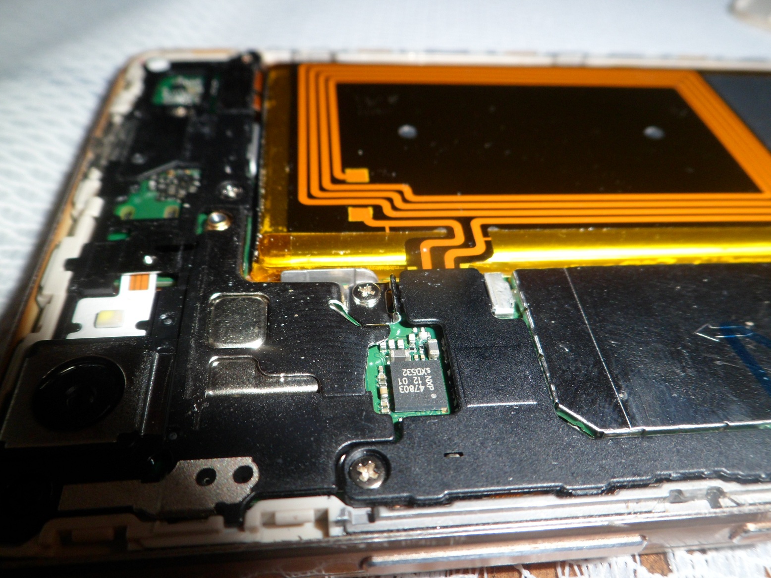

    I have a huawei phone for some 3 years, I did not have a problem with him. Every day I turn on the wiffi when I'm at home and after the house from the package I have internet. Today I turn on the wiff and he does not catch the range of the router but only the range at the router, but I do not want to connect to the router. It works normally on a laptop and other phones. I made software updates but unfortunately it did not do anything. Will somebody tell me where the module is or let me know what it can be?

    Have you tried to reset the phone or delete network data and reconnect?

    Typical defect in p8 and p8 discs lite replacement of the disc by the service. Free wired assembly. If you even release it there is nowhere to buy a new one.

    Layout of the circuit but could damage the antenna, e.g. during a fall

    Well phone a few times he fell for sure but all the time in the case was and can you show me where is this wifi antenna?

    The antenna is embedded in plastic from what I remember is above the usb socket, i.e. under the flap at the bottom :)

    I was on the phone service guy said that it may be a damaged proocesor, antenna or just upload new software. New but unfortunately nothing was given. he took to dyche fatyge. The antenna said it costs 80 zlotys but he does not know if it's the antenna's fault. The range is in wifi, but it does not connect and writes with TOTAL ACCESS

    and you could send me a photo of what this wifi module looks like because I can not find it. maybe the antenna somewhere loosens the tape but I do not know where to look for it

    The authorized service exchanged a disc for this fault. A good service will charge up to PLN 150 for the service. It is a bit of fun with the glue under the system. Come and ask. Only is it worth today at today's price?
