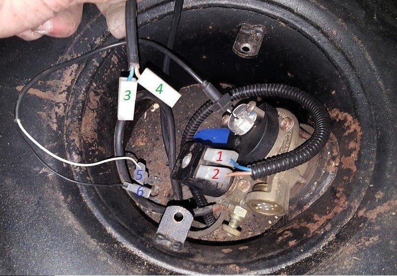

    Hello, I have a problem I bought a Fiat seicento 900 lpg bottle was pulled out because it blocked the screws from the seats and now it is not known how to connect them ..
    cables 1 and 2 go from the controller
    cables 3 and 4 are screwed to the floor of the boot
    cables 5 and 6 go from the cylinder indicator
    • LPG Cylinder Cable Connection for Fiat Seicento 900: Steps for Controller, Boot Floor & Indicator butlap.jpg (242.06 KB) You must be logged in to download this attachment.

    Cables 3 and 4 are mass.
    Cables 5 and 6 are gas reserve indicator contacts.
    The cables from the controller are: one switches on the gas solenoid valve and the other is from the reserve indicator in the cabin.
    Cable 3 is connected to one of the valve coil contacts and cable 4 to cable 6.
    To connect the rest, you need to check which cable goes from the controller from the indicator and which goes to the solenoid valve coil.

    Lpg is already working in addition to connecting cables, it turned out that these masses screwed to the floor were rusted and did not conduct, and in addition cables from the controller were broken under the sofa.
