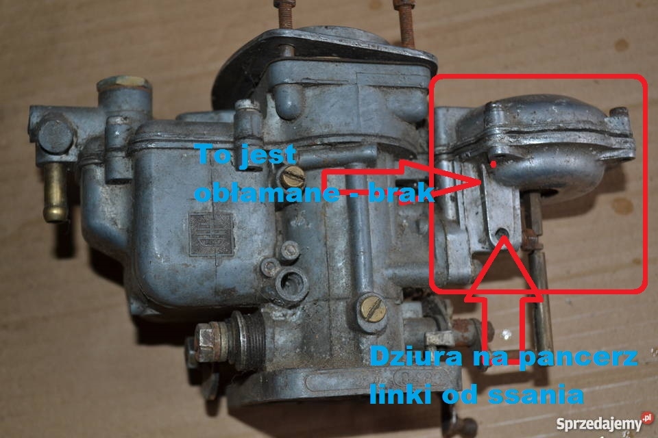

    2. The photo below shows the carburetor from the throttle cable side. There is no actuator responsible for the suction, which was broken when dismantling the engine. Can sealing this hole with a metal plate with a rubber washer affect the negative operation of the engine?

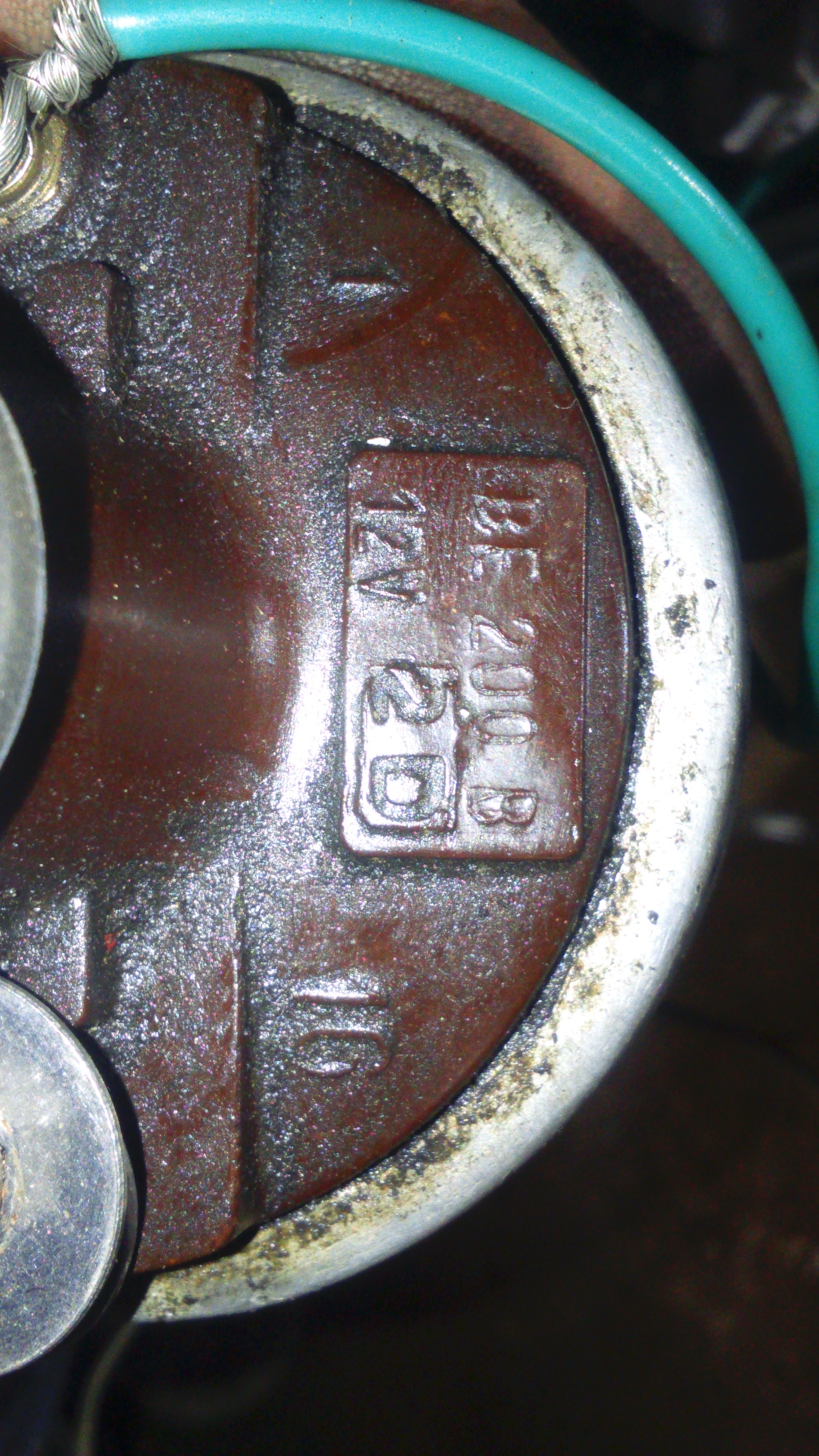

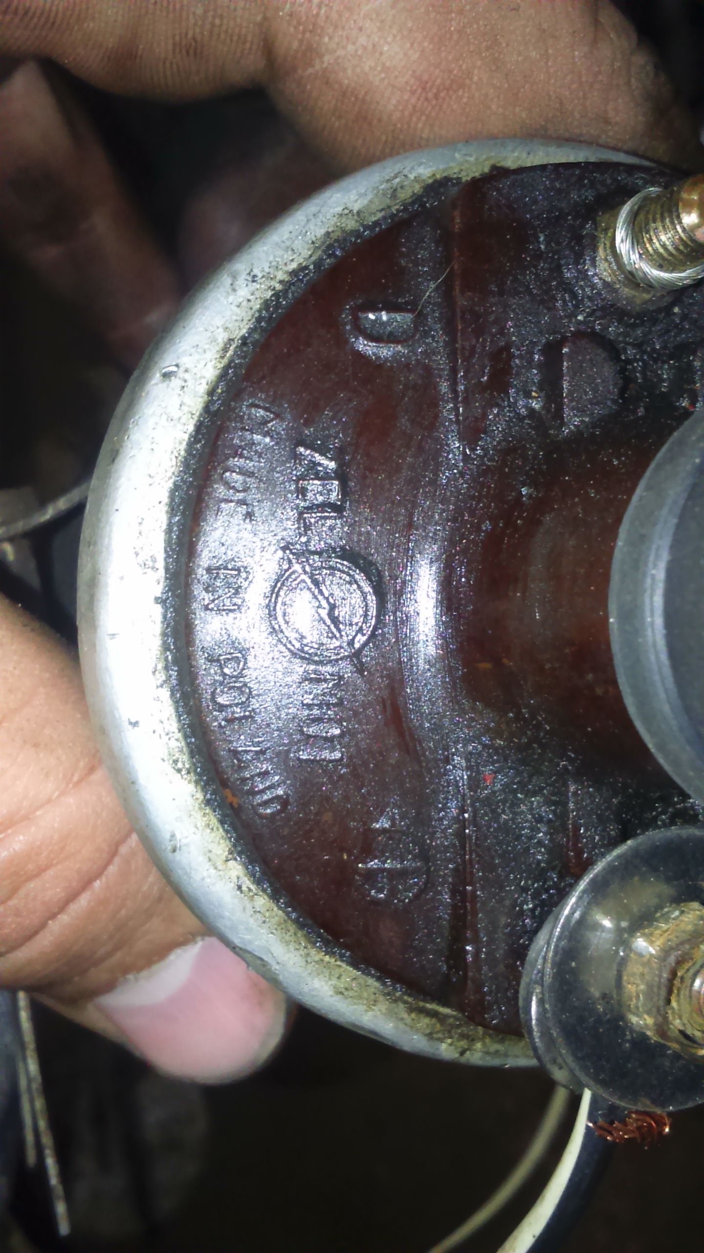

    4. Is a coil with numbering like the photos below good for breaker based ignition? Being at the vehicle disassembly station, I received information that there are 3 types of coils, I took the one with a darker head because I remember that the one with the lighter one was mounted in a Polonez with electronic ignition.
    Fiat Engine 125p 1500: Carburetor Connection Queries - Hose, Connector 1, and Throttle Cable Side Fiat Engine 125p 1500: Carburetor Connection Queries - Hose, Connector 1, and Throttle Cable Side
    I am very sorry if my questions seem funny to some, but when it comes to carburettors, I am weak at this and I prefer to ask professionals before I do something wrong.

    The coil is for a camera with ordinary plastic plates, not for electronic ignition.

    The broken off piece by the choke lever is used to attach the choke cable, and more precisely its armor.
    And I will not agree here. In some photos you can see that in this place, exactly under these screws, the idle actuator is bolted (it opens the second throttle after adding more throttle (understood when 1 throttle is fully open). I agree. Is this actuator needed for proper operation? The hole can be plugged? As for the attachment to the cable and the suction device itself, this lever is set to the "choke" position and does not think to twitch. Is there any way to fix this fault?
    In the ignition device I have a finger with a resistor inside which visually looks a bit worn. Can I mount a polonaise finger without a resistor? I will not burn the coil this way? After all, this resistor is for something :-)

    Reply to point 2;
    There is no actuator there, but as I mentioned a bracket with a hole (such a sleeve) through which the cable passes, but the armor of the cable stops. The lever next to it must move, because this is how the engine suction is activated. If you unscrew these two screws, you will see it. a notch that raises or lowers the suction plunger It is best to dismantle the carburetor and rinse it with nitro to remove any deposits. You can install your finger without a resistor. Sometimes the resistor was damaged and there was no spark. with a resistor, the dome burned out less, I would have blinded the output with the plunger.

    There is no actuator there, only, as I mentioned, a bracket with a hole (such a sleeve) through which the cable passes, but the cable armor stops.
    I mean, as in the photo, you can see such a lid with a stick sticking out at the bottom. You can also see a hole through which the cable armor passes (it rests in the middle).

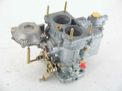

    My carburetor looks exactly like the one pictured below. Photo borrowed from google, but if necessary, I can give a real photo. By typing the phrase "34DCHD" in google graphics, just such carburetors pop up as I have. By the way, to confirm or refute what I am writing, where to find the markings on such a carburetor? How do you know which 34DCHD is?
    My mistake, it is actually 34DCHD - and I mean 34DCMP.
