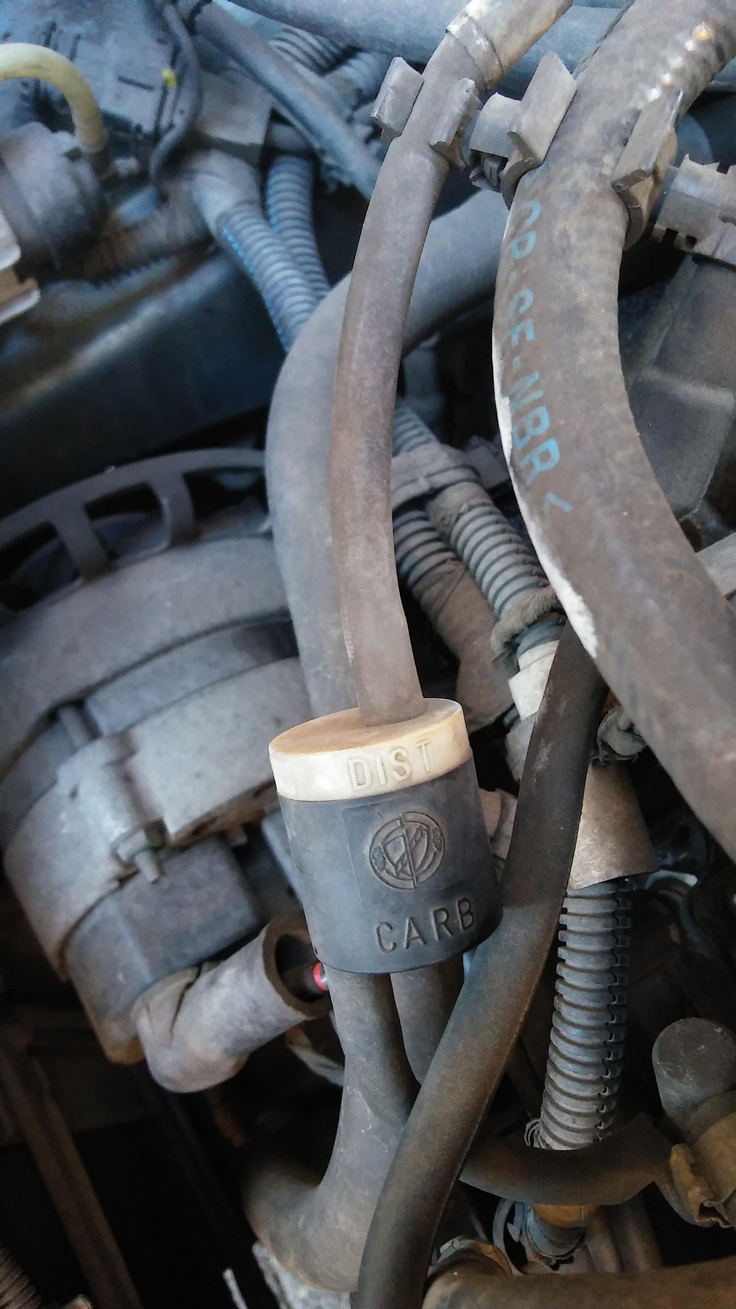

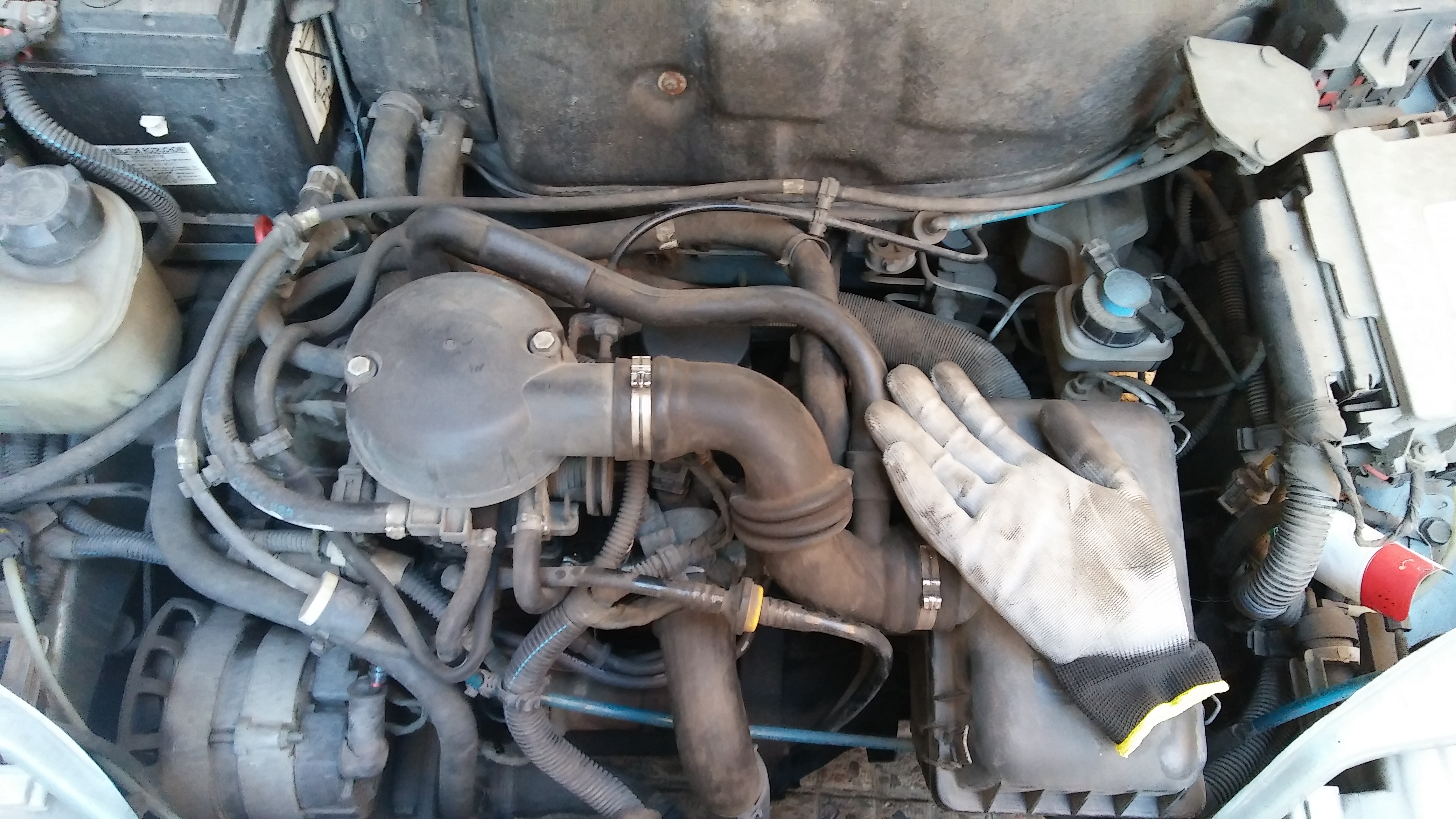

    Hello, please help, I would like to replace the cable in the car, but I do not know what it is called anywhere I can not find such information, in the moto store also did not know.
    I'm talking about the wire with a round connector, in one photo you can see the whole wire and in the expensive one only the connector.
    Greetings.

    If you mean this thin cable with a filterek with the inscription "carb" it is a vacuum sensor MAP sensor (manifold pressure sensor). Measure only the inside diameter and easily buy by the meter.

    This is not a filter but a check valve, why do you want to replace it?
    Valve and not filterek of course. :D

    Could anyone explain to me what exactly is this valve with this valve responsible for engine work? ;-)
    I like to understand everything before I do something.

    This pipe connects the absolute pressure sensor (MAP sensor) with the manifold. The control computer receives a signal from this sensor about the current vacuum in the intake manifold. This is very important information for the correct operation of the engine. If you want to go deeper, enter the search engine - map sensor.
