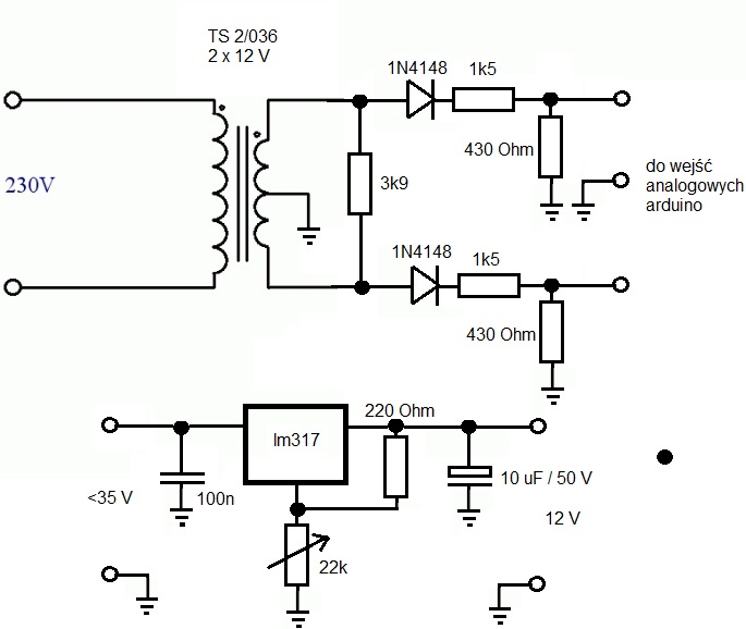

    DETECTION SYSTEM
    For the correct detection of the peaks of the respective halves of the sine wave I used a very simple system from the diagram below. It works great so far. As there is some space on the laminate, I decided to put on the board an additional 12 V stabilizer needed to power the arduino and cooling fan.
    Create a 1kW 30V On-Grid Inverter for Micro-Source Energy: DIY Construction, Efficiency & Design

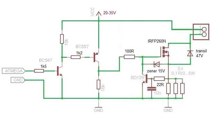

    IMPLEMENTING MODULE cont
    I built a new module according to scheme below, but there are problems that I can't solve. The module connected to the transformer itself still consumes current because the transistors are "semi-open". The module is controlled with an arduino 50 Hz rectangular waveform during testing, which means that everything would work like a simple voltage converter. There is 3.2 V on the first goal and 3.3 V on the second goal. Of course, everything gets very warm. Where to look for a problem

    Rate: 73
    Board Language: polish
    In such a system, the MOSFET gate can get 24V - that's too much.
    And for the rest of the scheme - draw it in LTSpice (it's free) and you'll see how it works.
    Rather not, there is a 15 V zener diode.
    I would suggest using MOSFET integrated drivers.
    The configuration of transistors is the simplest possible (low - side), there are plenty of ready drivers for this configuration, generally cheap as borscht. They have inputs consistent with the logic from 3 V up, there are systems with output currents at such a level that they can be freely pulled really large structures.
    greetings
    Thank you Lesio-Q. Problem solved. The module works perfectly only (I'm ashamed to admit that I did not notice) is controlled by "zero" and not "one". This is beautifully seen in the simulation at LTSpice.
    Later, testing the module with a standard 12 V light bulb and feeding "manually" to the low and high state input assured me 100%.

    The executive module controlled "LOW" does not pass the exam in my design. I returned to the old module. Unfortunately, I burned the mosfets because arduino became quite capricious when reloading the program with various inserts such as "Serial.begin" or "if". He sometimes sends him a transient signal, a peak, to the outputs and when he hits the wrong moment, mosfets are burning (IRF540, previously they were IRFZ44N and worked longer). Now I need a module in which the transistors will be protected against overvoltage and short circuit. And it must be controlled by a high state, i.e. entering "HIGH" on the input will open the selected transistor. The system is to operate at a voltage of up to 35 V and not exceed a current consumption of 20A. Searching our forum, I gathered information and put together the following diagram (half of the module):
    Can I proceed with the assembly, or do you see any oversights? Of course, there will be a fuse before all this.
    Nobody reports anything, so I get to work.
    Ready executive module;

  • #16 16270040
    krzysiek_krm
    Level 40  
    Posts: 4612
    Help: 716
    Rate: 598
    layout from last schematic may not work well.
    The mosfet will turn on quickly but shutdown will be very slow, via a 10 k? resistor. In addition, quite high supply voltage forces the use of a Zener diode, when switched on through a 47 ? gate resistor and through this diode a very high current will flow, the elements will heat up.
    As I wrote before, it makes no sense to reinvent the wheel, the easiest way is to use integrated Mosfet drivers, a very large selection, low prices, problems will disappear as you took it away.
    In order for these arduines to generate control pulses smoothly and without jams, you must unfortunately nest the control in the interrupt system.
    greetings

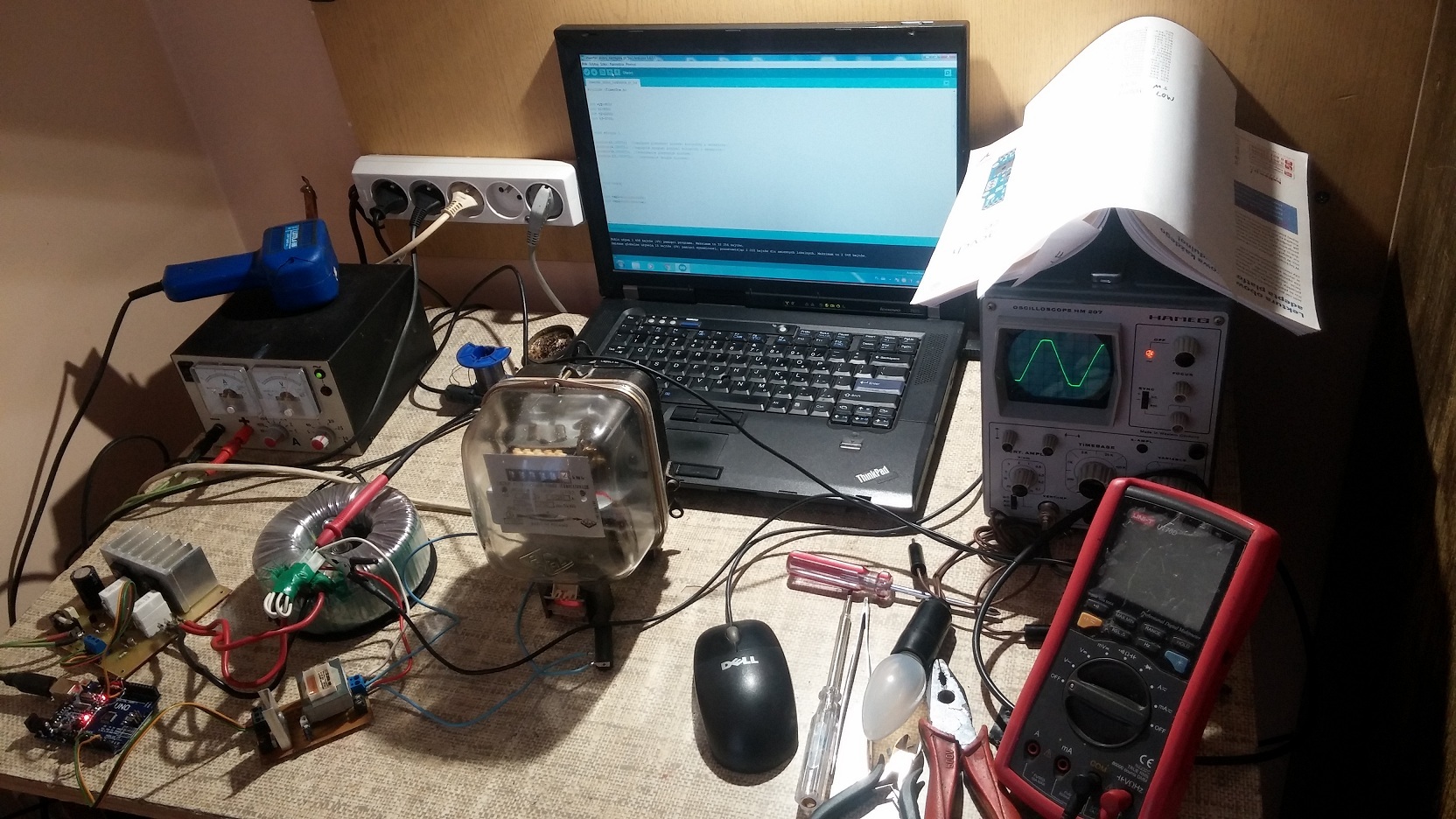

    Although today is a cloudy day, I managed to put everything together and check. First on the table:
    And then in the field with the system connected to pv panels:
    The system took 23.5V x 4.0A power from panels = 94W . The energy meter, and later also the multimeter indicated the current flow in the "direction to the network" with a value of 0.45A, which roughly corresponds to the power output 0.45A x 230V = 103,5W ! I know there are no perpetual motion devices, but I have a big problem here. I don't know how to explain it. I measured these values in different ways. Weather - uniform, cloudy. The multimeter has the "TrueRMS" function. I attach photos of the meter reading and waveform from the oscilloscope connected to the auxiliary winding of the working transformer.
    At this time, I stop working on the inverter due to incorrect energy calculations, which has unpleasant legal consequences.

  • #18 16301039
    Lesio_Q
    Level 20  
    Posts: 401
    Help: 13
    Rate: 73
    Have you reset the clamp on DCA? (after putting on and taking off)
    Can verify these 4A by direct measurement.
  • #19 16301048
    Charles Bronson
    Posts: 360
    Rate: 52
    Verified. I measured currents (from panels and to the network) with clamps and directly with a multimeter from TrueRMS. There are small fluctuations, but the power delivered always comes out greater. Maybe it's something with reactive energy?
    Added after 6 [hours] 46 [minutes]:
    Later it was 22V x 2.6A = 57.2W taken from panels and 0.39A x 230V = 89.7W put into the network, which is even more interesting. Or maybe this Landis Gyr meter cannot cope with low powers and counts energy incorrectly?
