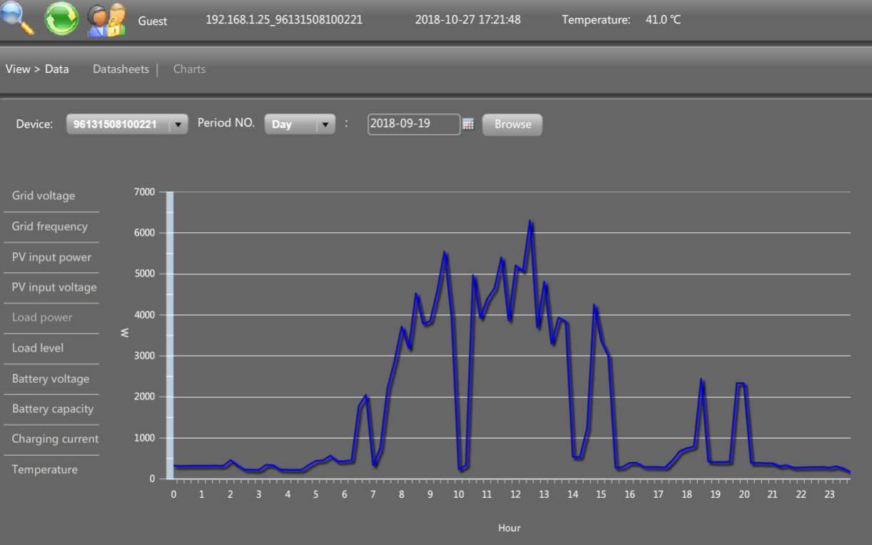

    #18 17751723
    Slak68
    Level 22  
    Posts: 635
    Help: 8
    Rate: 111
    What you see above in the chart is the whole day of laying the cube in the yard (vibrator, cube cutter etc + whole house).
    For me, for example, from 11 to 14 with a power consumed above 3 kW is a great advantage for Skymax - it did not turn off, although it has temperature protection, and then it worked for three phases at home, taking electricity from the network from one phase + PV panels + battery.
    And once I managed to turn it off, but then it was over 8 kW in peak. But if you have a workshop, it may not be enough - then the MKS are better, because they must be synchronized for three-phase current.
    Nevertheless, I am full of admiration for the knowledge, skills and self-denial in this work, I try to figure out how to become independent from BigEnergy, but the November-January period is a big challenge.
