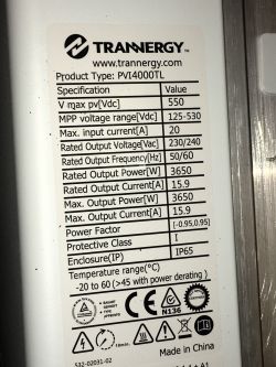

    Hello, I will briefly describe my problem. I now have a 4 kW ongrid inverter for two PV inputs with 8 panels per input, the panels are connected in series, the maximum input voltage of the inverter is 550 V. The installation is in the UK I cannot resell the current. returning electricity to the network it is possible to replace the inverter or some modernization panels must be connected in series, please give me some suggestions I thought about it https://rover.ebay.com/rover/0/0/0?mpre=https%3A%2F % 2Fwww.ebay.co.uk% 2Fulk% 2Fitm% 2F392304696461 But I don't know if it's a good idea for modernization, I can spend up to PLN 10,000. I have one more question, if I converted to this inverter from the link above or a similar Offgrid, if I want to get more power than the maximum given on the inverter, what can be done from the network, it will limit the power to the maximum, it will turn off or what, because I can not read

    And what brand does this on-grid inverter currently have? Colleague "adam12", because not only victronenergy, it offers solutions for of-grid, if it has, for example; SMA, Sunny Island 4.4M would be better
    Added after 3 [minutes]:
    If Growatta is, for example: Growatt Sp2000 with high-voltage beteria Growatt http://www.growatt.pl/dokumenty/Katalogi/Growatt%20SP.pdf

    Uuuu, you can't really go crazy with this inverter.

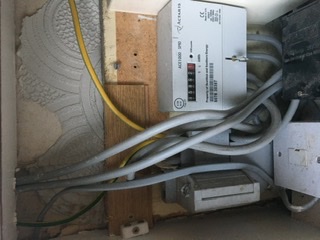

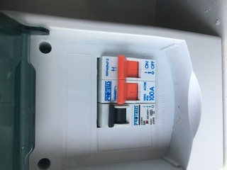

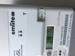

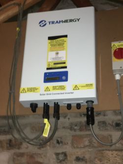

    From the photo and description, it would appear that this installation is live and working, so if we use this energy on an ongoing basis during production, there will be auto consumption and there will be some savings, and if we are not at home at that time, you can program some energy-consuming appliances such as washing machine, dishwasher.
    (here you would need photos of energy meters, switchboard so that you could recreate a diagram and confirm that this on-grid installation is connected to the switchboard behind the energy meter looking from the connection side and that the load is connected to the same phase from which the inverter is powered )
    and if it is like @ adam12 writes "Now the energy is gone. the meter does not reverse, I do not have a penalty, the energy returned is not counted because the solar meter is not read" then it will not lose anything more and maybe it will be better to leave it as it is than invest in batteries and a hybrid inverter and wait for it to pay for itself, if it does

    Converting 4kW Ongrid Inverter to Offgrid: Guidance for PV Inputs and Voltage Limits Well, as in the photo with a stick I showed two wires that go to the solar meter and to the 100A fuse which is in the heel behind the main meter, one thing makes me wonder what are the seals on the solar meter for if it is connected to the main meter, I need to explain what kaman for now therefore I will refrain from making changes (but suggestions are welcome). This year I will be installing an intelligent meter, I will see if it is moving back because, apparently, in 50% of people who have solar panels, there is this problem with turning back the meter, which according to power industry is bad and you should wait with the installation until they deal with this problem. As for the energy efficiency of the inverter, it gave 3.5kw / h when it was summer, you think that if I changed it, something would improve significantly, I know that it is not the first youth, but it was Installed about 7 years ago. As for Growatt offer, it is also not cheap on Ebay for a drug with a Lion 5kw battery, they call 1400f victron, I can have 1000f without a battery, so there is a dispute because it is not known what condition the battery is in. Converting 4kW Ongrid Inverter to Offgrid: Guidance for PV Inputs and Voltage Limits947363BB-4...AB446.jpeg (18.87 kB)You must be logged in to download this attachment.

    "Unfortunately this is not possible. An on-grid photovoltaic inverter is not a voltage source, it is a current source, which means that it cannot operate without a load. All the energy generated in the inverter must either be consumed on the fly or pushed out to the grid."
    According to the above, if I connect a 3 kW heater under each phase to the 3-phase inverter I have, Growatt 10000TL3-S, then in full sunlight - if not at full power, then at least partially - they should heat?
    The problem is that this unit displays error 124 (no mains) and does not start.
    My question to the experts.
    How do I simulate the grid or how do I configure it to only start up on DC power with no grid?
The discussion addresses converting a 4 kW on-grid inverter with two PV inputs (8 panels each, series connected, max input voltage 550 V) installed in the UK, into an off-grid or hybrid system. The user cannot export electricity to the grid due to regulatory and contractual constraints and seeks advice on inverter replacement or modernization within a budget of PLN 10,000. Various solutions are considered, including hybrid inverters with battery storage, solar chargers with MPPT input up to 550 V, and off-grid inverters with power limiting features. Challenges include legal restrictions on modifying panel connections, lack of space for thermal storage (boiler), and high battery costs. The discussion highlights the difference between off-grid (fully disconnected) and grid-tied systems, emphasizing that on-grid inverters require grid presence to operate and cannot function as voltage sources independently. Hybrid inverters like Victron EcoMulti and Skymax are recommended for their battery charging priority and grid synchronization capabilities. The Victron EcoMulti system supports off-grid operation with or without batteries and dynamic power limitation via grid frequency control. The user also explores options for integrating existing lithium-ion batteries from other devices. Concerns about inverter current limits (e.g., 3 kW max current 17 A) and behavior when load exceeds inverter capacity are raised, with explanations that off-grid inverters may shut down if overloaded. The discussion also covers UK-specific metering issues where solar energy fed into the grid is not compensated, leading to financial losses. Suggestions include hybrid inverter replacement, partial off-grid setups, and energy consumption management to maximize self-use. The user shares photos of the current inverter and installation, noting its age (~7 years) and modest efficiency (~3.5 kW/h in summer). Alternative products from Chinese manufacturers and local sellers are mentioned but often lack documentation or have uncertain quality. Overall, the consensus is that converting an on-grid inverter to off-grid is complex, often requiring hybrid inverters with batteries, and legal and technical constraints must be carefully considered.
