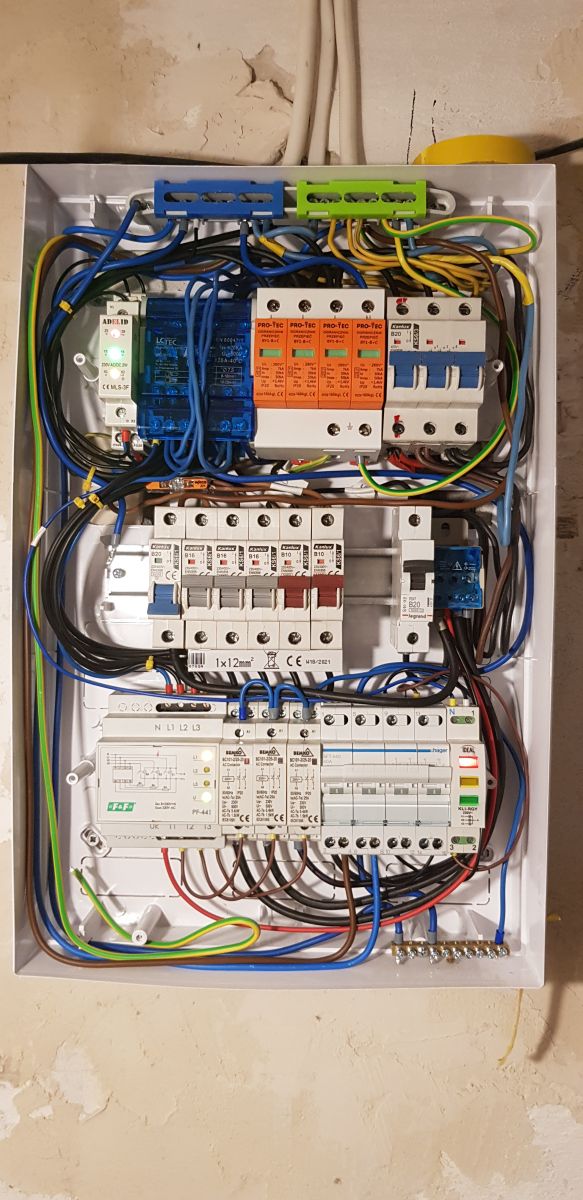

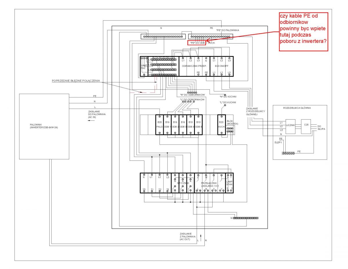

    The topic basically concerns a situation where the hybrid inverter is too weak to transfer the load of the entire house. In my case, the kitchen can draw 4 kW instantly and the AZO Digital ESB-6kW-24V inverter, according to the product card and looking at the contacts, will hardly transfer 3 kW? Therefore, I developed a connection scheme so as to use the energy in the off-grid system, but not to overload the inverter. As for the scheme, the installation is of the TN-C type, so I also have to "convert it" from the meter to TN-CS. Maybe someone will find it useful, or maybe someone will notice a mistake somewhere and we will fix it so that it will be useful to me and others. I also have a dilemma whether to connect the earth electrode through the inverter with the existing network (the dotted line with the description should be connected). Regards
    How to connect the OFF-GRID 1-F inverter in a 3-P installation with a circuit by
    • INST SOLAR OFFGRID.pdf (67.38 KB) You must be logged in to download this attachment.
  • Check whether inverter output neutral bonds to PE

    rademenes787 wrote:
    I also have a dilemma whether to connect the earth electrode through the inverter with the existing network (place with a dashed line with the description CONNECT)
    If the PE terminal is described, then yes. At the output of the inverter, are you sure there is only L and N without PE? If so, there will be some kind of IT arrangement, unless in the middle PE and N connect?
    I want to do something similar at home only on the Growatt inverter, once that 5kW of continuous power has more options, including the choice of charging hours from the battery network. And whether output N is connected to PE is configured in parameters. Maybe yours is like that too?
  • Grounding screw present despite only L and N output

    Kosmos99 There is only L and N at the output of the inverter, but there is a grounding screw on the housing. I don't know what's inside, because I didn't disassemble the inverter, I guess rather yes. I don't know its capabilities too much, because I haven't turned it on yet, and the instructions are so-so. I am before the construction / reconstruction of the electrical installation. Today I did the mountaineering and just fitted the rails. Maybe in the future I will change to Growatt, if I am satisfied with the overall performance of the system. I'm a bit worried about the direction of the roof to the sun, because there is no shadow at all, but the south-west 45 degrees vertically gives me only sun from 11am to evening...

    I do not know how you connected this ESB to the current circuit, I also had OffGrid with the same inverter at one time, connected to a separate circuit and there were no "circuses".
    I had the connection to the inverter directly from the main switchgear from the bus where the output from the meter was connected, in your case one of the phases, of course through an additional small switchboard with protections.
    In the main switchboard, I separated the circuit that is to be powered by the PV installation, i.e. I disconnected its power from the main switchboard, the separated circuit was connected to the return cable from the inverter and everything worked as it should.
    This was my philosophy with a separate circuit, such separate circuits can be two or even more, then each can be protected with an overcurrent protection in a small switchgear I wrote about.
    It's strange to me that something is wrong with you ;) .

    that's how I more or less connected ... in tracking the babola I have already detected one (the only one?). I connected the "N" wire of the phase switch from the N bus of the inverter instead of the mains. I'm still looking to see if I missed something. So far, the phase switch for PLN 300 has gone up in smoke, unless I can fix it (Apparently the PN274PN system, a few varistors and probably something else was on fire)

    And since only N and L come out of the inverter, what did you do with the PE protective cable from the devices? In my case, it is fastened in the box with the N strip as I converted the TN-C system I have to TNC-S in this way. Now I'm wondering if this fact, i.e. I receive L and N from the inverter and at the same time PE bridged with the N network, does not affect the system?
    • dom-whatever letter (3).pdf (66.14 KB) You must be logged in to download this attachment.

    For me, as the old cottage is an installation of only L and N, the pins in the sockets are connected to N, I made a pin earthing for the PE inverter.

    rokbok wrote:
    for the PE of the inverter, I made a pin earthing
    Why so?
  • #21 19678980
    rokbok
    Level 40  
    Posts: 4399
    Help: 652
    Rate: 1035
    kosmos99 wrote:
    Why so?
    Expand the question/thought.
  • #22 19678985
    kosmos99
    Posts: 4188
    Help: 338
    Rate: 820
    Why does the inverter housing have a separate earth ground not connected to PEN?
    At least that's how I understood it.
  • #23 19678998
    rokbok
    Level 40  
    Posts: 4399
    Help: 652
    Rate: 1035
    rokbok wrote:
    For me, as the cottage is old, it is only an L and N installation
    So that the inverter, currently On Grid, does not report a grounding error, he got his own individual / personal, this is a distinction for him :) .
    the housing is like a housing, but the electronics inside also has a PE contact, so what should I connect a separate ground to it, and take L and N from the mains?
    The fact that I specially made an earth wire for the inverter is only because my installation in the building is only phase and neutral, no ground wire, old shack, the regulations were completely different in those days, so to connect the inverter to PE I had to do it.
    In your case, there is no such need, you have an earth electrode in your installation, so you connect to it.

    rokbok wrote:
    Not quite so ... I have a TN-C installation, so the neutral in the box was made on PEN so that it was TN-CS ... so probably like you

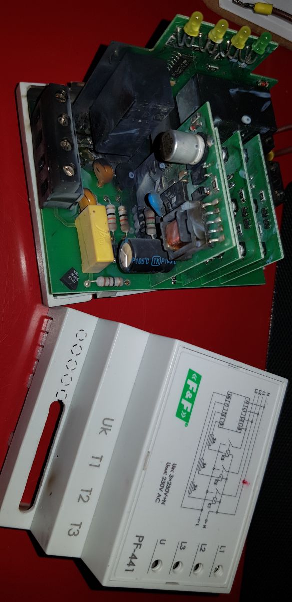

    I fired without the phase switch, with small corrections and so far it works ... I don't know 100 yet if this correction is everything or something else. A little afraid to install a new phase switch ... However, however, the system seems to work. However, I have not deciphered the inverter yet and I have not connected the OW batteries and the new grounding from the panels ...

    Your phase switch probably burned out because it did not have a N-ki, the inverter turns on the output after a while, and I cannot turn it on after the switch switched the phase every now and then. If N is from before the inverter, it will be ok.

    Sounds reasonable, tomorrow I'm connecting a new phase switch ... it will cry if this one burns out too ...
