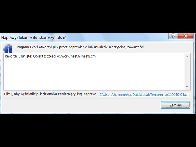

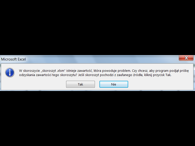

    EXCEL begins to annoy me, namely every time I open the Workbook a message pops up "
    "There is content in the new workbook that causes the problem, Do you want the program to attempt to recover the contents of this workbook?"
    after clicking yes
    another message pops up
    "Document repairs"

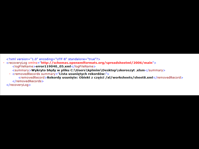

    The excel program opened the file by repairing ....
    despite the fact that it will save after recovery or repair an error occurs
    and after clicking on the repair history nothing specific
    see attachments

    Buddy, yes, from a trusted source, the macros are created by me, unless the error relates to a macro that retrieves storage values from the program, it goes through the SYMTRAX add-on
    I was able to solve the problem !!
    namely, DEFINED CELL NAMES were responsible for the formation of errors !! referring to other sheets, including the sheet in which the SYMTRAX table was updated
