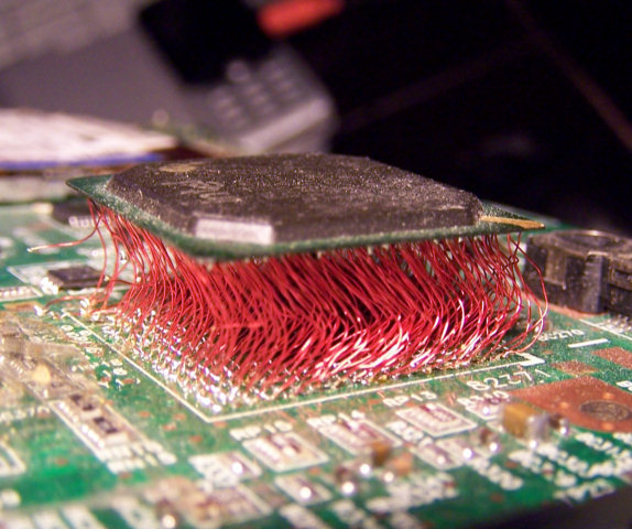

    SoC (processor + chipset + ... = all in one 1168pin BGA housing
    system on chip (SoC)
    See page 2 Link
    ________________
    Someone succeeded with a smaller il. pin

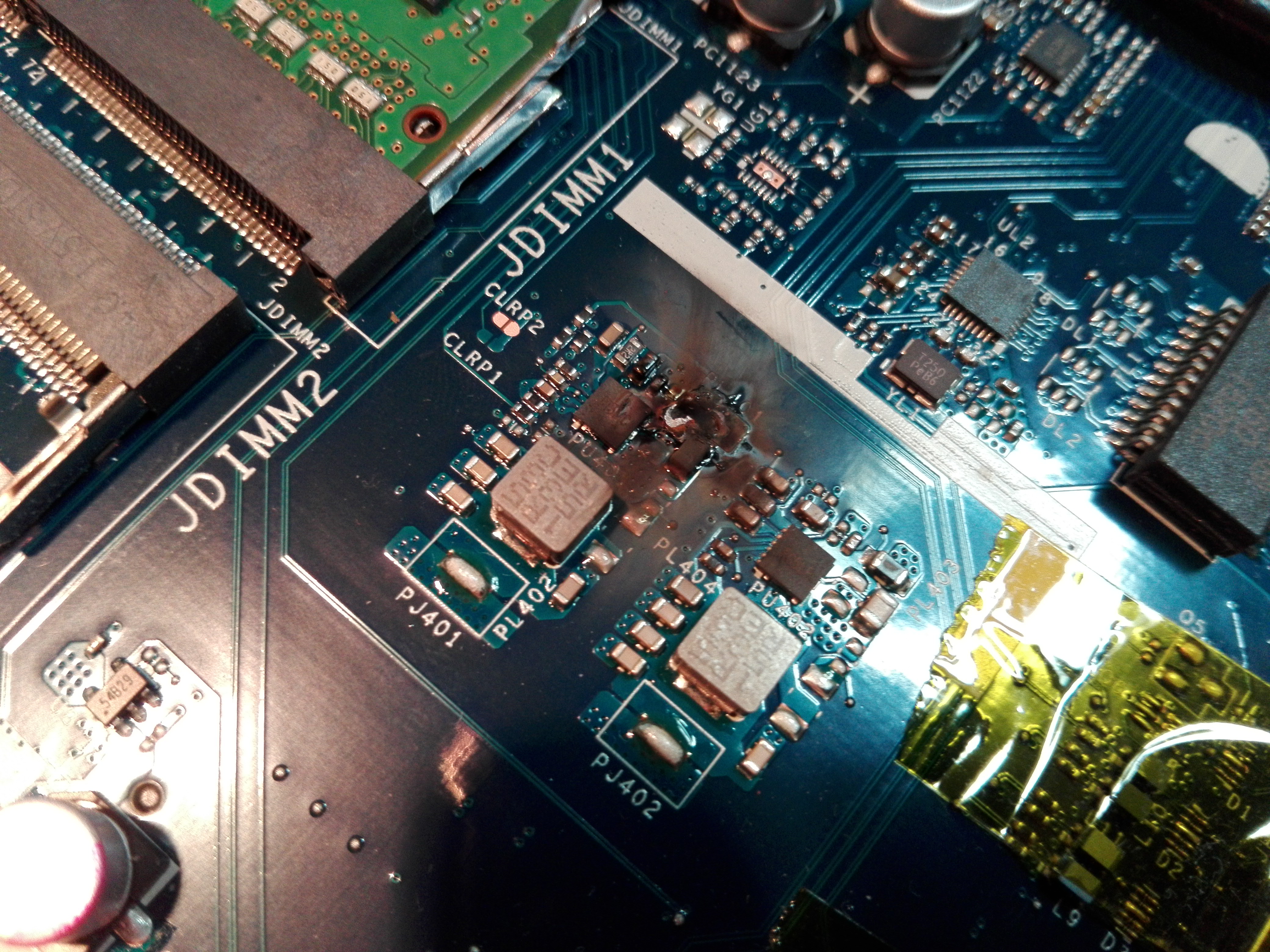

    This is what the burnout looks like, definitely irreparable?
    Lenovo B50-80 80EW05Q0PB (i5 5200) Motherboard Replacement: Compatibility with B50-70 LA-B092P (i3)
  • #17 16211977
    miecho18
    IT specialist
    Posts: 18700
    Help: 3087
    Rate: 2777
    It is impossible to judge from such a poor photo. First of all, first you need to clean the laminate from burns.

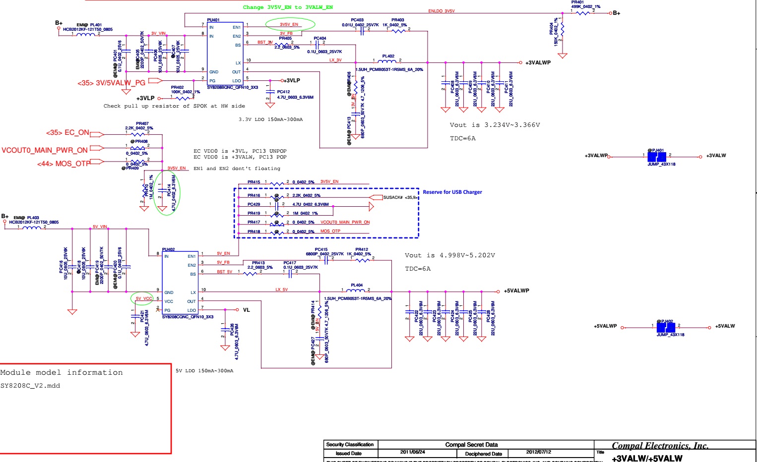

    You have damage in circuits from tensions approx
    PU401 SY8208BQNC + 3.3VALWP
    PU402 SY8208CQNC + 5VALWP
    From the picture, you can barely see how deep into the plate the burnout - hole. (as you provide), clean and take a photo.
    Lift the glands and measure the resistance after them

    Because nothing appears from the picture so far.
    Maybe only the circuits went "into oblivion with a lot of smoke"?
    If the PU402 is damaged and a (in fact) burned hole, look for new albums!
    ____________
    From the photo. you can see that PU401 made "more smoke and bang".
    Desolder it and measure resistance on strap_ pin.5 LDO or + 3VLP , there will be clarity on cost effectiveness and repair.
