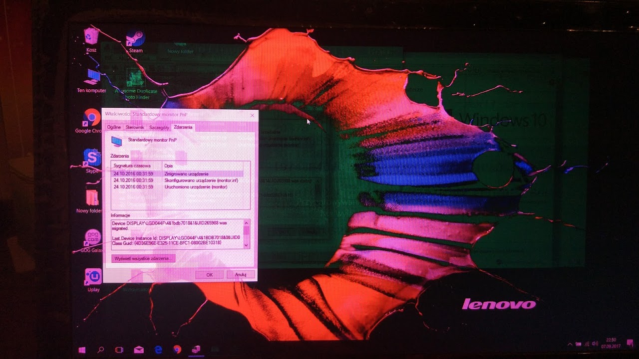

    Hello all,
    Today I turned on my Lenovo y50-70 laptop and the screen went pink on it and you can see the images that were previously displayed on the screen
    This also happens in the BIOS and on the boot string "Lenovo". I suspect it may be a damaged matrix, because the image is normal on the connected monitor via HDMI.
    Where can I find a compatible matrix with this model and what is the best choice?

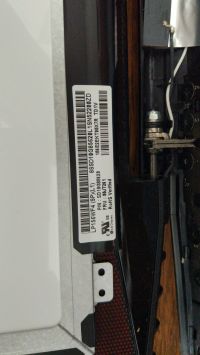

    Refrain from replacing the matrix itself. You have the symbol on the back on the sticker when you remove the screen.
    First, replace the matrix wire.

    Start with the wire.
    The possibility is also that the BGA chip is already fixing.

    I replaced the matrix with a new one (AU Optronics B156HAN01.2) and after the problem.
    Thanks for the answers

    also matte IPS. And as for the specific model, I do not know if it is some trash or not ... to be honest, I did not think about it, I just took what was in Krk right away to see if it was really just a matrix. I paid 240 zlotys for it. Choosing the Right Matrix for Lenovo y50-70: LG LP156WF4 (SP) (L1) vs AU Optronics B156HAN01.2IMG_201712...172013.jpg (3.25 MB)You must be logged in to download this attachment.
