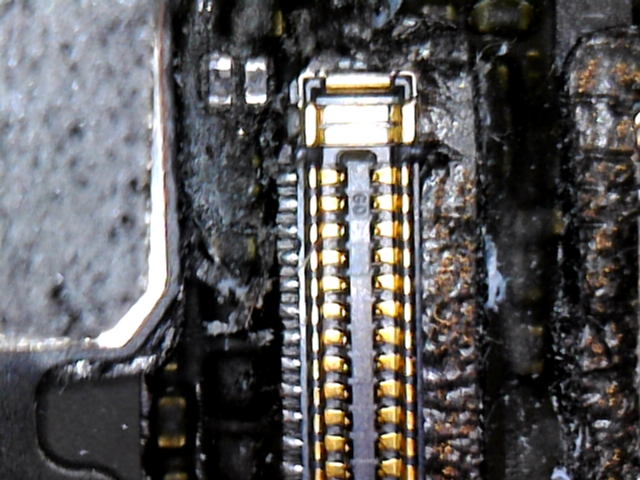

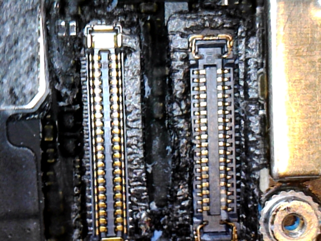

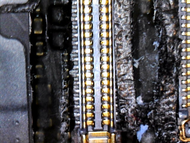

    Hello, when replacing the display on the iPhone 6s I damaged the backlight. On the phone you can see the image only under the flashlight and it's only when I look closely. I would like to diagnose what might have been damaged, but I don't even know where to start. I upload pictures of connectors and ask for help

    Why do you find that you damaged the "connectors" on the disc? In my opinion, you damaged the backlight ribbon coming out of the display. Look at her.

    onlynojoke
    Posts: 6
    I suspect that somewhere there could be a short circuit .. I have changed screens several times and I would rather exclude the display, at least at first glance nothing can be seen

  • #5 16204517
    onlynojoke
    Posts: 6
    I will add that after switching on the phone for the first time, it worked normally for about 30 seconds before it went off ... several times
    Added after 30 [minutes]:
    It seems that the upper filter is damaged .. FL4211 2400HM-350MA 0201, can anyone tell where I can buy it?

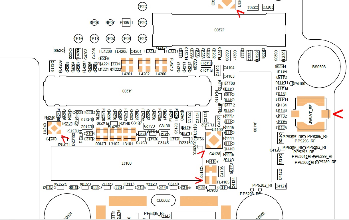

    In 6s in the event of content on the screen, and the lack of backlight very often the LCD converter (PMU Display) is to blame Of course, if there was no mechanical damage to the chokes in the anode / cathode lines ;)

    Clarifying backlight anode/cathode lines and testpoints

    tojaert wrote:
    Rafal-PMU Display is on the other side of the board, at a depth of about the end of the processor. How would he damage it without removing the disc or flooding?
    I don't know how and why it's raining but he dies and I mentioned it more than once :)
    I think that licking the LCD panel can do a lot with it.
    As for my "anode / cathode" you are right, I meant it.
