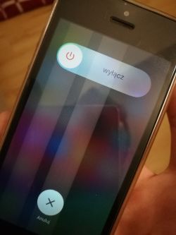

    I have a problem with my iPhone, namely it fell to the ground and now when I turn it on, colorful stripes appear on the left on a white background with the apple logo and the screen turns black and only one pink strip is visible from the left. Does anyone know what this could be? I would change the display but I don't know if it's really him and I don't want to waste money unnecessarily.
    Here is the link to the movie how it looks: https://www.youtube.com/watch?v=7Q6GLWIl4bM

    Looks like the display is broken. To be sure, you can disassemble it and re-attach the display tapes as it will not help and the signs will continue to be the same for replacement.

    Now I have tried to reproduce it and some error popped up (2003)
    But I order a good display; P

    Replace the LCD, in case you always have 2 weeks to return it.

    You probably have a broken display since re-attaching doesn't make any difference.

    I had the same problem and it's a shame.
    Replacing the new LCD screen saved me a lot of time etc. :)
