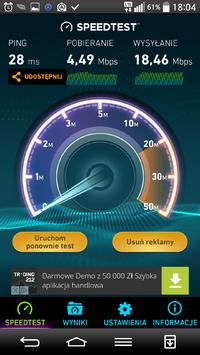

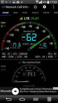

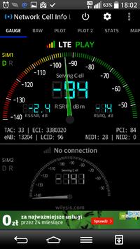

    Okay, I'm after initial inspection. The case is as follows.
    The transmitter closest to me, i.e. at Maria Skłodowska Street, is located on a 10-story block. I stood about 150m away from him standing on the hill, no obstacles.
    Improving Download Speed on Huawei B593s-22v Router (PLAY) in Zielona Góra: Antenna Recommendations? Improving Download Speed on Huawei B593s-22v Router (PLAY) in Zielona Góra: Antenna Recommendations?
    Transmitter on Wyspiańskiego St., placed on a low building. I stood less than 100m from him, no obstacles.
    The transmitter on Gorzowska, placed on a high pole. I stood about 200m from him, no obstacles.
    Inside the house, the spid test showed about 3Mbps! (I don't have a screen)

    Home connection with LTE1800 Play BTS at Maria S-Curie but with a second sector (20 at the end of ECI). Under BTS with the third (30 at the end of ECI). The one with you (20) is massively overloaded, low DL high UL. You will not connect to the 30 which works as OK. The best result on Wyspiański on the third sector, BTS as normal. On Gorzowska, the connection with LTE2100 and assumption of speed lower by half than on LTE1800. To sum up, you can force connection from Wyspiański on the Dual LTE1800MHz antenna with a narrow angle of radiation. It is worth checking out BTSs of Energetyków 7 and Heroes W.24 and even Dabrowski 41 and Batory 126. Then you will have a complete picture of LTE Play in your area. Always stand in the direction of your home (this is your sector). a little bit of westernity but it is so with mobile, the number of users is not the same and on BTSs and even on sectors there is different load and speed on them. The directional antenna allows you to improve the signal parameters and if the BTSs are in different directions force the connection with the one that gives the best speed. Because BTSs are relatively close together, they must have a narrow radiation angle and be set to BTS. Inventions like these cannon-pipes are not suitable for this. They are spooky birds and dubious home decoration, not an LTE antenna with angular polarization.
