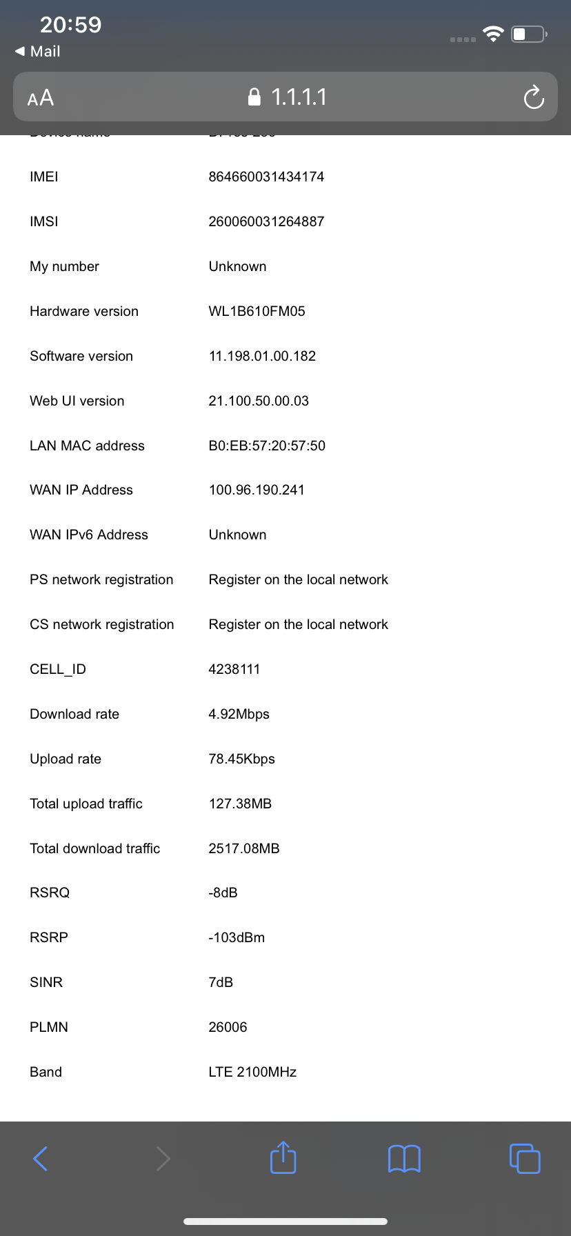

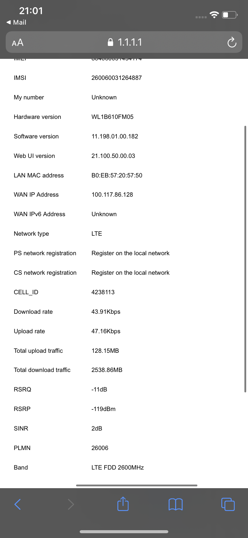

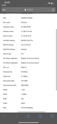

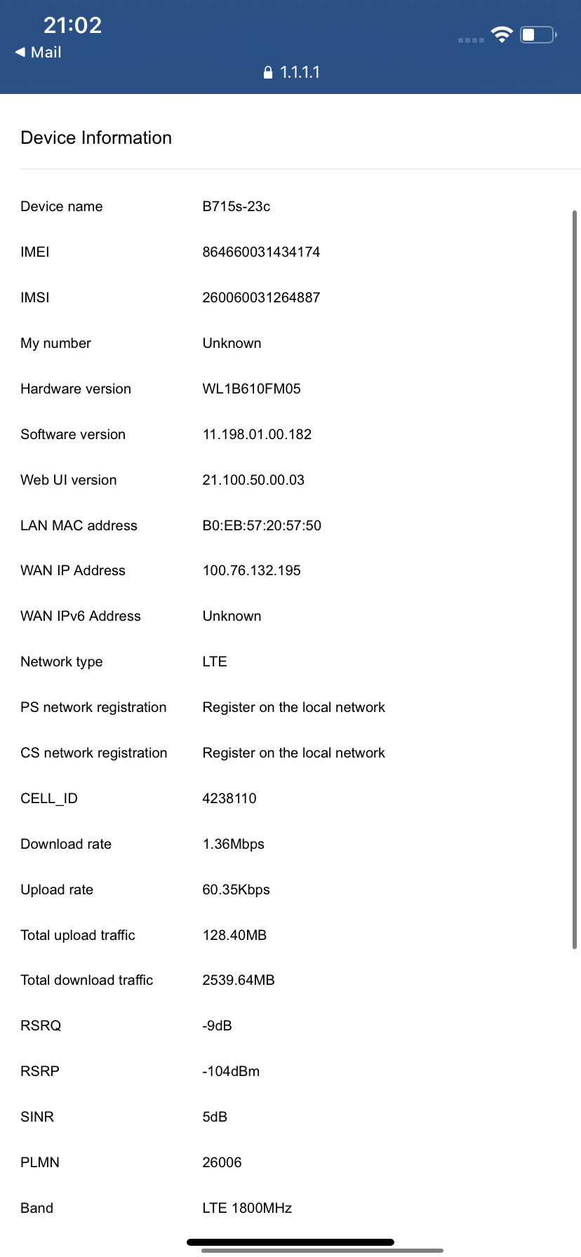

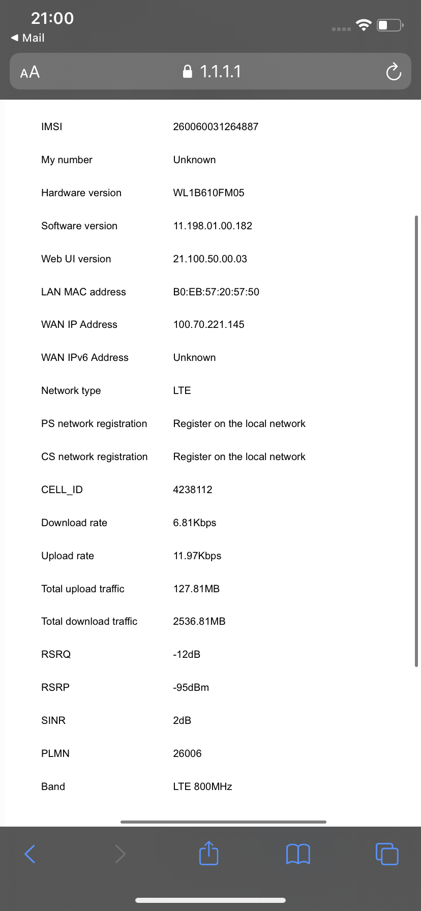

    Hi,
    I am looking for the strongest LTE antenna on the market that will significantly improve performance in my location. Below are the current data:
    Location: Bądy 14-400
    Operator: Play (selected after testing all operators)
    Router: Huawei B715
    Antenna: 2x ATK 504
    Transfers: 25-40 Mbps (7:00 - 17:00) 2-10 Mbps (17:00 - 23:00)
    Bands available:
    800 MHz (5 bars), 1800 MHz (4 bars), 2100 MHz (4 bars), 2600 MHz (1 bar).
    BTS: Pasłęk - the best in the area, 8 km
    Here are the exact details:
    Strongest LTE Antenna for Huawei B715 Router in Bądy 14-400: Play Operator, 800-2600 MHz Bands Strongest LTE Antenna for Huawei B715 Router in Bądy 14-400: Play Operator, 800-2600 MHz Bands Strongest LTE Antenna for Huawei B715 Router in Bądy 14-400: Play Operator, 800-2600 MHz Bands Strongest LTE Antenna for Huawei B715 Router in Bądy 14-400: Play Operator, 800-2600 MHz Bands
    Thank you very much in advance for your help!
