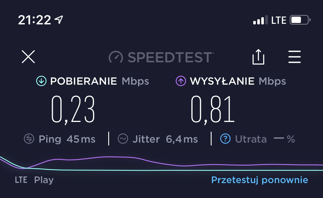

    After moving, I have a big problem with mobile internet from PLAY.
    I reported to the operator but he did not help.
    Download at the level of 0.2 Mb/s (!)
    In general, using the Internet is incredibly tedious, if possible at all.

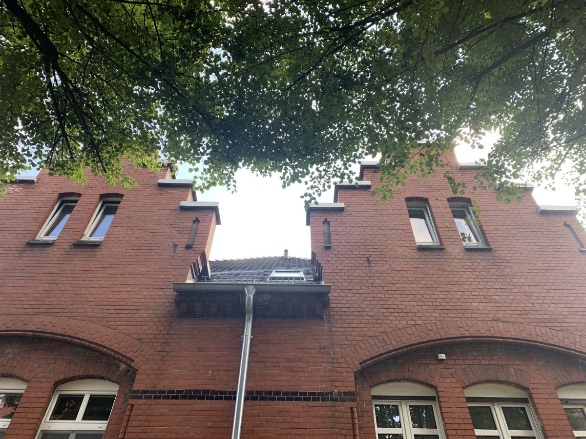

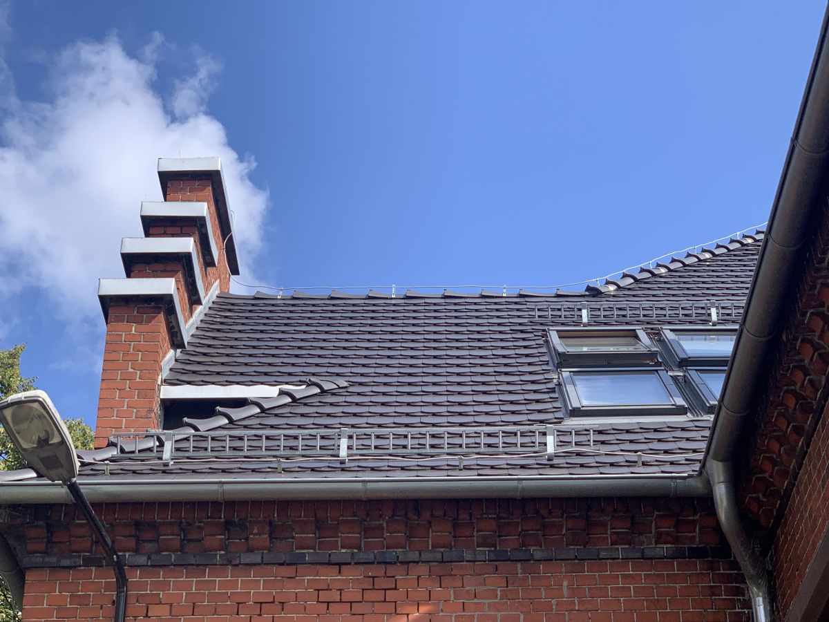

    I will add that I live in the attic and I have neighbors around.
    The roof is constructed as shown in the attached photo.
    What to do?
    Improving Internet Speed on Huawei E5573s-320 Router at Wolności 22E, 49-300 Brzeg, PLAY Network
    Improving Internet Speed on Huawei E5573s-320 Router at Wolności 22E, 49-300 Brzeg, PLAY Network Improving Internet Speed on Huawei E5573s-320 Router at Wolności 22E, 49-300 Brzeg, PLAY Network

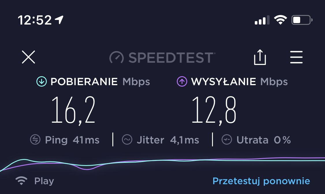

    Added after 1 [hour] 12 [minutes]:
    Another test:
    I put the router outside the window on the roof.
    Result below.
